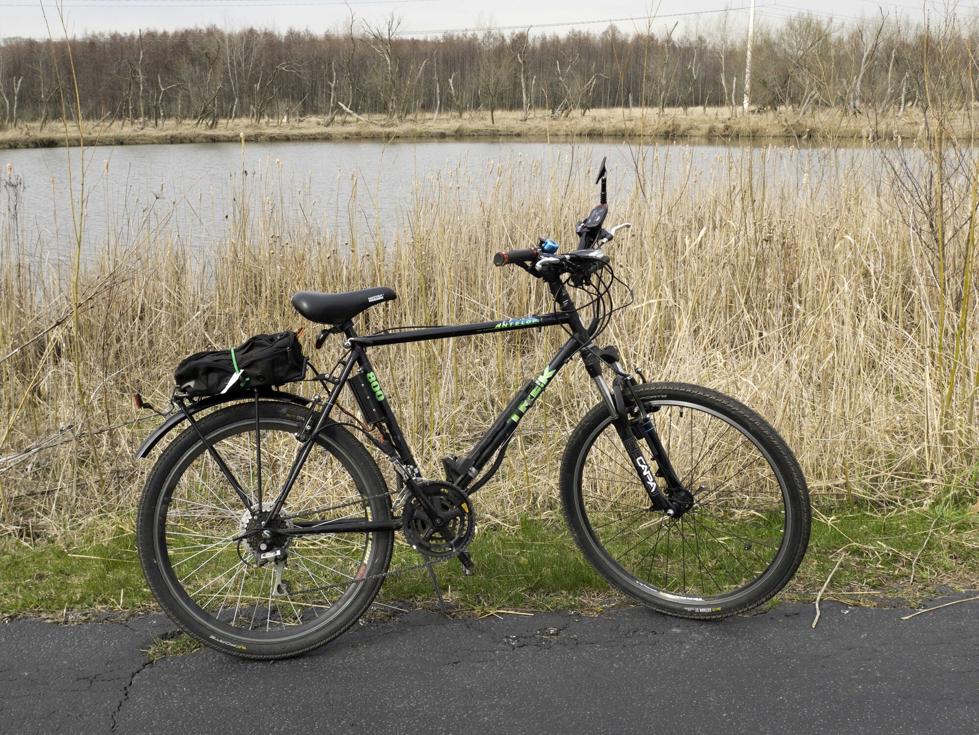

Hi, Sorry if this has been asked before, but I didn't see anything exactly matching my scenario. I'm looking to just get a little oomph to my pedaling, not looking to be riding with just a throttle and no pedaling. I'm ok with custimizing a bit, but would want to order most of the kit together from a trusted company.
My project bike I'm looking to convert is a REI Coop CTY, kinda like this one:

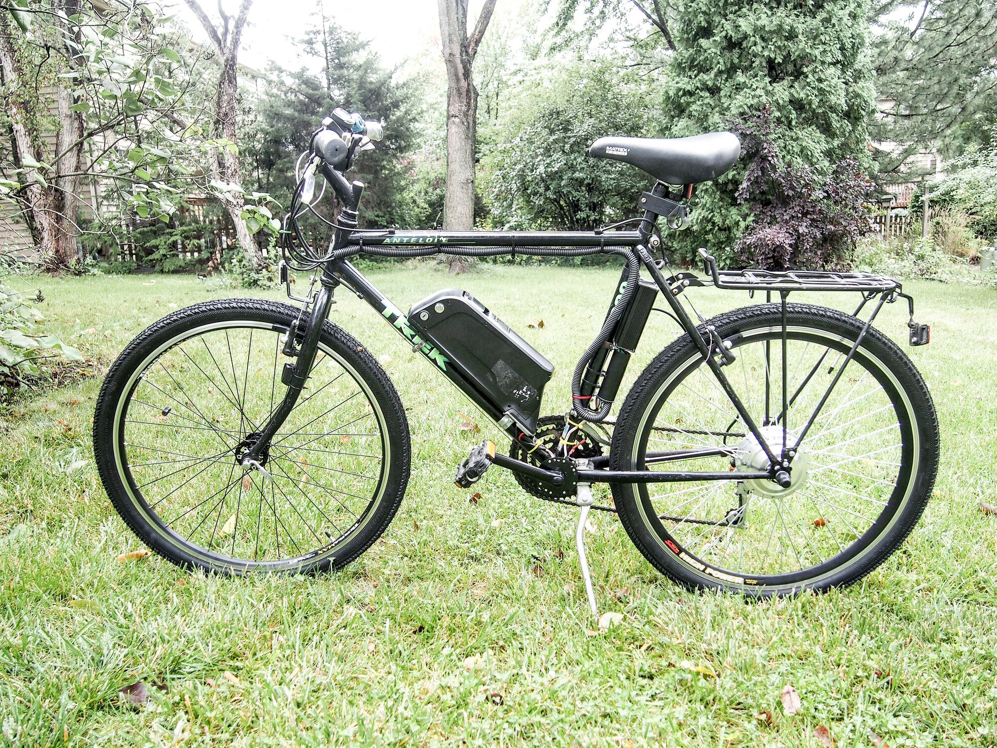

My first bike conversion was ebikeling, back in 2015, Rear wheel, 500W, and I supplied my own battery. The kit was around $240. The battery was the same price, from a chinese seller on ebay.
I've bought a couple of other ebikeling kits since then, with no complaints, except that I didn't like his LCD upgrade in the last kit I bought in 2018, Crappy LCD that was designed for a direct drive motor, not a geared one. It would not show speed when coasting and the assist was too powerful. I used a better controller/LCD. Well, it's 2023 now, so surely he has fixed that.
Probably the same or similar motor, Now 500W on 36V is going to top out around 20 mph, Whether it feels too strong will depend on the granularity of the pedal assist. Cannot help you with the 2023 kit, but the 2018 kit with the SW900 was terrible, He is a big amazon seller, and you can ask a question there.
Meanwhile, the above conversion has never come off my bike, I haven't even had a flat tire that would require removing the wheel. I've converted other bikes since then, but I still grab some seat time on that bike. My average speed on a bike ride is 12 mph. To my surprise, the 36V battery is still working well too. Seven years, Amazing. I've got other packs that didn't last seven weeks.

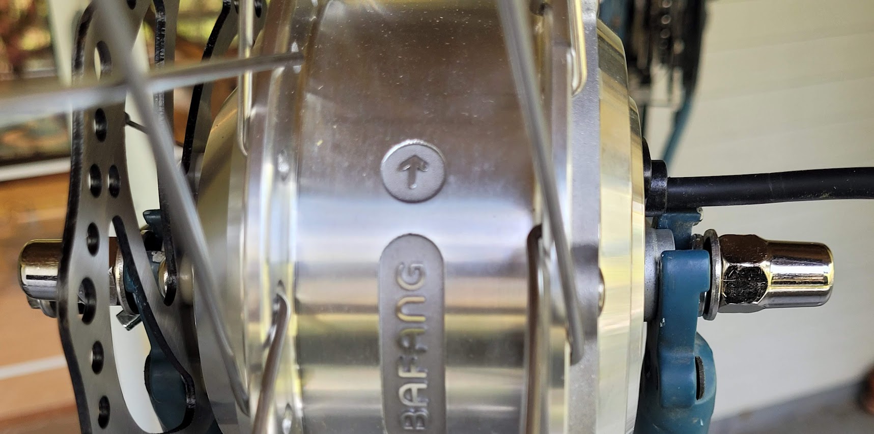

I'd thought I'd give an update: I ended up going with the Leeds Kit. Overall, It seems a pretty good fit for my needs. It is pretty light on my bike with the 250W motor and 10.4Ahr 24V battery. I can almost forget the kit is on my bike when pedaling unpowered. And it's doable to get it up and down some stairs. Also, I don't seem to mind the on/off button throttle like I thought.
The one issue is, I didn't realize the axle only has flat faces close to the hub, just wide enough to fit the included tabbed washers (it's not super clear in the pic with it assembled on the bike). The rest of the axle resting through the dropouts is round, so the torque arms I got won't fit. This seems very similar to the setup with the Grin Tech G311 kit (https://ebikes.ca/product-info/grin-kits/bafang-g310-g311.html#WasherStackandTorqueArm).
Since the dimensions look right, I wonder if I can use Grin Tech's torque G11 torque arm meant to replace it's tabbed washer and sit inside the fork? (https://ebikes.ca/shop/electric-bicycle-parts/torque-arms/torqarm-311.html). I'll make some measurements soon and see if I can order that.
As long as there’s a fender mount eyelet on the fork the grin front fork torque arms are perfect. riding with just tabbed washers is not safe. Grin now sells them on Amazon. far less expensive shipping. there should be nothing to measure.
interesting. I’m using 2 https://ebikes.ca/shop/electric-bicycle-parts/torque-arms/torqarm-v2.html
I’m a bit confused by the difference unless the 311 has an odd axel configuration/size
hmmmmm…
Yeah, maybe it's not super clear because I was too lazy to include a photo of the motor axle off the bike forks. It looks very similar to the photo in this section: https://ebikes.ca/product-info/grin-kits/bafang-g310-g311.html#WasherStackandTorqueArm
It looks like the 311 hub motor axle is round 10mm for most of it's length, except for very close to the hub, where it's flattened long enough to fit either the keyed/tabbed washer in the 311 kit, or the 311 torque arm. The only way a torque arm would fit is on the inside of the fork. The kit I got from Leeds is very similar. The question I have is if the 311 torque arm can replace the keyed washer in my kit. It looks like in both case to fit a 14mm flattened section of the axle, but I want to be sure before buying. I sent a message to Grin Tech to ask.
