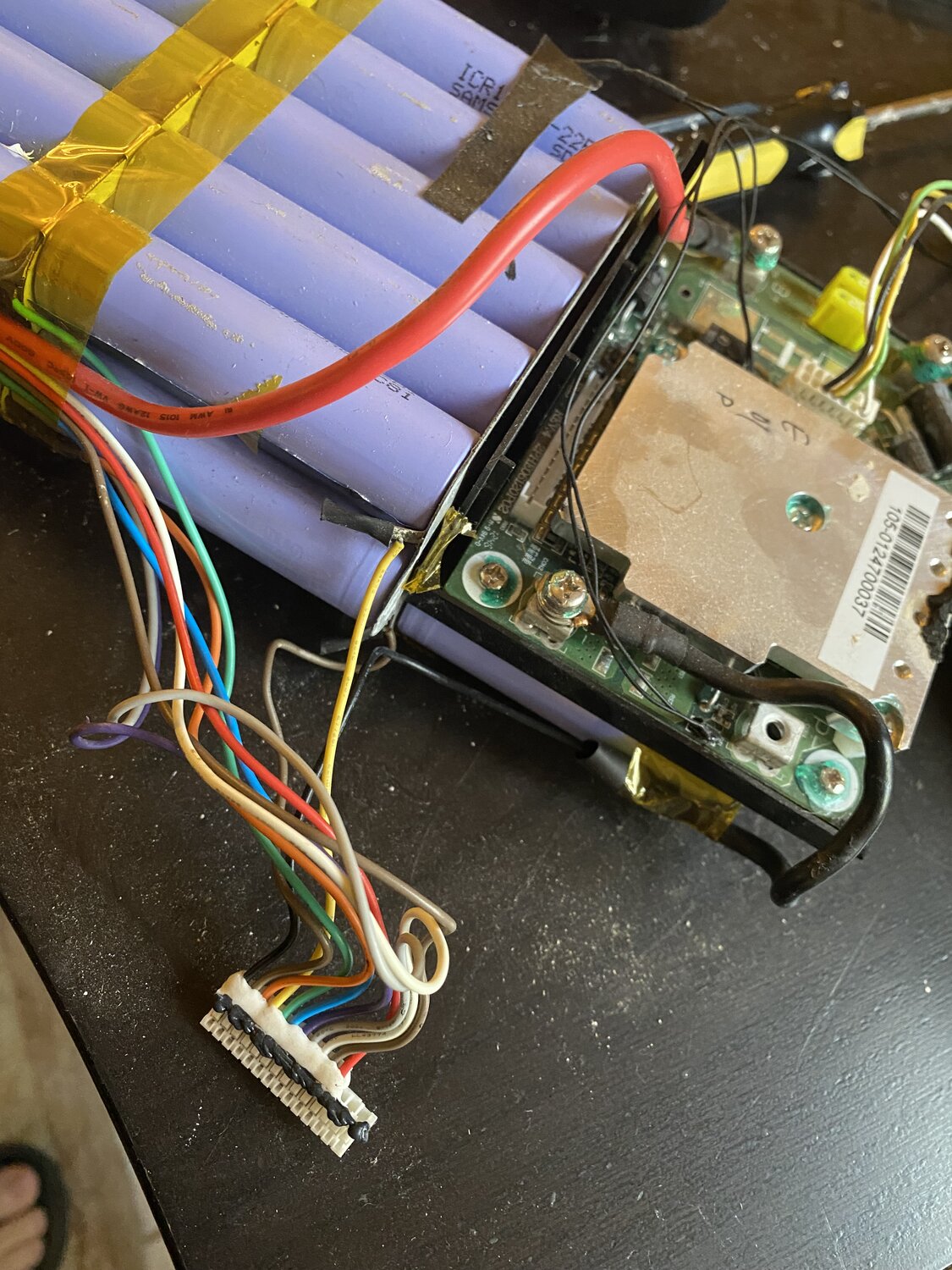

The voltage on the batteries(black/red wires) without the BMS is ~40V. But there is no voltage through the BMS. Can you bypass the BMS and run straight voltage?
You can, though I’d advise only temporarily just to test the rest of the Bikes’s functions since the cells would be unprotected.
One last thing. There should be a connector with ~11 wires at the BMS. Can you (very carefully) check the voltage between each adjacent pin? What I mean is pin 1 to pin 2, pin 2 to pin 3, etc. This is the balancing connector that provides the BMS with each cell string’s voltage. All these voltages should be very close to each other, and at 40 volts for the pack, should all be near 4 volts.
What I want to see with this test, is the BMS board actually defective, or is the pack out of balance and therefore won’t allow the bike to turn on. Both are good possibilities.
I finally got around to getting back to seeing if I can fix this eBike.
The total voltage from the battery is 32 volts.
voltage breakdown between pins:
1-2(black/brown)=3.1V
3-4(orange/yellow)=3.2V
5-6(green/blue)=3.2V
7-8(purple/gray)=3.2V
9-10(white/light brown)=3.2V
10-11(lightbrown/red)=3.2V
Thanks for your help,
Scott
