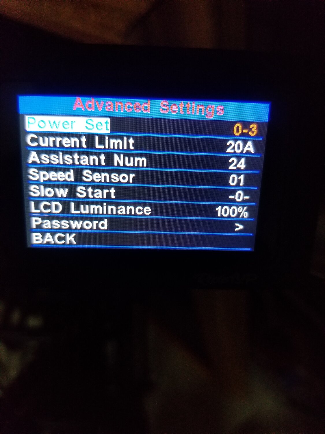

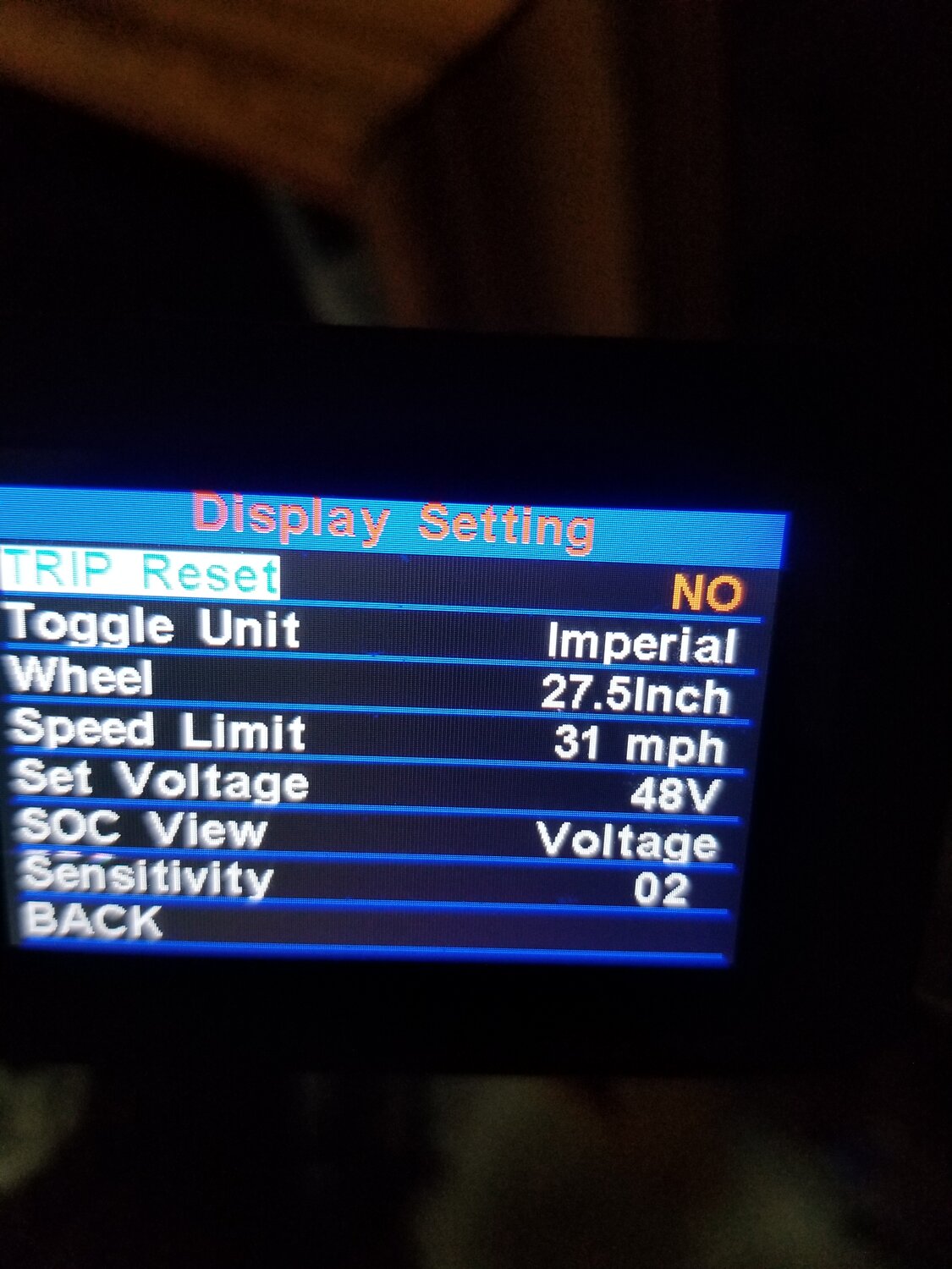

An inexpensive twistgrip throttle provides a jolt of around 900watts, and TS (1 - 3 settings) work perfectly.
Now over 4000miles - I've tried various settings.
The stock "reset" > change controller to 20amps > w/ 0, 1, 2, 3 PAS at 02 sensitivity works great.
Never once have I had an overheat cut-out (excepting errata attributed to 'crushed wire syndrome'. See below).
Controller, roughly 20A = 960W @48v; 1040W @52.
For first 5 miles of charge, I show +53Volt - possible 1160Watt Peak jolt - motor acts slightly erratic, BIG POWER. I think it's a bit too much Voltage.
Next 10 miles, bike flies; smooth; 'cackling' a different tune.
The following 5 - 10 miles (always more than 40% charge left for me), bike now in 48V mode there is power loss. Now the bike acts like a normal 500Watt machine and has 50 - 60Nm torque.
'20A' setting allows full potential when you call on it - controller being rated @20A nominal x 22A peak and 22A @48v being 1056Watts

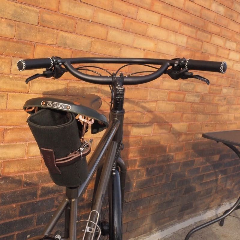

I dumped the stock bars.
Researching for my other build in the works, I like the 'Jones Bars', so I tried the 'butted' 2.5"s because they were 100 bucks. Next day they were 140 bucks. Ouch !!!
Installed, really great on this machine - my neck pain is gone, the straight angles and the extra bar space completely cleaned up my cockpit.
Regardless of riding position (except 'deeply tucked'), even standing - these bars are far superior to stock.
Having tried various angles of sweep, a bit high for my shorter legs, but still crazy comfortable.
I see them as an heirloom I can put on GF's build Jones H 2.5in rise bars.jpg The butted are stronger and lighter, but needlessly more expensive for our application.
Now I'm going w/ the flat H Bars (in 660mm). Finally found a good local shop to get my parts. Just got a text and they're in.
I'll be posting photos on the Ltd - in the 2.5" (silver) bars and in the lower (black) flat bars for interested Ltd owners.
