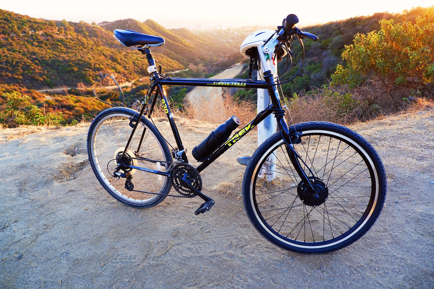

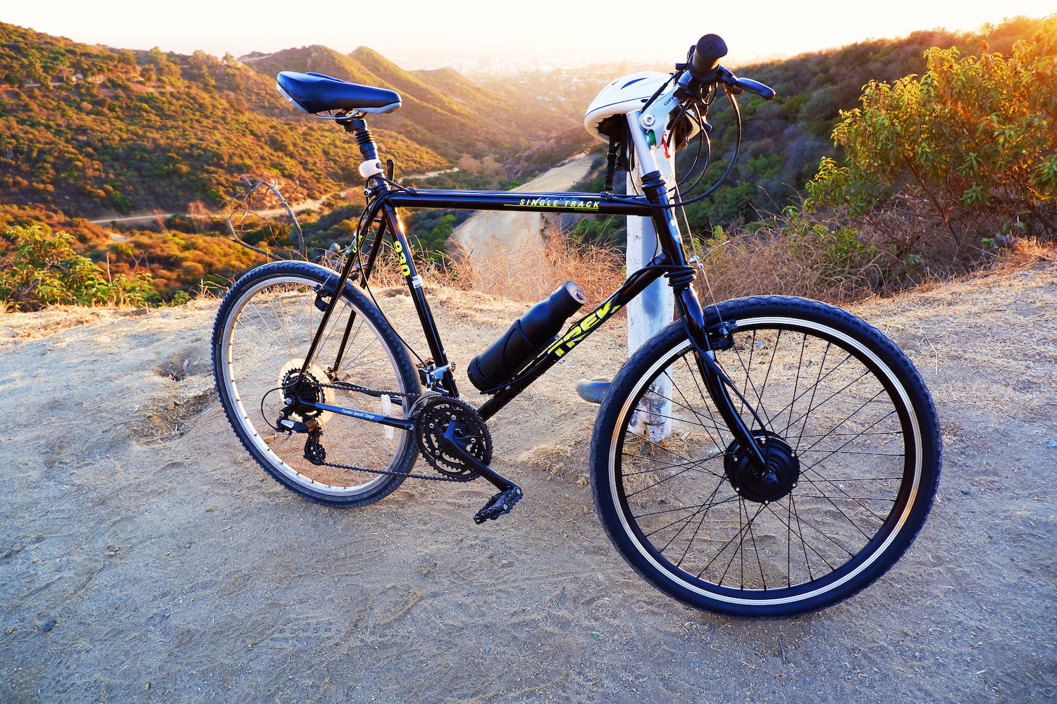

I'm very new to this, but I've been researching this issue and a lot depends on how far you ride, under what conditions, and if you want any kind of suspension.
The bike below is a front-wheel hub conversion w/ a Clean Republic Hilltopper Sprinter, and it's 40 pounds. I'm having a great time with it, but power, torque, and range are low. It's ideal for fitness ride around my hilly neighborhood where I want to get a serious workout, but your limitations are: 9-16 mile range depending on route and how much you want to pedal, can handle a 15% grade but only with low gearing and hard work, and only minimal suspension.
I'm 63, 150 pounds, pretty fit, and 6 foot 1, so this has been great, and I'm sure I'll still use it a lot for short fitness rides, but the range issue is a problem and I'm getting my wrists and hands beaten up from potholes and cracked pavement on the roads here. I do have a Girvin Flexstem and suspension seatpost, which would be enough for once or twice a week, except now I'm riding much more than I thought I would-- as a lot of us do once we get into this, I guess! I'm also getting deeper into the park, riding at night, and going off road a bit more, so it's getting harder to see and dodge potholes, roots, etc. I'm figuring the suspension will keep me a bit safer.
I wanted a bike under 40 pounds as well, but I also didn't want to pay more than $2,000, so I wound up raising my limit and ordering a Motobecane with the smallest power plant they offer. I figure it will probably be around 48 pounds, and with some simple mods maybe I can get it down to 46. Hoping that 40 Nm of torque will be enough, and that I don't burn out the motor! At that weight, I'm hoping I can take off the battery and front wheel and still lift it into my car. May be tough-- the bike below wasn't that easy to get into the car even without the motor, when it weighed 30 pounds.
Anyway, if you want to experiment, a conversion isn't a bad solution. Note that it will be totally different from a pedal-assist, this is throttle only.
