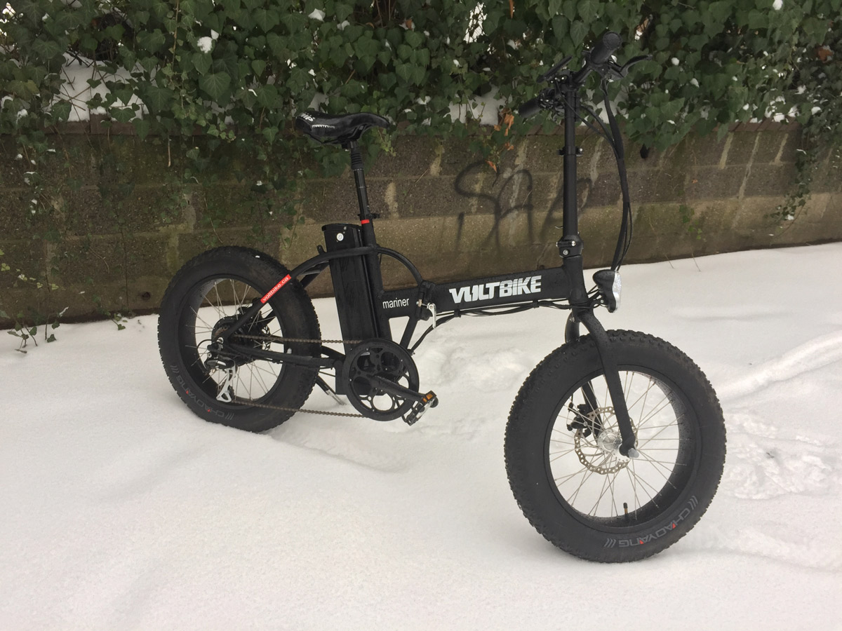

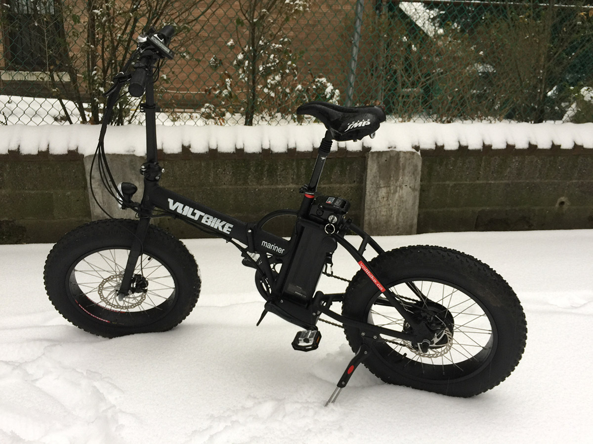

Ebikes in Brooklyn? Who would of thought?
:)One of the many;)
