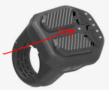

My wife just got a LaFree E+2 today. I have a Specialized Como 2.0 so we now both have e_bikes. I am wondering if anyone can help me with a question. How do you set a LaFree E+2 for AUTO with the onboard RideControl ONE controller (no display). Thanks in advance.

My Lafree E+2 does not have the auto option. Some of the Lafree E+2 do and some do not. I actually would not have known about that option but the manual mentions it and it also mentions some do not have it. If you don't have the six light indicator and only have five your Lafree does not have the option. I have no idea why some do and some don't. Hope you love your Lafree they are awesome bikes.

The Auto Mode is Really Good ! Maybe even better then switching thru Assist levels Manually.
To engage it:
-Once powered up
-Press Down on the Lower Assist Level Button until you are at ZERO assist.
-Then, One more press brings on the Auto Mode.
-Signified by a Light in the Middle.
Let us know if that worked for you...................:cool:

THAT worked like a charm. It's 10pm here, so we won't ride it until tomorrow, but sure enough, that's how you get there.
THANK YOU!
It does seem like Giant keeps auto a secret. Once I figured it out for my wife’s bike it is the only way she rides it now!
Works like a charm and, yes, it's a great setting. Kinda like what I can dial in for my Specialized Como with Mission Control. Very cool...
