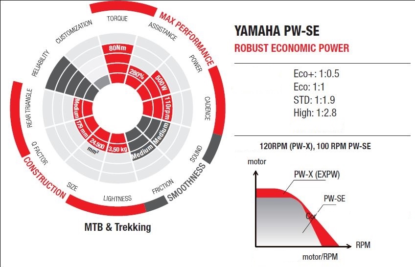

The display is normal... the Highest assist mode does not indicate the current range.
Regarding the power levels, Standard is 190% and High is 280% for the PW-SE motor.
Thanks for the reply. Do you have one of these? Court did a review of the PWX display and that showed range estimates for all levels
Also when Court did a review of the older version Emotion Gravel X with the PW motor and larger display that also showed range estimates in all levels.
I'm also not feeling the extreme boost that I used to feel I had in the high setting, now it is hard to tell if it offers any more boost than the STD setting. It would seem strange that it doesn't show any error message if there is something wrong. I'll just live with it, no warranty from BH and the Yamaha info on warranty indicates that is up to the bike manufacturer.
I think the perception of lower power has been since I started using Tannus armour tire inserts. They seem to add significant rolling resistance and that is most likely what took the edge off of the feeling of boost in high setting. Eventually when the stock Schwalbe G-one 40c tires wear out I'll probably go with a higher pressure 35c tire that has some flat protection and ditch the Tannus inserts. Maybe the lack of range estimate in high has to do with how BH asked Yamaha to program the firmware. I never paid any attention to the range estimates when I first got the bike so it could have been that way all along for the high setting.

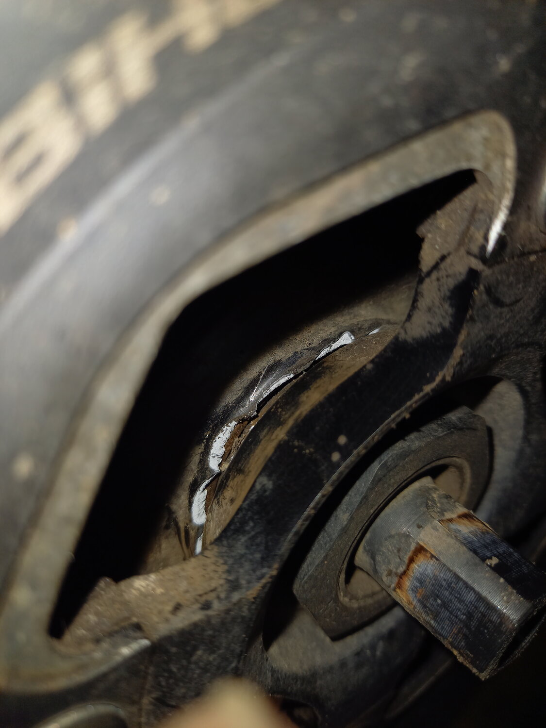

I am also a Haibike rider (Sduro Full Suss LT 4?) and have just had the same fault happen to me as the one you have shown above. For a couple of weeks I was feeling a slight looseness/wobble in the pedals and assumed that the bearings needed looking at. I tried to get into a shop but couldn't get an appointment and had to keep on using the bike to commute. Later when i was riding the pedal jammed and wouldn't rotate forward. I managed to get it moving again and put it down to the something else. A couple of days ago I went to ride and started hearing the grating/ grinding noise and again, the pedals jammed (I could back pedal but not forward). After inspection I noticed that there seemed to be something metal stuck behind the chain ring and between the motor. Against all of my better judgement I tried to ride the bike home but eventually had to stop when I realised that the rim of the motor casing was starting to break up! 😬😳 As you can see from the photo it's pretty ugly and much like the one you posted. Unfortunately the bike is now out of warranty so I'm concerned if and for how much it is likely going to cost to resolve this issue. Do you have any advice? The bike is currently with a mechanic but the parts haven't been removed and the damage is yet to be assessed (the mechanic plans to contact Haibike on Monday).
Any help would be greatly appreciated 🙏
PedallingHope: Ouch, I'm sorry to see your Haibike is out of commission. The good news is that you have Haibike Rider/Performance Line Bearings there in your home country who might be able to assist you; should Haibike not be of help.
Aside from what @Haibike Rider offers for us Yamaha folks, I still don't believe parts for the PW series motor to make repairs, are offered for sale. I predict this will end up being an outright motor replacement with a brand new unit. I will be curious to find what Haibike says. Now, the question of the day will be; are there spare PW motors still stocked? Or will the motor replacement revolve around the PW-ST motor; which will then require change out of the LCD unit, control unit and all related wire harnesses. I see used PW motors are popping up on ebay quite often nowadays. Even complete new ones.
As a Full FatSix-PW drive motor, I'd like to know what caused this failure and the course of action to get you back on the road again. Please keep us informed.
If I may, looking at your pictures; you mention commuting. Was your H-Bike "put away wet" after each ride? Was there some kind of routine of clean and inspect during your time owning your H-Bike? Frequency of cleaning and inspecting? Did you go through water up to the motor driveshaft at any time? In the UK, did you have a chance of commuting in snow? Does the UK road departments treat their roadways with corrosive salt and calcium chloride in order to melt the snow and ice as they do here in the northeastern US? Reason I ask, is that it looks like long term water and/or dirt and other contaminants got inside, around the drive shaft and bearings, causing motor failure; judging by the internal rust I see from the areas of the broken motor housing.
