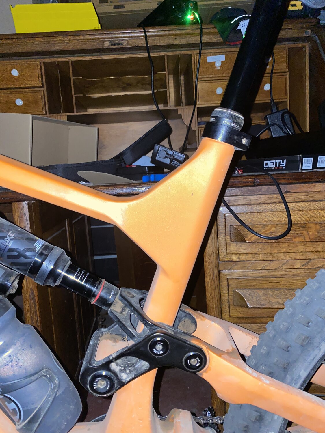

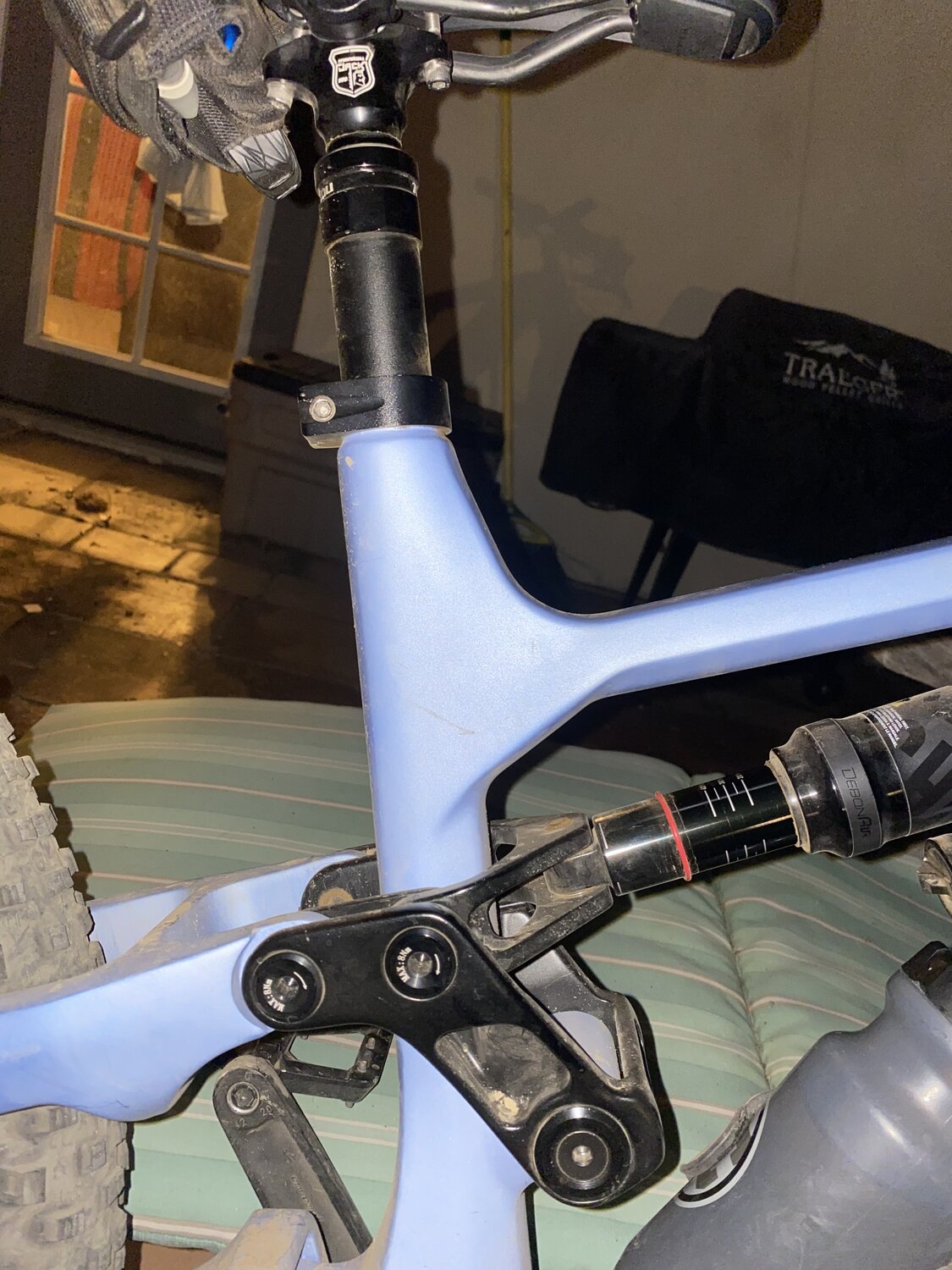

It’s difficult to say from the pictures. Typically the large does not have a shock lined up straight perfect with the rear stays like this one. I looked at my bikes and the large it is 19 3/4” From BB center to to of painted frame under seat post clamp. And Medium is 17 1/2”. I am 6 feet 2 1/2 and I’m torn between which size I like better. My pants are only a 32 inch inseam. On the large I have the dropper as low as it can go. on the medium I could have seven or eight dropper. That would be really cool. The large frame has more than 1“ longer TT. I find this better for downhill but not nearly as nimble and the tight switch backs.
Orange is large and blue is medium

I am even riding with swept back bars. Making the bike shorter. What is your inseam?
Thanks for the good info. My inseam is 34” and with the seat all the way up it feels a little short. I have the standard dropper I believe. When I measured tonight I got just about 17” from BB to top off paint and though not as accurate, a couple of the other measurements seemed close to medium as well. WW is thinking the frames may have been mis-painted, but we’ll know tomorrow. This color is ‘Northern Lights’ which is a dark green that can look black in certain lighting.
