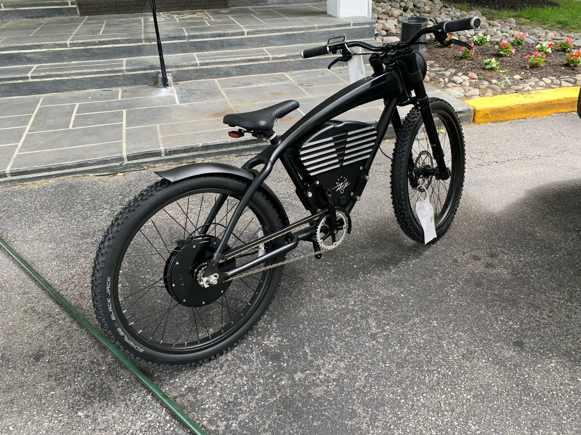

@vincent can you post a few photos of your bikes?
I'm in the mood for bike porn.
Here ya go, my latest add to my stable

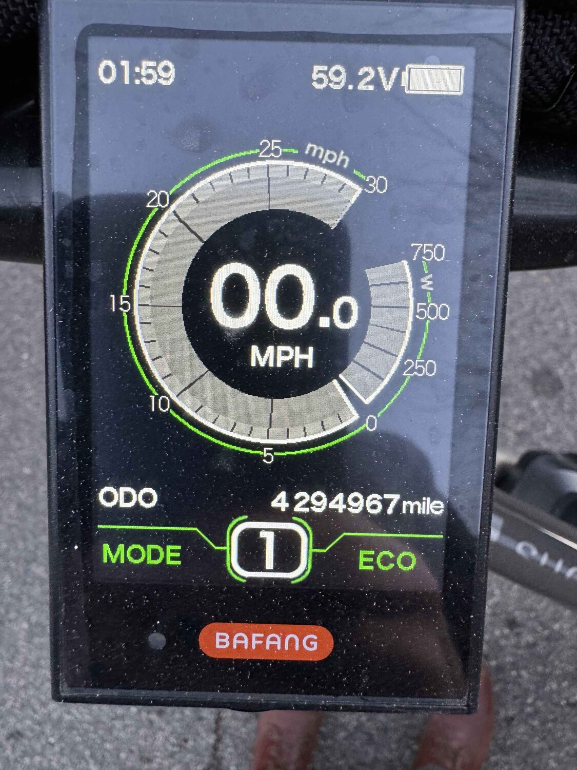

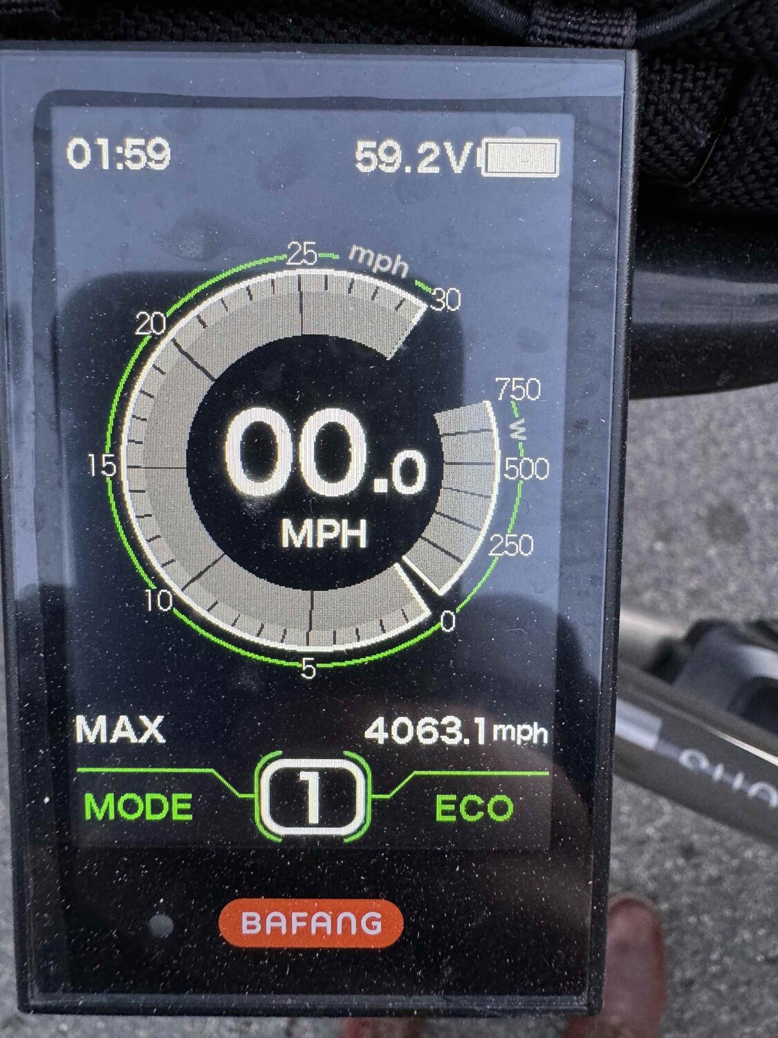

Had a funny bug come up with my new m620 motor controller. Not worried just thought it was funny, my new top speed is >4000 mph and I have really traveled an amazing distance. I have never actually seen odd numbers on the display, not sure what caused the weird numbers other than there must be some buffer overflow issue.
