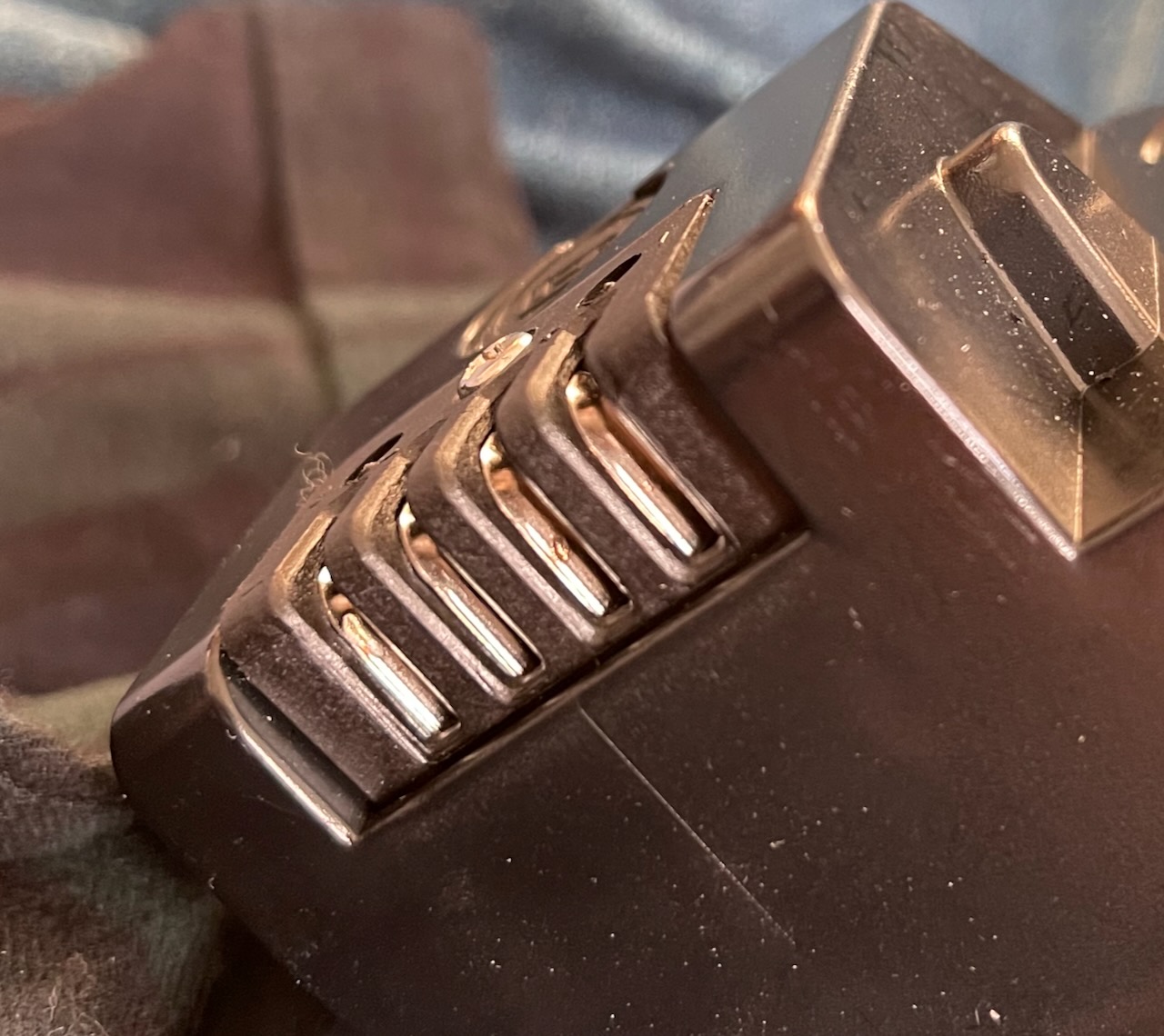

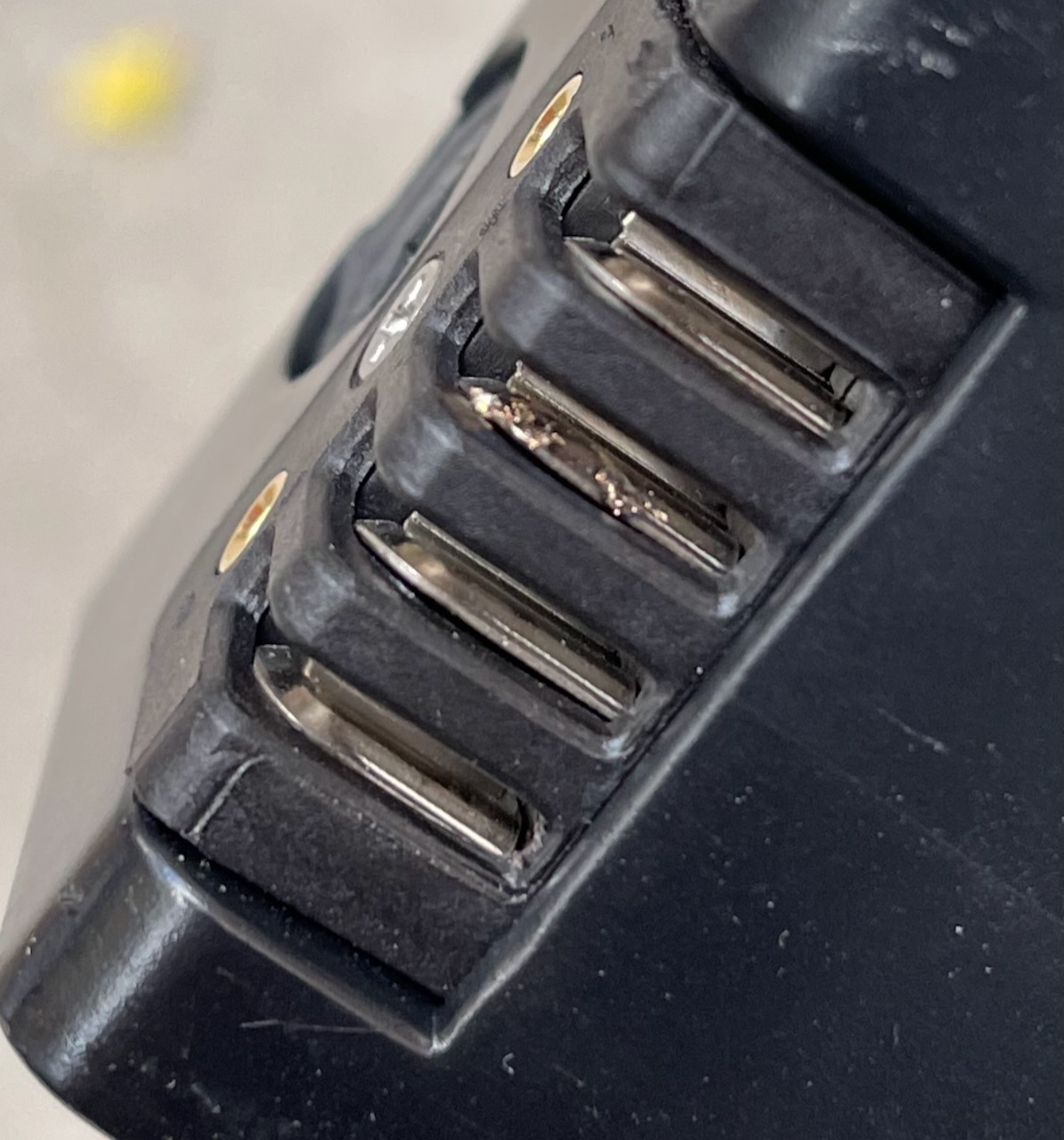

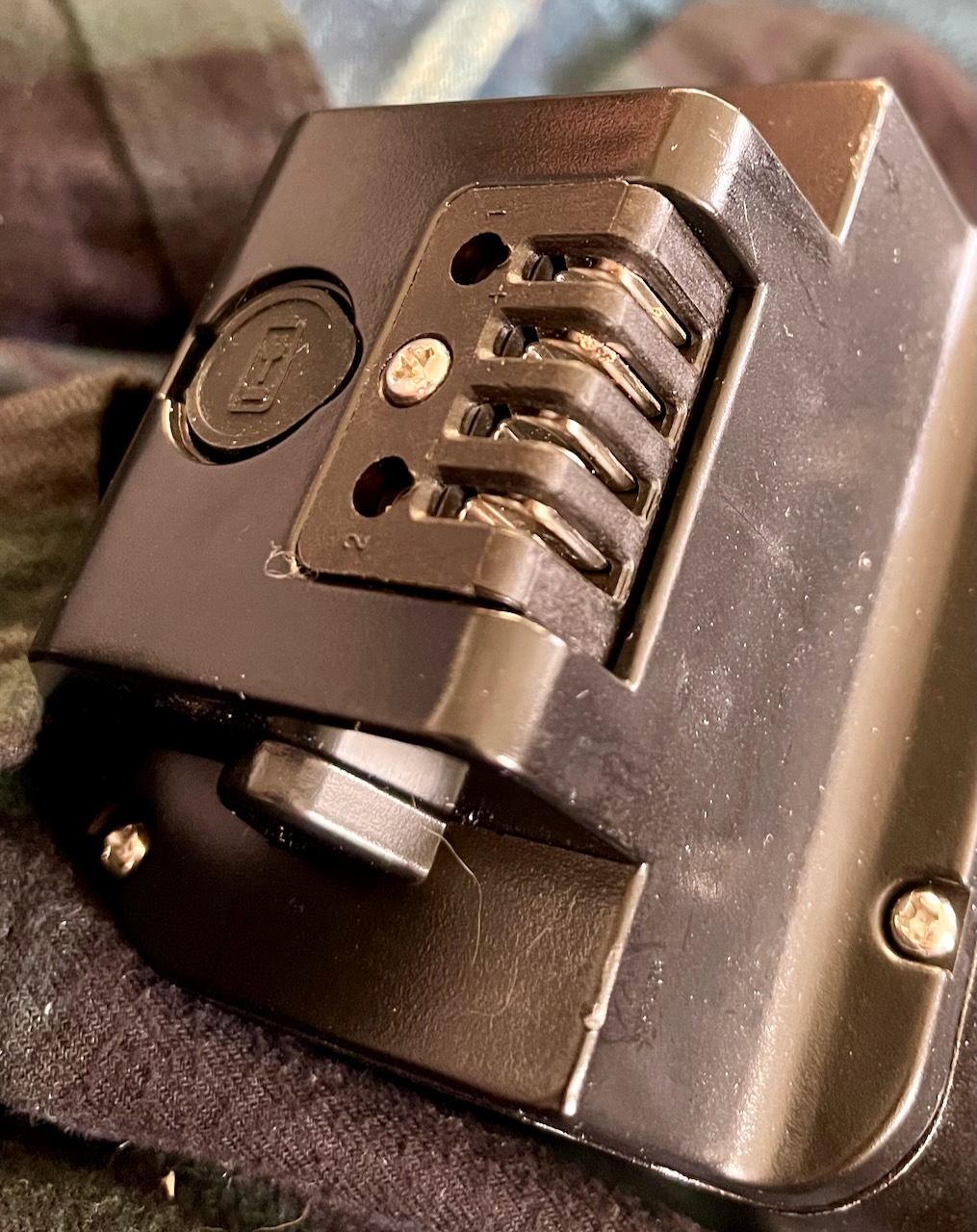

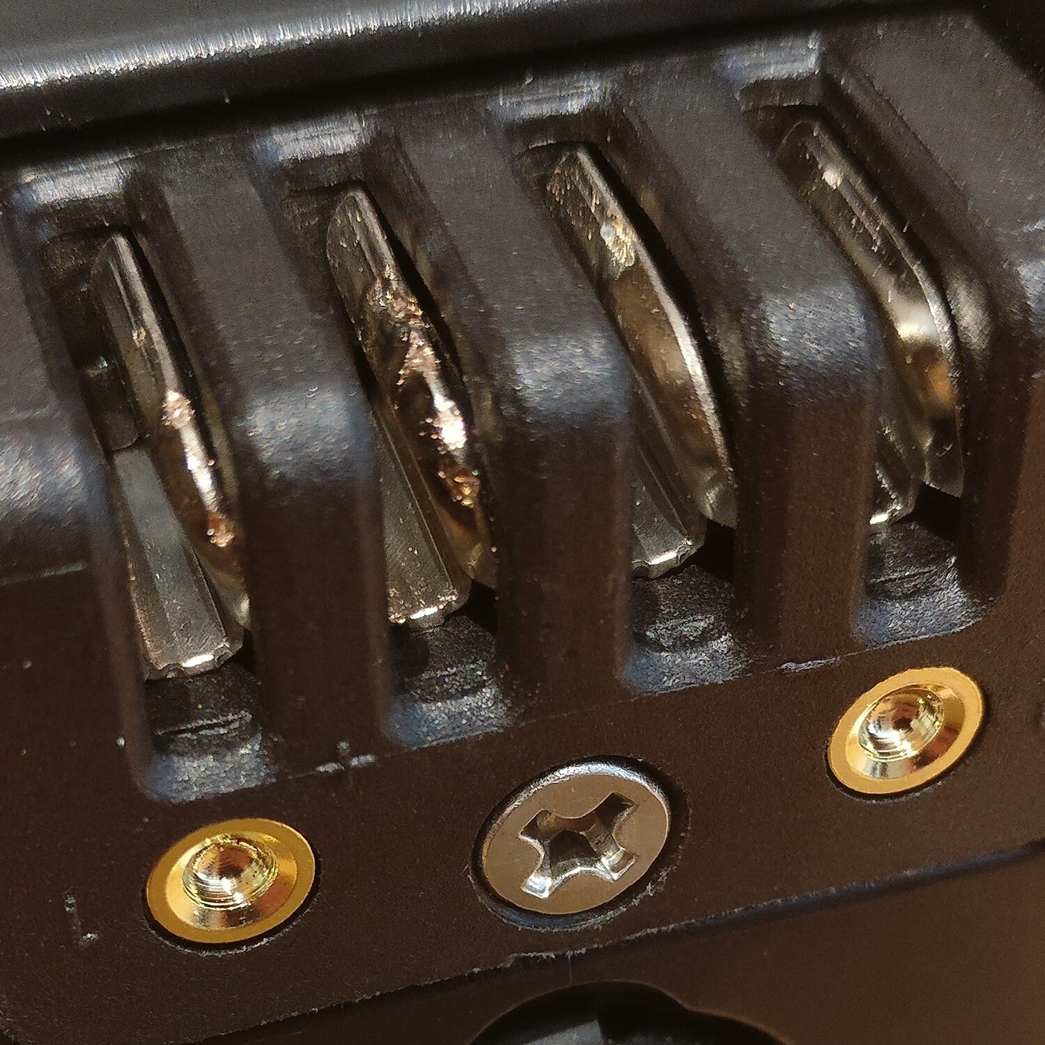

I have been having the engine shutdown issues and noticed that the contacts on both batteries I have been using look as though there has been some sort of spark at certain points of contact. Does anyone elses batteries look like this? It doesn't look like scraping from removing / adding the battery, rather it looks like the metal has had some sort of spark and heat.
You can hear the spark sometimes when you insert the battery. That is the huge inrush of current charging the capacitors on the motor controller. It's not great for the connector but should only effect the leading edge. I'd be more concerned if one of your contacts was stretched out more than the others making a loose connection.

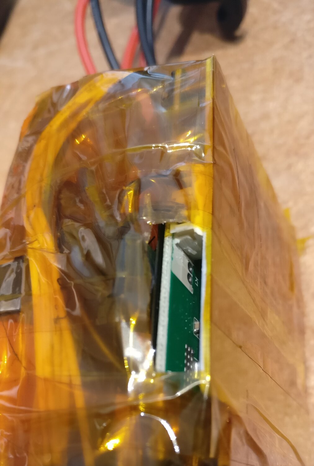

The Xiaoxiang BMS has the capability of enabling the output with a physical switch. I will look into adding one to the internal battery...
There's not a lot of room inside the internal battery but the two gold spring contacts are not used for anything. These almost seem like they were intended to enable the battery once it's fully inserted. I question if the connection is reliable over rough terrain. I could add a capacitor to filter out any brief disconnections. Stay tuned....
