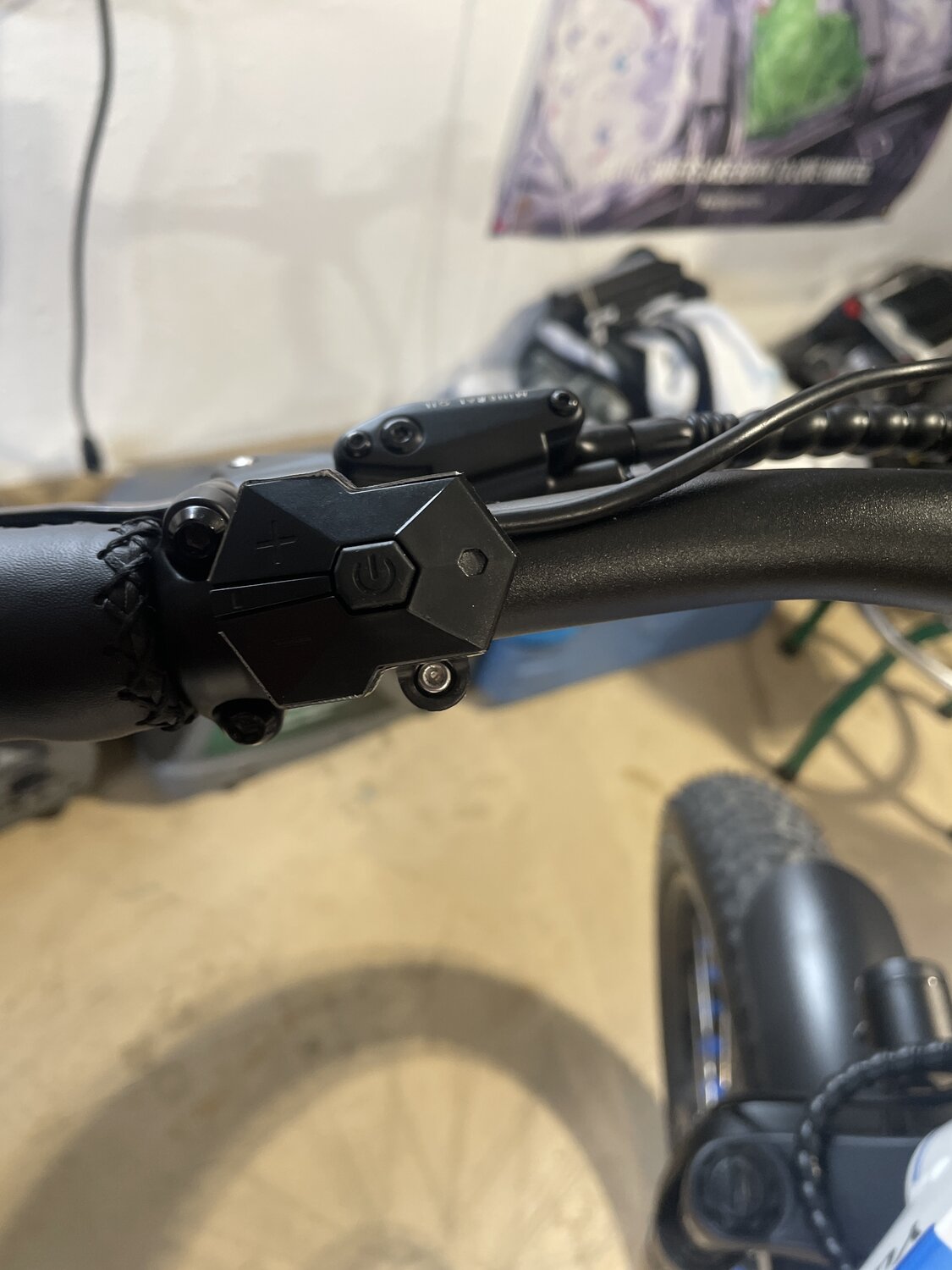

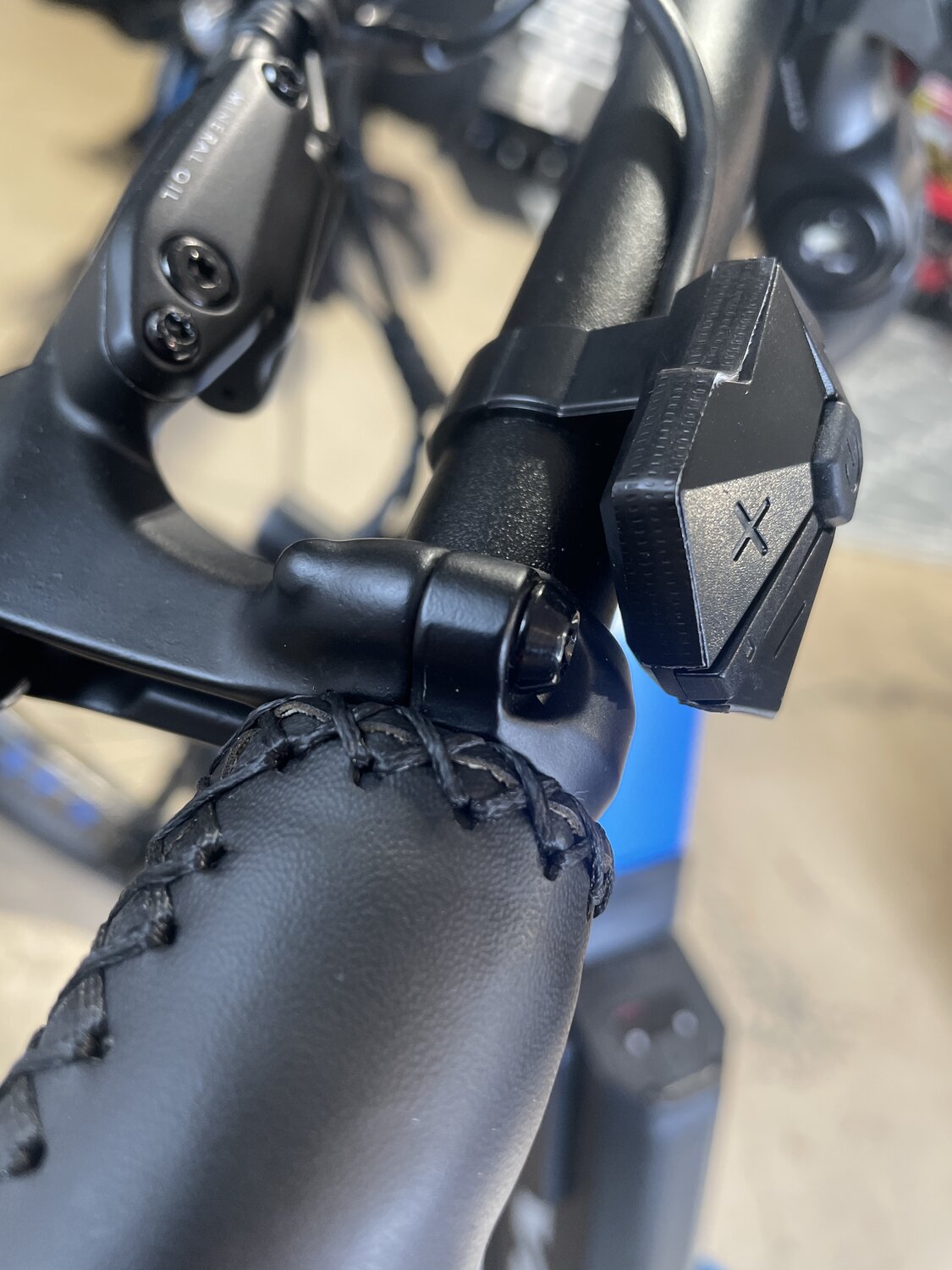

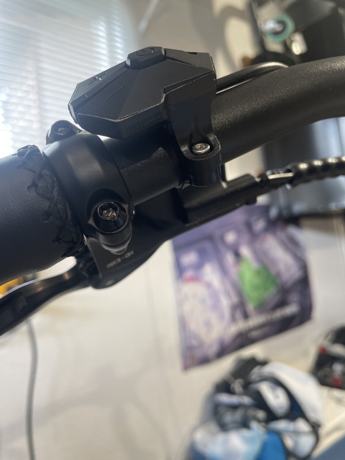

To prevent the control buttons from breaking, put a thin layer of gorilla tape on the edge so it can’t be caught on anything, my thumb has bumped it a few times and it flexes upwards, will only do that so many times before it breaks, does not affect button operation
