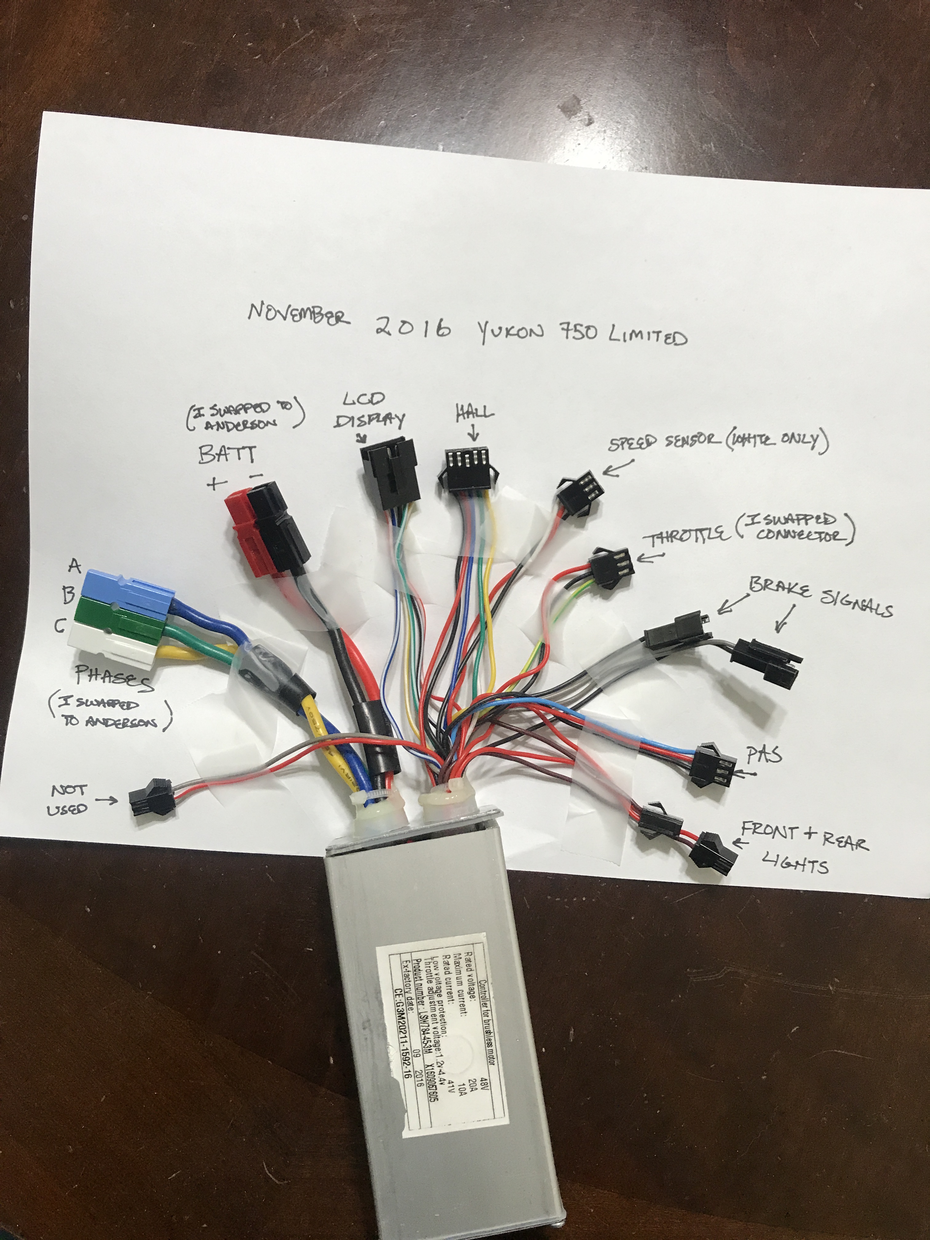

@gcoop This is what I was able to decipher when I overhauled my 750 limited. I swapped some of my connectors so your stock controller may look a slightly different. I called out the connectors I swapped. Hopefully this helps. Please note that this mapping is from my November 2016 model of the Yukon 750 Limited. Not sure if anything changed but just wanted to make sure this is clear before taking this as absolute :) Cheers!
Yikes. That photo tells you everything you need to know about a Voltbike. No waterproof connections at the controller ??? Seriously ? Looks just like one that comes in a hub motor kit you can buy on Aliexpress for less than $200.
Hi Deleted Member 4210. Thanks for your input and we value your contribution with either your shop in Chicago or posting at the online forums. Your comment above is from thread in 2017 regarding VoltBike Yukon 2016 edition. As you are probably aware VoltBike Yukon has been around for 5 years making it our best selling bike in our line up and the most updated bike to date. Not many companies around have this track record. The bike has been improved over the years based on real feedback from riders across Canada and US. Back in 2016 the controller on Yukon was mounted on the seat post. It was encapsulated in black plastic box which was itself 100% water proof. The picture you see on the photo represents the naked controller unit which itself is also sealed. Waterproof connectors were not needed. In 2017 our design changed and we decided to put the controller inside the frame. With this we accomplished sleek look (no boxes outside) and again good water insulation. In 2018 we redesigned the legend one more time. The controller unit got upgraded to more powerful one and is encapsulated in metal shield which is again 100% waterproof. The connections itself got upgraded to rubber heavy duty water proof connectors. However due to the increased size we had to mount it on the seat post again which is usually preferred location by our bike mechanics. It's easier to get serviced. As you can see the technology evolved since 2016. Improving the reliability and serviceability of our bikes has been always on top of our list. I wish you good luck with your business.
