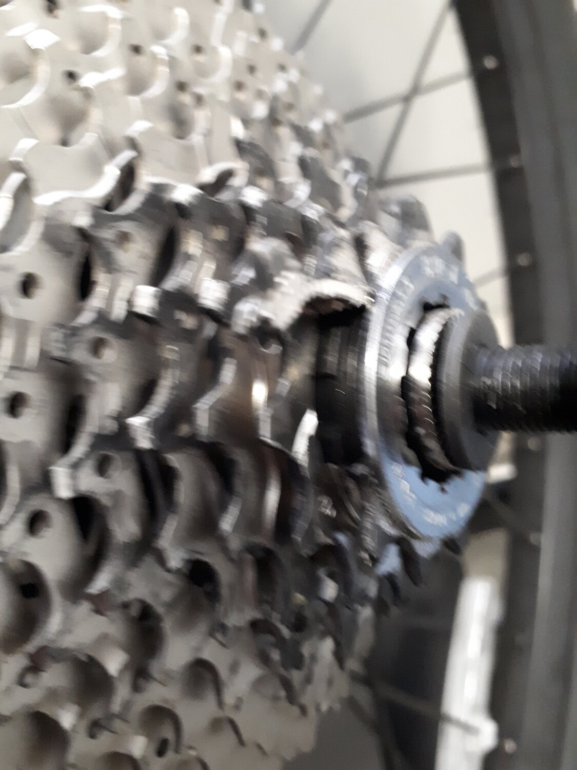

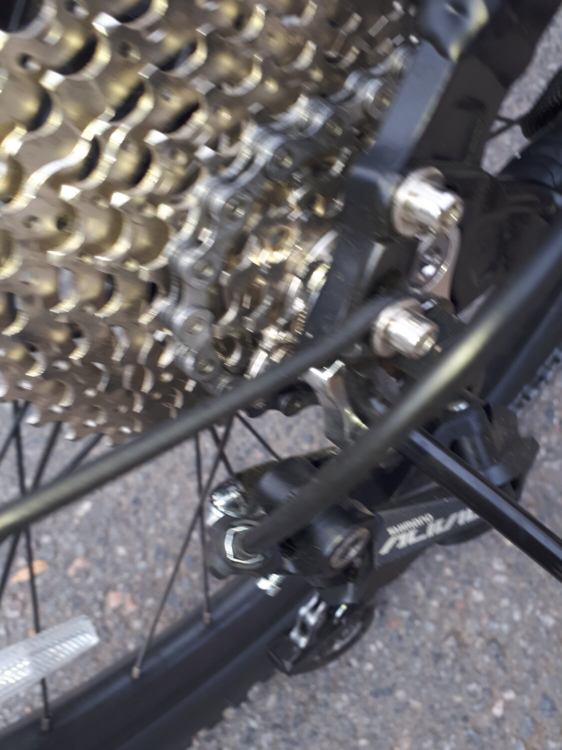

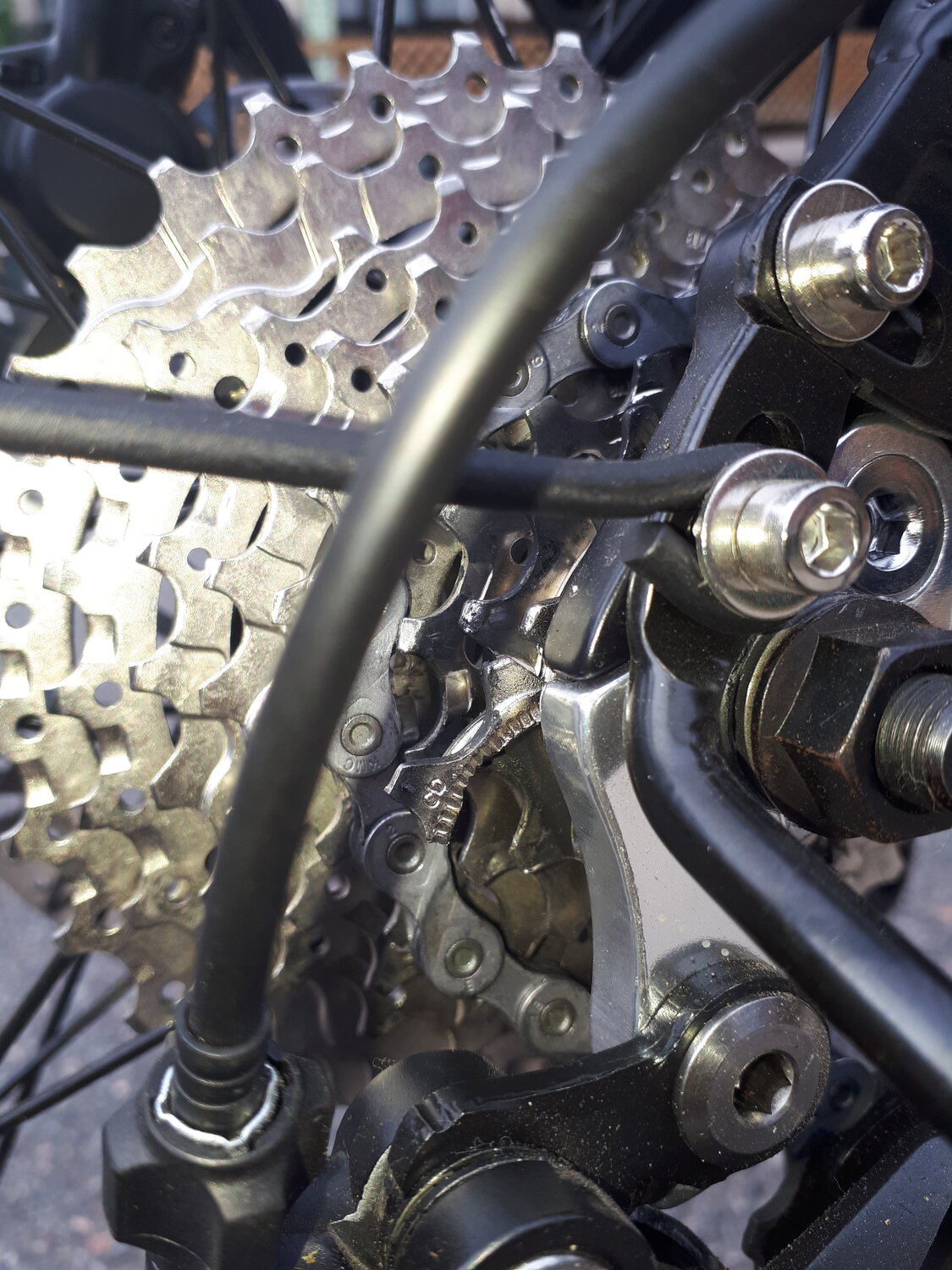

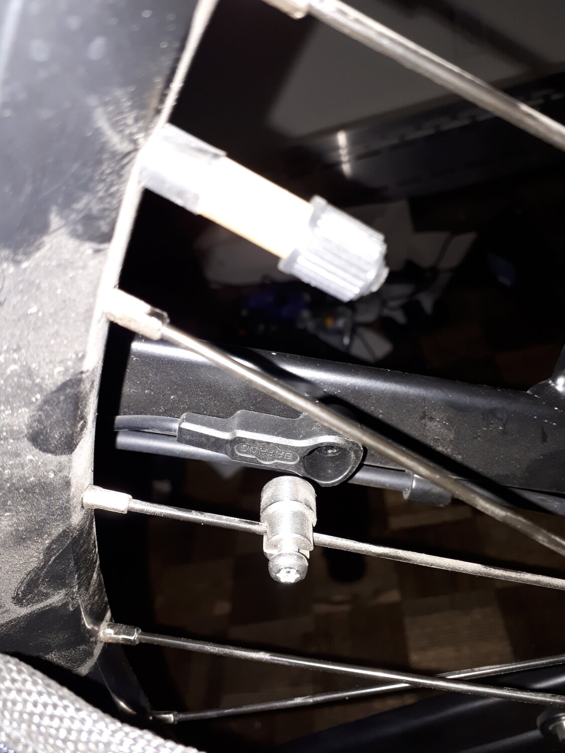

rize rx 2021First-day bent disc brakes(paid $50 to fix out of box). Broken Cassette which caused the chain to break, bent front fenders, derailer hanger the list goes on... After replacing the 9 speed broken cassette I am unable to bike on the last 3 gears. If I try biking in these gears the chain skips then eventual breaks(4 chains so far). The bike shop I took it to couldn't find the problem.. Hoping that someone here anyone here can give me a solution to this problem before I call for a refund?

2020 RX Pro? Make sure you replaced with the correct cassette. Off the top of my head its a Hg400 11-34. Also you should not be breaking chains if you are using a KMC e bike chain. 2400 miles up crazy terrain including flights of stairs and have never snapped a chain
rize rx 2021. like I said something is wrong with the derailleur. If I peddle on any of the last 3 gears while the motor is on. The chain pulls then snaps.
That derailleur is going to need regular adjustment until the cable stretches out. I was in a local shop the second week I recieved mine and another couple of months later (around 500 miles). Guy at the shop said the alivio derailleurs are finicky to dial in. He got mine super dialed in after the initial cable stretch and I’ve been solid since now at 2400 miles. Even with some bad shifting on my part I’ve never snapped a chain though. Don’t see how that happens. I regularly rapid shift 3 gears as fast as I can pull the trigger and have never done that.
Of course you dont have the same bike.
I don't mean to sound smug, but it sounds to me like your "shop" is the issue here. If they can't find what should be a simple problem, you need to get any money given to them refunded and go elsewhere. This is not rocket science, and your bike is nothing special when it comes to setting up the derailleur to shift properly.
Hangars and derailleurs are both bent frequently in shipping. Not always, and this bike manf. is not unique when it comes to this issue. It happens! You said the hangar was bent. Has that been replaced? There is no way on God's earth that bike is going to shift like it should with a bent hangar OR derailleur. This stuff should be easily spotted/diagnosed by an experienced tech....
Last, if it's not shifting right, riding it until it breaks isn't helping a thing, and YOU are the only one to blame.
