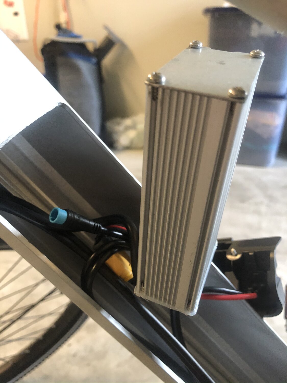

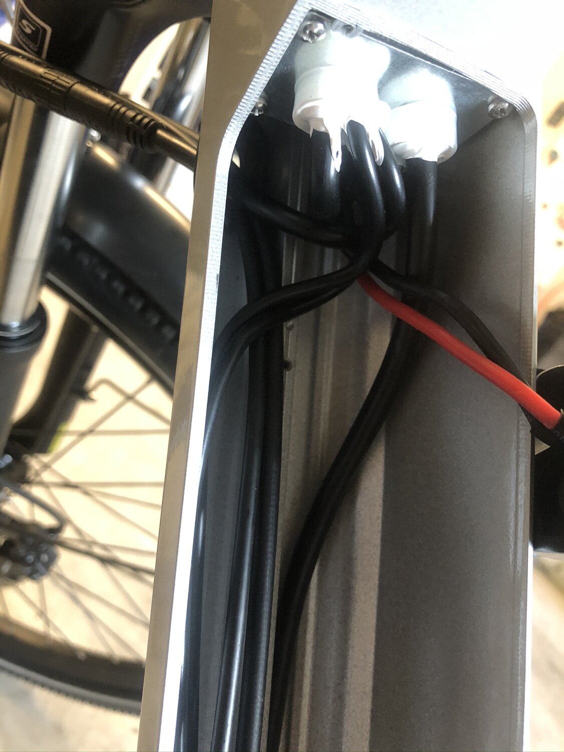

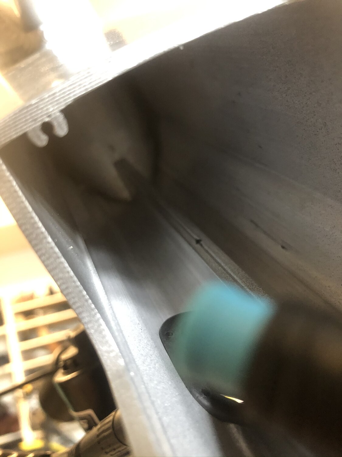

Hey everyone,
I have had some minor issues with my Rize bike in the past few days, one of which I'll detail here.
After initial assembly and an extended shakedown ride the day after, I noticed a sound coming from the head tube area. I tried reassembling the fork and stem as the sound appeared to be coming from that general area. However, the sound, which can be described as a rattle, continued and was amplified whenever traversing rough terrain. I had my partner shake the bike with my ear pressed against the frame and the rattle was coming from inside the frame between the head tube and battery.
After removing the battery, fours screws needed to be removed in order to remove the upper and lower battery housing. Two of of the screws were phillips and the other two required a hex key and were machine screws of the battery housing. After removing the upper and lower portions I removed the battery tray by hand as it is simply pressed into place (there are a lot of wires running through the area so take note of which side of the frame the wires are running). I noticed that the controller was stuffed inside the frame between the head tube and battery and I was able to simply pull it out. There wasn't any sort of anchoring system or vibration dampening. I used a combination of furniture floor protector pads and a bicycle inner tube to wrap the controller before shoving it back in there and there is no longer any rattle.
Photos posted from left to right: controller inside the frame, controller removed, controller. Unfortunately I don't have any photos of my "solution" but if you're hearing a rattle it's potentially the controller inside the frame.

Scheidty - Good find and troubleshooting.
Curious about the fix however, I believe these controllers generate heat. Potentially, what you did by wrapping in furniture pads and rubber could act as insulation keeping the heat local to the controller and perhaps overheating much more easily.
I would LOVE for someone more qualified than me to consider this and offer alternative materials or solutions if indeed this might lead to controller failure due to heat build up. I could also be TOTALLY wrong on this, and wouldn't mind at all someone correcting this concern.

I have the same issue as Sheidty. The rattle is a little annoying and I do plan on opening it up like Scheidty suggested and attempt to hold the controller in place. Excellent question from WildWillie regarding heating up the controller - sounds like a legit concern. I'll be checking back to see if there is an expert opinion on this.

I have the same issue but it wasn't continuously rattling. It was more like on every crack on the street or pothole. I also opened and I noticed the wires weren't attached to any clamps to I put insulation and the noise was gone. It's been more than 1000 km and still not noise. Easy fix. Mine is a Leisure model
