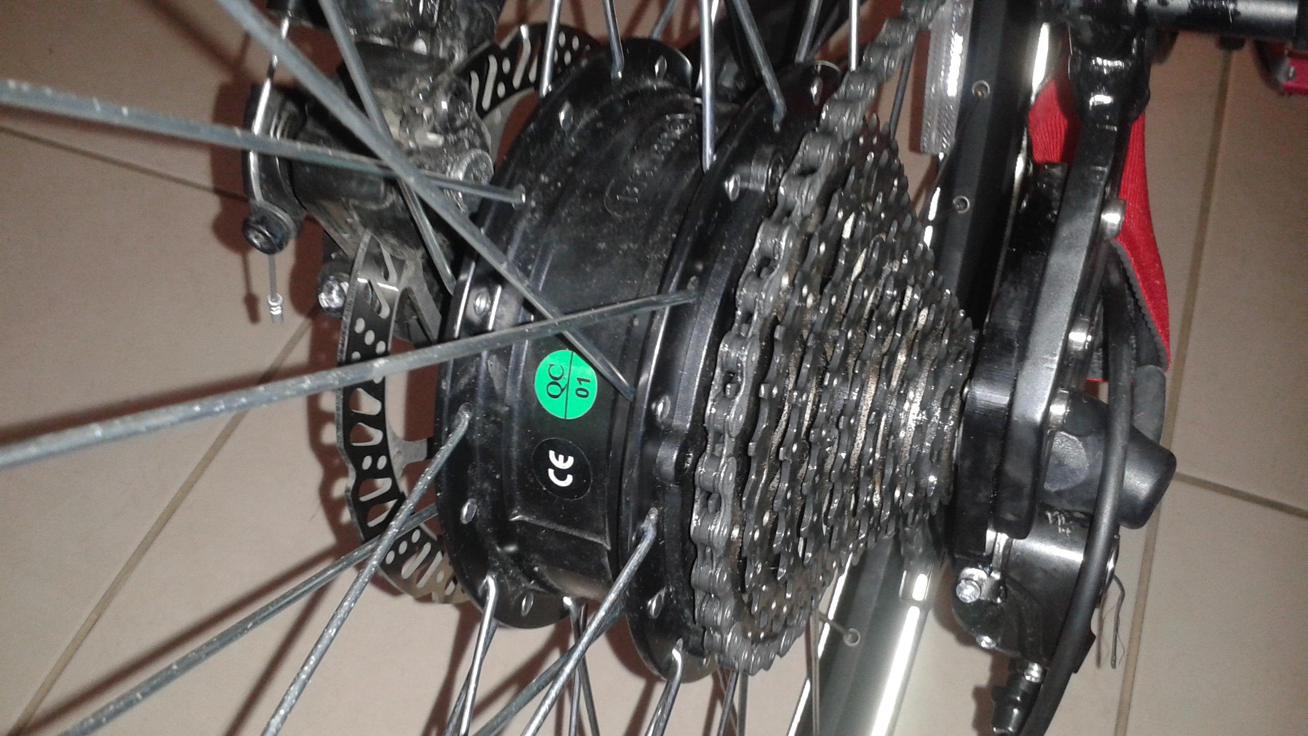

I've had 6 rear spokes break in the 1 year of owning the Crosscurrent. The first couple of times I took it into the shop to be replaced, but now I've been replacing them myself and I'm tired of it. I've been using the replacement spokes that Juiced sells on Amazon. I check the spoke tension regularly and it's always fine, but then every couple of months one snaps off at the hub. I guess I'll take it into the shop again and see what they say. I like doing my own bike maintenance but this bike has been too needy for me.
I've owned a juiced cross current for about a year now with about 2K miles and I agree that the build quality of the rear wheel is terrible. I replace a spoke or two every month and the spokes juiced sells have a different nipple thread size so you can't just simply thread a spoke through the hub and recycle the original nipple. You have to pull the rear wheel and take off tire/tube/rim strip, remove the old nipple and install a new one. It's a giant PITA. The spokes always break at the elbow. It's at the point now that the wobble and hop in the rear wheel is bad enough that I will need to rebuild the whole wheel soon. I understand that rear hub motors are heavy and the stress is much more than a conventional wheel but the 10/12ga spokes should make up for that. I don't think it's a waste of time having a wheel builder check your wheel and possibly rebuild the thing from scratch. I bought the bike from an e-bike dealer but overall I'm unimpressed with e-bike shop mechanics. The few times I've had the dealer make repairs they don't have parts in stock and seem to do a poor job. The one time I asked the dealer to replace a spoke and true the wheel they inflated my tire with a pinched tube that blew and ejected itself while I was riding along at 20mph. I don't mind a bit of regular maintenance but I'm losing patience and considering switching back to non bike for my daily commuter.
The problem is easy to identify but working to fix a broken spoke is a big mess. I believe the root cause of the spokes breaking at the elbow is from the incomplete manufacturing process. After bending the tip to form an elbow, it should have undergone heat treatment process to remove the micro fractures and fragility that happens during the bending process.

So I had my rear wheel re-built by my LBS. I didn't use Juiced spokes, they used all new custom cut DT Swiss and new nipples. The spoke pattern is the same but the bike mechanic chose to alternate the direction of the spokes where they enter the hub flange. I was skeptical about this but he said it would make the wheel stronger as it helps better distribute the stress on the spokes. He also said he didn't understand why they hadn't built the wheel that way. However, now there is a gap between where the spokes cross, and I always thought that spokes should touch where they cross. He said because they are 12 g spokes it is not necessary for them to touch or brace one another where they cross.
So, so far, so good. I have been riding about a week and no problems. Ill keep you all posted over the coming mouths, but if the wheel holds up this could be the answer to the Juiced CC, and CC Air rear wheel spoke breaking phenomenon. By the way the cost was $160.
