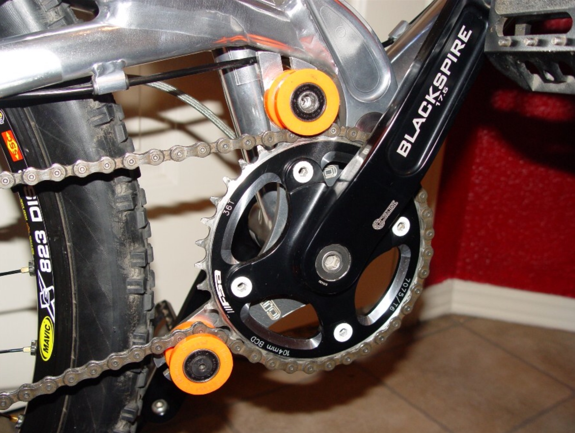

I am still having issues with the chain randomly dropping off the front chainring towards the inside. It never happens during shifting and usually in a mid gear but I have set the derailleur limit screws anyway. Would shortening the chain increase the chain tension and maybe prevent this from happening? If so, how many links should I remove?
Though the stock chain on my original CC was longer then needed, a new chain at a more correct length did not ultimately get rid of the issue. Seems to be a common problem with 1x setups so I think the only fix will be to put on some sort of chain guide. I've been meaning to see if I could do something with my 3d printer, but just haven't gotten around to it.

The bicycle chain for the CCS should not be any longer and/or shorter than 75 inches.
The good news is all is not lost however if one has set the chain length to exactly 57 inches and the bicycle chain still does not stay on the front chain ring properly; simply just tilt the entire rear wheel axle and rear wheel that is held between the rear spreadable bicycle chain stays(sight directly down the parallel rear frame chainstays) ; with the rear wheel axle/ wheel slightly canted and tilted to the right side, that should help the bicycle chain stay on the front chain ring; this will help serve to counteract the former pulling tension forces to the inside(left) side of the chain ring; by now pulling instead now slightly to the right side by re-positioning the rear wheel canted and tilted at the axles slightly to the right side between the rear chain stay dropouts one can hopefully realign the rear wheel and its associated rear cogset to be in better perfect rear cog gear alignment with the front chain ring alignment.
Juiced Bikes has probably cut the length of the chain correctly for their CC bike; so its more likely that its a common issue with the misalignment of the rear cogs with the front chain ring; which also happens quite frequently also as well in the bike assembly process;
also make sure your high and low limit rear derailleur screws are adjusted properly so as to hit their high and low limit parameters; check to make sure that the "B" limit screw on ones Shimano Alivio rear derailleur is also adjusted properly also as well; the jockey pulley wheel should be between 2-3mm away from the largest gear cog on ones rear freewheel and/or rear cassette to help ensure smooth, reliable and crisp shifting.

I think he's trying to say the chain should be about 57 inches long not 75.
SO today on the way to work my chain jumped twice and I was observing it and I finally discovered the culprit. When I switch gears while the motor is engaged (while pedaling) it causes the top portion of the chain to sort of whiplash due to the momentary slack in the chain while the derailleur is moving between gears because the motor is actively spinning and pushing the chain forward. If I put some sort of plate or chain guide right where the chain engages the front chainring I think this will solve the issue. Also I could just make a mental effort to completely stop pedaling while switching gears!
Something like this?
