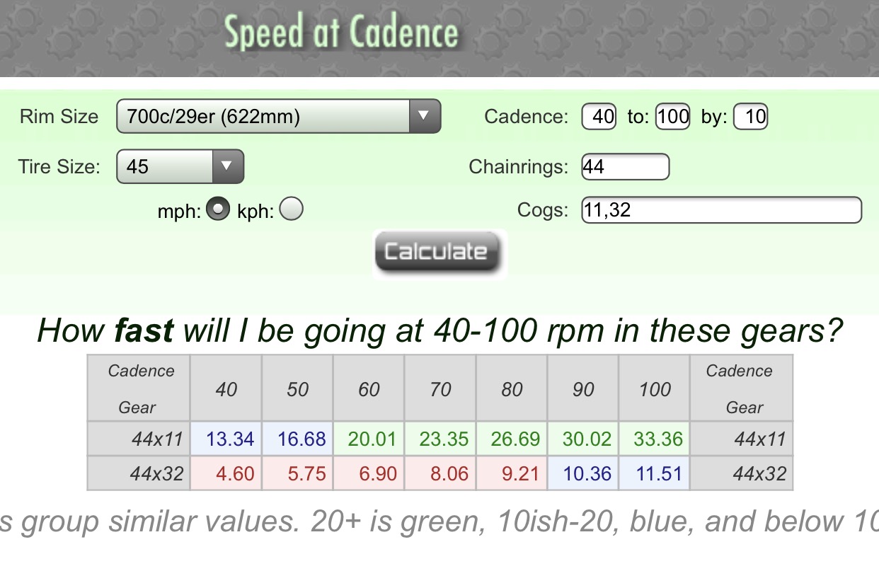

I changed my front chainring to a 44T and it's not terrible to pedal without power.
I'm glad to hear better powerless pedal is possible. But I'd still like to keep at least 50T for running powered. I use eco mode as much as is
practical, but 3 & S modes are great for getting a run at a hill. It was a real struggle getting over the hills I can now zoom right up*. My reason for
improving unpowered pedaling is that I want go places where the distance between charging opportunities exceeds my battery range. With a 26T ring I can still get a better than 2 to 1 ratio with
more leverage on the pedals.
*Weight loss has also helped a good deal.

I picked the 44T to be a good middle ground for me to run powered or unpowered depending on preference. If you look at my chart you can hit the hills pretty well in lowest gear and still do ~30 mph in top gear at 90rpm which is easy under power and about all the speed this bike can get under any configuration.
