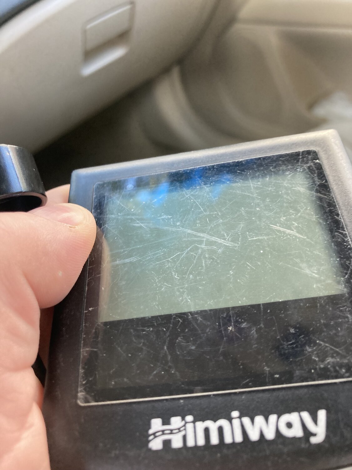

So I got my Himiway in October of 2020, rode it till it was too cold (Northeast, so a only a month and a 1/2), then rode it all Spring and till August, putting on 2k. It's been broken since Aug 21st and it's Oct 17th. At least 40 emails back and forth with Himiway including countless videos. The issue is that during a ride, I had two battery bars left on the display and all of a sudden my display went from two bars to blinking like the battery was going to die. I turned off the bike and turned it on again and it showed two bars again, but as soon as I gave it throttle power it began to blink again and then died completely. I walked the bike home and then charged the battery completely and the battery indicator (the bottom button on the actual battery you push) as well as the wall charger indicated a full charge. However, the display does nothing and does not power on.
Himiway, after many emails and having me buy a voltage meter and trouble shooting things myself (I'm no expert!!!) and send them the countless videos they said they were sending a display. The display took a week to ship and then shipping took another 2 weeks "awaiting for item to arrive" at USPS (then using the slowest shipping method possible) Meanwhile, I took my bike to a bike shop where it sat and the owner was upset that my huge bike was sitting there taking up valuable space for 3 weeks now! So I just got the display, which was supposed to be "brand new", but was completely scratched up and ridiculously worn; it was obvious to my bike mechanic this was a used part and not "new". I emailed Himiway about this who then still claimed it was a "new part" saying it must have been "scratched during the shipping process". There's simply no way, totally not true, and this was even after I sent clear pictures with the VERY scratched up display (see pic bellow). I really don't care though, the bottom line is the display was hooked up and then DIDN'T WORK, DIDN'T DO ANYTHING. So my bike mechanic made me take the bike home.
So after more emails and some pictures and they are sending another "new" display with a controller. I am hoping this does the trick as it will be winter soon!!! Also, the front shock froze and doesn't work, the cheap front light broke off, and the tail light would not go off after I rode during a little rain and so I just yanked it off so the battery would not drain. So there have been other things as well...

Well, I tapped on the controller with my hand and now the display actually turns on and I get an Error 30 when I try to give it throttle. It's definitely the controller box. So I have a new controller box and display Himiway sent, however, there are two wires that seemed to be tucked into the frame that I can't pull out and am afraid to use more force and brake something. So I guess I'l need to take it to my grumpy local bike guy and be charged way to much to hopefully have this done as well. Anyone know if the MagiCycle is any better? It's cheaper, has more torque and the same battery as the Himiway. It looks exactly the same too. Too bad I just had my 2nd Himiway delivered based just because I already had one and based on the battery being a 1/3 of the cost and having two batteries. I'm thinking I may have done better with a MagiCycle? Himiway also now stops you from adjusting the no speed settings and limits the motor now to 25MPH. So I just had to spend another $125 to upgrade the display (color one) so I can set the no speed limiter to "none" like you used to be able to on the Himiway in previous years. Awesome, Himiway, way to take features away and force your customers to spend more!
