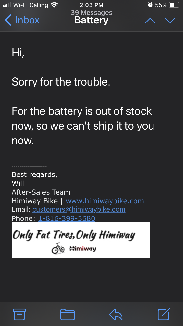

I'm the person with the malfunctioning Himiway battery that PedalUma referred to in the previous post. I've had my bike for 3 moths and have ca. 70miles on it. The battery is not charging and the bike display doesn't turn on when the battery is connected to the bike. I've been in contact with Himiway for over a week with 18 emails to date seeking warranty battery repair or replacement. Himiwaysays there are no batteries in stock (perhaps by August!) and asked me to have a "local" bike store examine and repair the battery and then they will reimburse me for expese. I can't find a San Fran bay area bike shop that is willing to examine my battery (I've called >3 in Sonoma Co.). At Himiway's request, my husband opened the case and looked for a replaceable fuse but couldn't find it (clearly no spade fuse as shown in a photo sent by Himiway). Himiway annotated the photo I sent of my opened battery and circled a part that, while it may be a device that sort of acts like a fuse, is not a user replaceable part. So I'm going to contact FTH and Hi-C (S CA and CO, respectively) to see if they will work on my battery. I do feel like Himiway has not been delivered on the 2 y warranty.

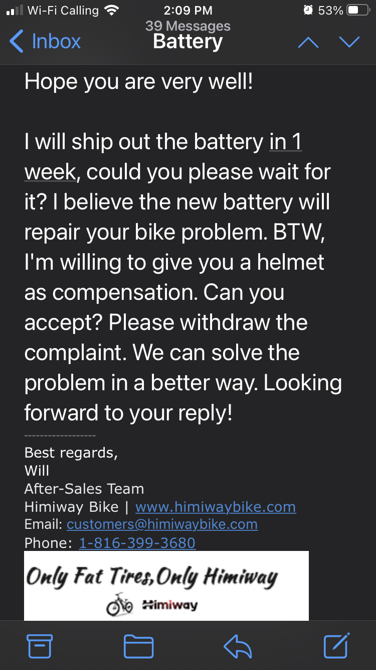

Oh, I absolutely will NOT attempt opening or taking the battery for repairs. I filed a complaint with my bank and Himiway asked me to withdraw the complaint promising to send a battery, but still have not. I’m requested a refund and return, but they are not complying despite the fact my request is within the 15 days. Meanwhile, the Himiway Escape is sitting and collecting dust.
Himiway is disingenuous in promising a battery because they do not have any. Your situation is not a one-off fluke. It is known. They were fully aware of it when they shipped the non-functional product to your door. Kindly post all communications or at least highlights. They like to move you to their private platform so others cannot see. Hush, hush. Working with your bank is the way to go.

Have the CC company withdraw the funds. This represents fraud in my view as an electric bike mechanic and not as a district attorney. Himiway has an EBR account and can see this.
