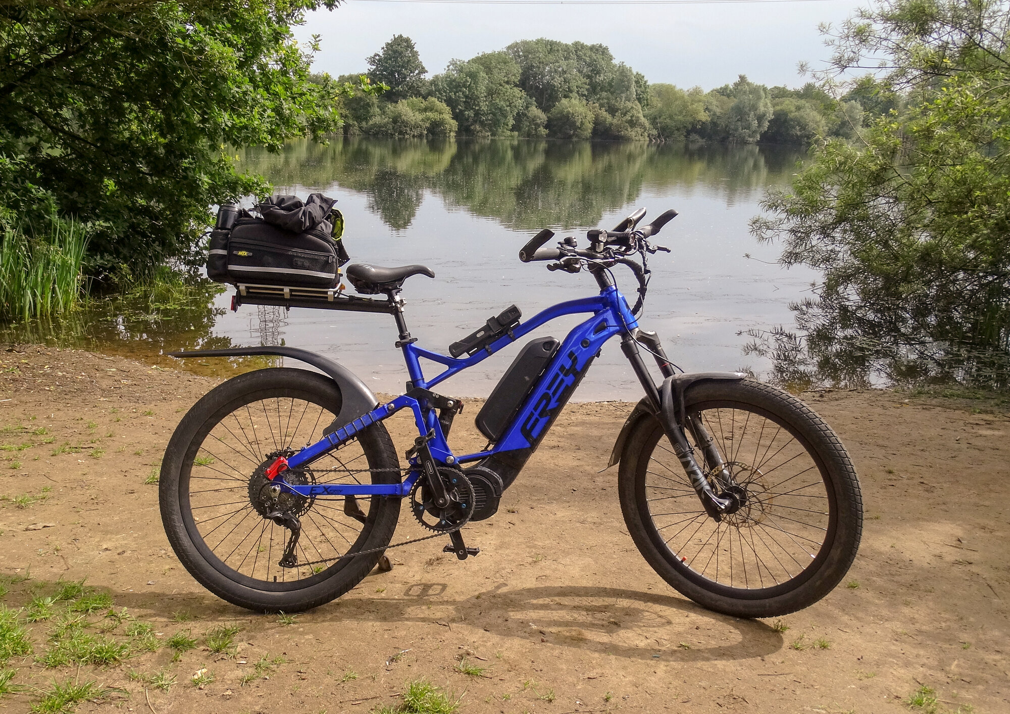

Ah, that's a thing of beauty. Is that EX blue different from their AM-1000 blue?
One thing bothers me: I'm always amazed at how flimsy the mounting options for bike racks can be.
In particular, that bracket-extending-from-seatpost arrangement like what you've got on display here, has snapped the shaft off its quick-release every time I've dared put so much as 5lbs in the bag... and this isn't even under hard trail use conditions!
The rear rack Frey offers for the AM-1000, seems to mount to the rear triangle, which grants plenty of opportunity to support weight better... but it also means the whole rack & anything on it become unsprung weight. That means the weight I put on it becomes multiplied with any bumps.
I'd love to find a bag\basket that secures to the front handlebars while resting its weight on top of the fork arch, just so there's some support besides a single axis at my bars! Most pannier, portier, & bar bags, seem to use plastic clips & even plastic mounting hardware.
Any tips on a really stout front & rear bag layout for a Frey?
Many thanks @ProphetZarquon !
I think it maybe the same blue or very close... if you ask Frey they will paint it in virtually any colour you want!
The rack I'm using in the photo is an Topeak MTX Beamrack (E-Type). It maxes out at only 9kg (20lb) so just enough to carry the essentials on a short trip - or 8 cans of beer! 😄 I've only recently purchased it so couldn't give you a full review but so far its working as expected, seems quite secure even off-road but do need to be mindful of its limits. Push too hard and you'll have the rack swinging around behind you! :oops::D
I have the EX Rear Rack too, which is same as supplied on the AM1000. It works fine but you're right about unsprung weight. It just makes the ride feel awful over rough ground. Best avoided if possible.
For the rare occasions I do need to carry a load I was looking to buy a Burley Coho XC Trailer. I liked the idea of spreading the weight over another axle, being able to carry bigger things, and hopefully it would be quick and convenient to use. Trailers are quite expensive though! 😞
