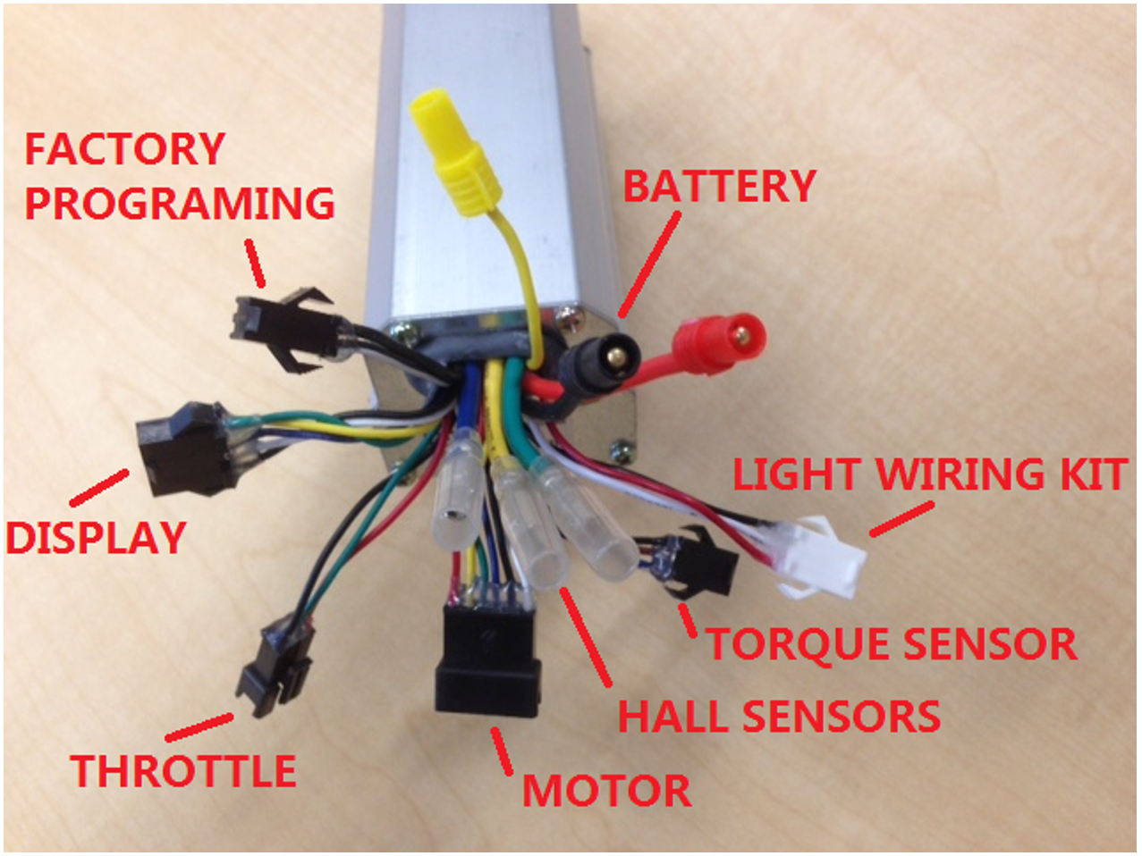

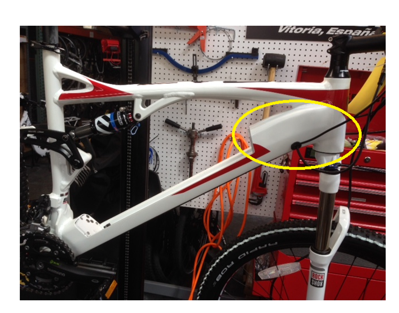

Get a can of CRC electrical contact cleaner from Lowes or Home Depot or other. Make sure the one you get states safe for plastics. There are 4 connectors in front of the handlebar, one small one for each brake cutoff, one larger one that unscrews for both the display and the throttle if you have throttle. Unplug them and use the CRC to spray clean each end real good. Let dry and reconnect them. Next is the motor connector under the chainstay, back by the cassette. Unplug that and clean with CRC. I would also clean the display pins and base.
If that doesn't clear the communication error 5, check and clean all the connectors of the controller.
The above is where the controller is located.
This is your controller. Not all connections are used on all models. Clean all and reconnect.
If all this fails you likely need a new controller or display.
View attachment 56434 The above is where the controller is located.
View attachment 56435 This is your controller. Not all connections are used on all models. Clean all and reconnect.

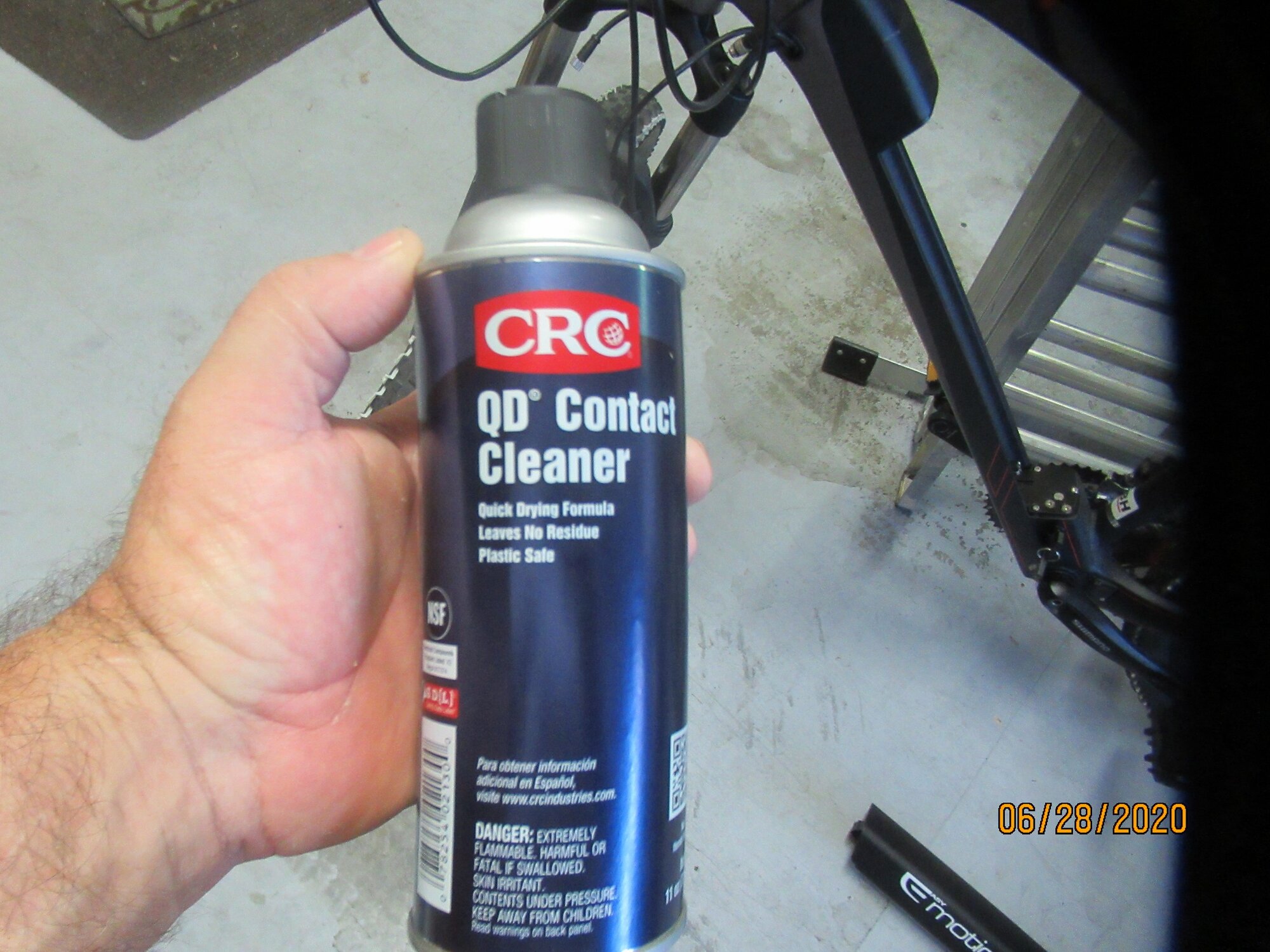

Ok, I sourced a can of CRC electrical contact cleaner (plastic safe). The battery was removed to prevent any issues with power while working on the bike and the

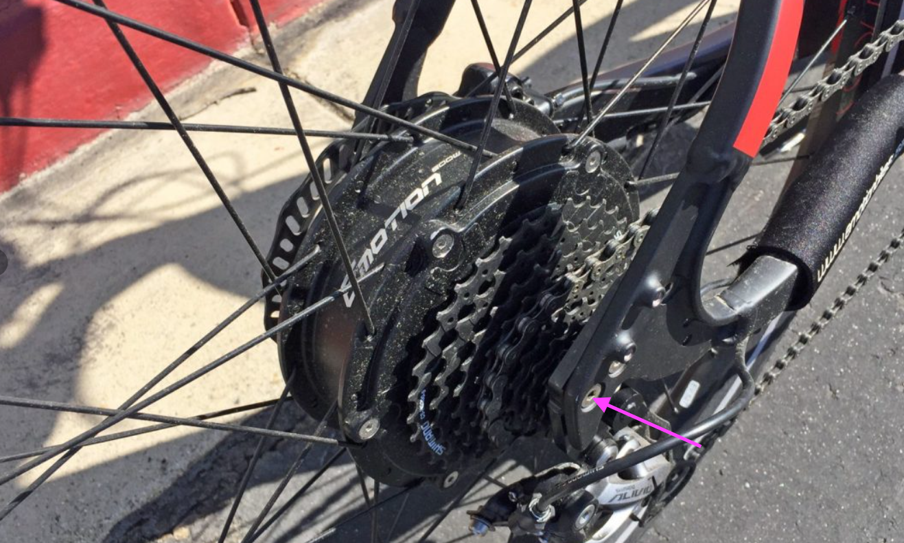

The motor connector under the chainstay, back by the cassette is of interest. It has long pins and a very tight connection, and is held together with some clips. The moment the clips were removed, the cable separated by itself. I may want to find a more secure way to attach this connection as it appears to be in constant tension. See attached pictures.
