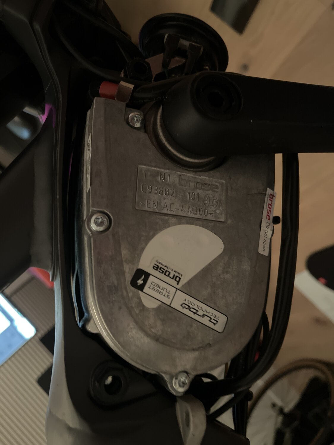

I have a Specialized Turbo Vado with a Brose motor and on this morning's commute the motor started making a fast clicking noise. Louder and not the normal electric motor sound it always makes. It was faster/slower with pedaling speed, and doesn't sound like the creaking noise I had before I performed the sequenced torquing fix. It made the same sound in multiple gears. It has about 1k miles (~300 of those I have put on it over the last 6 months).
After a mile or so, it went away on its own. We'll see if it comes back this afternoon.
Is this likely a sign of something like the bearings going out, that I can plan to do preventative maintenance on? I'm well out of warranty, but I don't mind opening it up and performing service if I can correctly diagnose it and get parts.
Your sprag clutch bearings are going.
This company uses performance line bearings and are located in Tennesse.
Awesome feedback thank you! I'll order a kit soon.
I think I spoke with this vendor when I first bought this bike used and had some questions.
Edit: After watching some videos on the process I'll probably just have them repair it. Looks like it could be tricky without the right tools to remove bearings.
