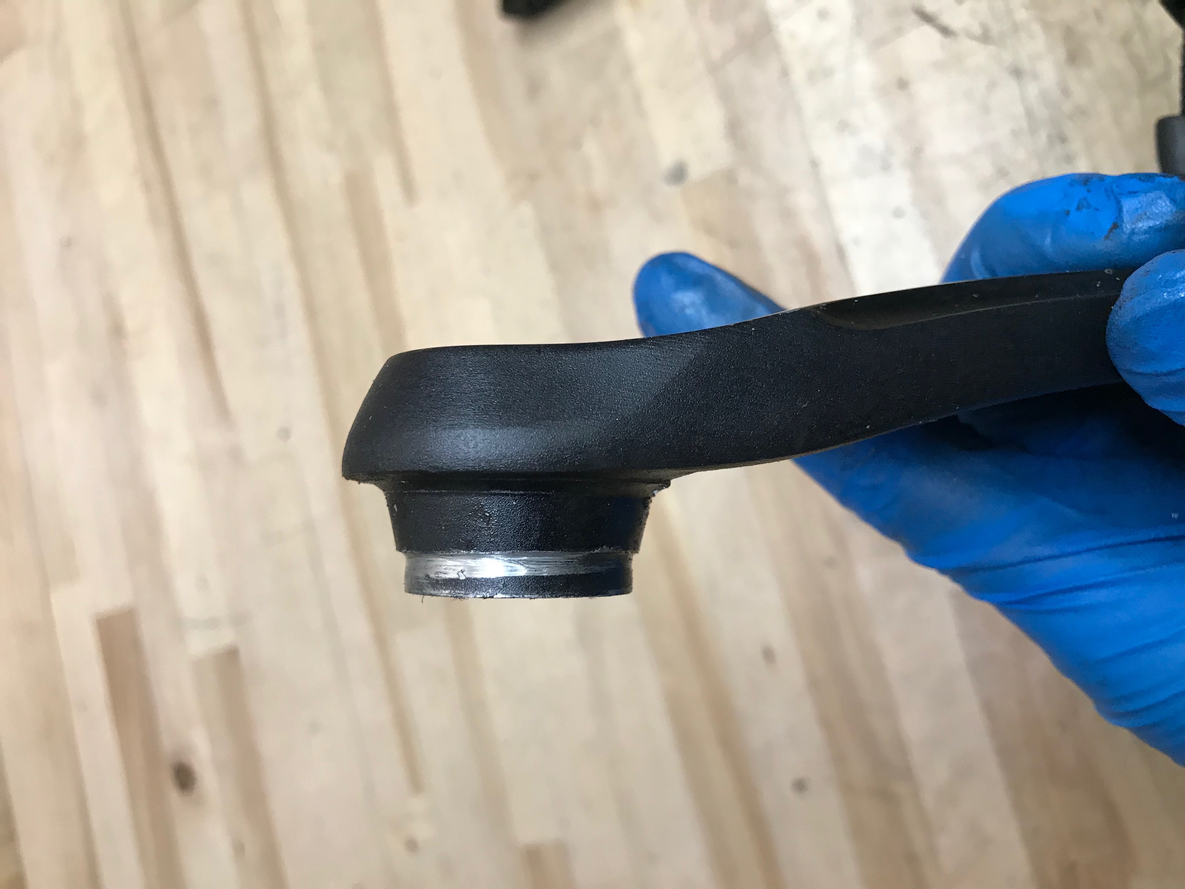

An issue that I have recently discovered is that over-tightening a crank arm bolt can lead to the crank pressing into the lock ring which is mounted on the motor's shaft. This pressing can lead to the lock ring breaking/snapping. See photos for reference.
View attachment 19047 View attachment 19048 View attachment 19049 View attachment 19050 View attachment 19051
Does anyone know the recommended torque? I recently tightened mine a bit because I suspected of a creak but it was irrelevant, now I'm worried.
