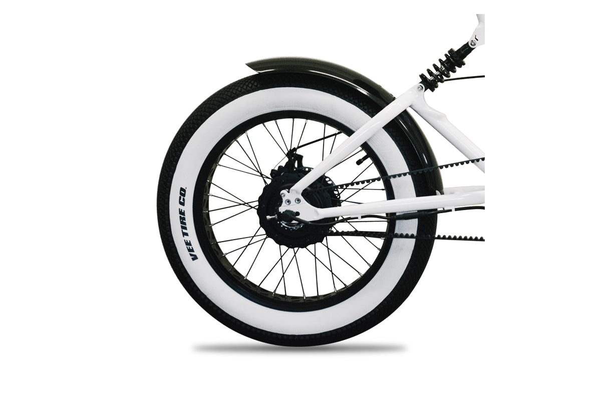

Special mention for these bad boys....
They do them in a white wall variant!!! A YouTuber has them on his XP. So badass.
