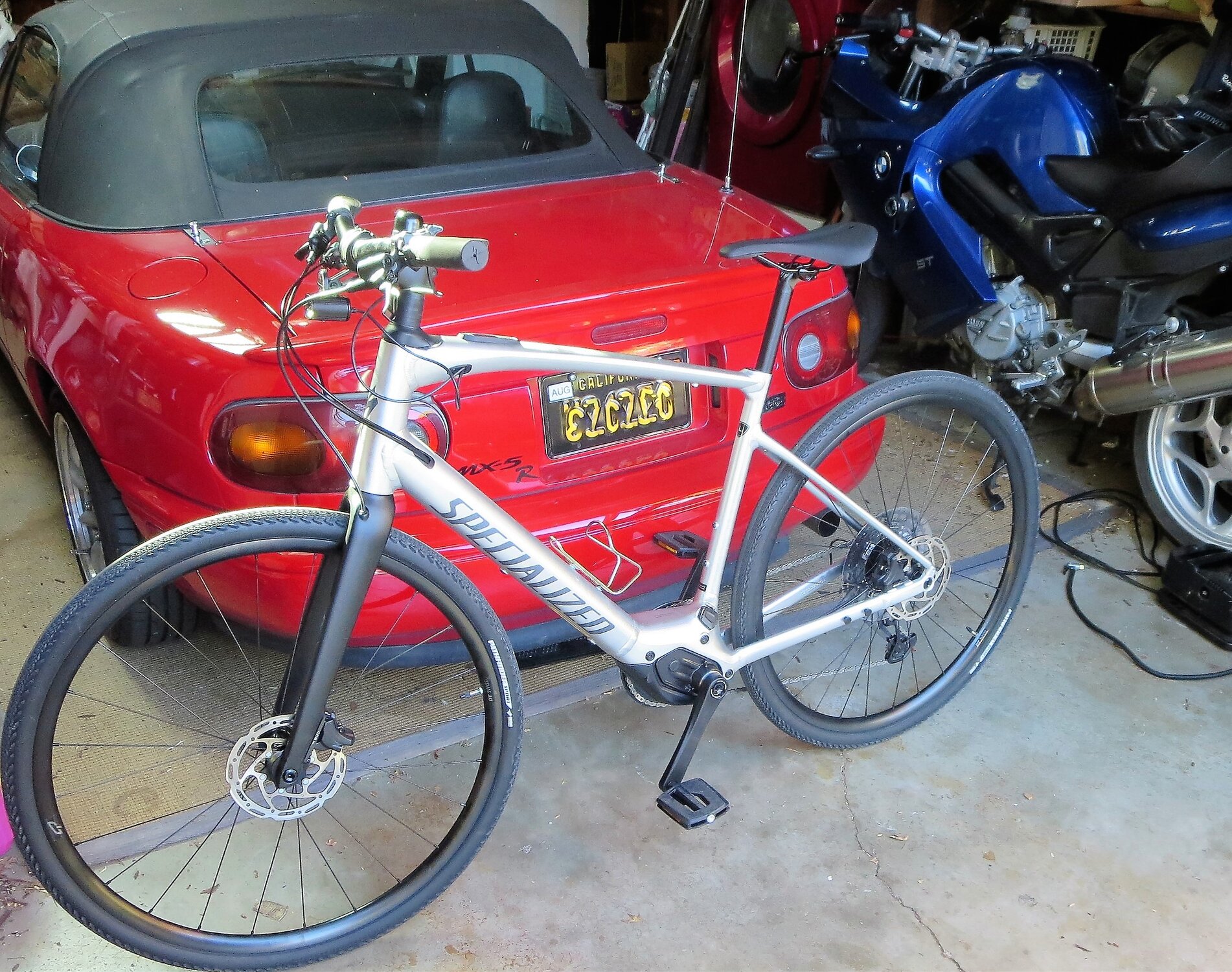

Took four months to realize that the fork harshness over larger bumps was due to none of the three helper springs included were actually installed on the bike by the LBS which is odd.
Took a little over five minutes to install the helper spring.
Loosen pinch bolts on steering stem.
Use your fingers to unscrew the finger tight cover on top of the stem.
Remove stem and attached handlebar and place carefully on front wheel, (used a bungee cord to keep it there).
Use an adjustable wrench to remove the cover for the spring compartment.
Drop in the spring, (I attached it to the cover for proper placement), and tighten the spring cover with adjustable wrench to "tight" but not overly so.
Replace stem/handlebar and align.
Replace stem cover with fingers.
Tighten pinch bolt on steering stem.
I used the medium spring (black) as the soft spring didn't seem to offer any resistance to even a finger squeeze while the hard spring only offered resistance.
I think that will take care of the harshness/bottoming out when going over such things as railroad tracks.

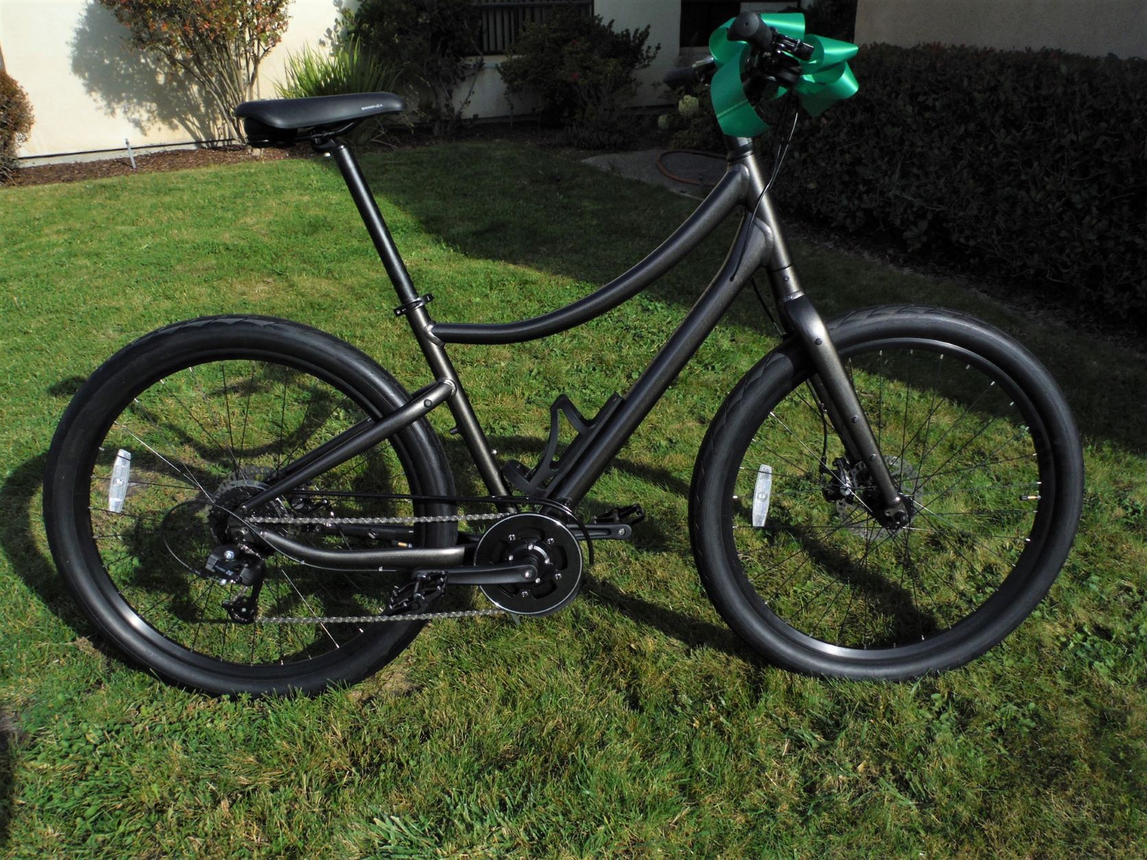

@GAJ, I made this one electric minutes ago. The battery is charging. It looks like a water bottle. The idea was to make a non-propritary, open source Como 5 that is more powerful and costs less to maintain. It is a 750W torque sensor mid-drive. The wires are thru frame. Before conversion it was a $759 bike at Mike's in Petaluma.
