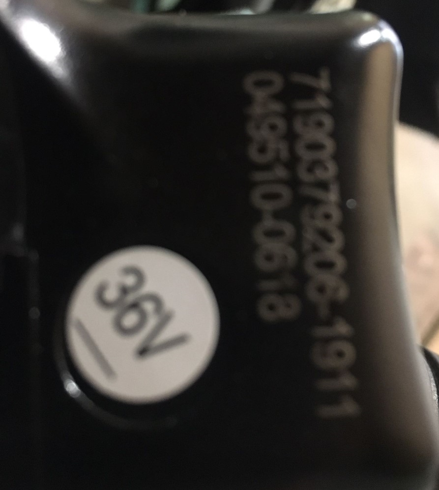

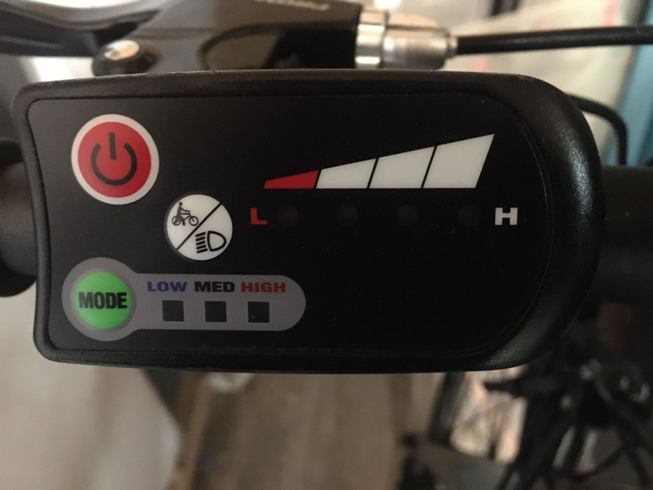

Hi all
My pal has recently purchased a genuine second-hand Ebike for £500, which I think is a bargain. The control unit that comes with it didn't have any instructions. Can anybody identify it? I suspect that because it has no manufacturer ID it could be a generic/Standard item?
Any ideas guys?
Thank you.

So you upgraded the display? Or you found settings in the display to "upgrade" performance?
Google is really quite easy. For example, all I did was google "eBike displays".
I clicked on images and looked until I found an image very close to yours and clicked on it. From there I saw it was like a KT880, but was slightly different, so I googled "ebike KT display".
Again went to images and found the exact one. KT 790.
Again google can easily find ANY manual these days. Simply google...
KT LED 790 display manual
Just to avoid confusion, which motor is this? Did you make changes to your controller or through the display? Do you have the same display and controller motor combination?
I looked at the manual I found and the 790 didn't appear to have many changeable settings beyond 3 modes by way of the display. Honestly, I got stumped by their reference to the RFID card in one version of the manual..
@harryS HELP!!??
I don't think there's anything you can do with a LED console other than hope the PAS levels suit your riding style. Often PAS0 is set too fast for most people, but this unit claims to have four levels, so maybe that allows their PAS0 to be slow.
Sometimes, on the controller there will be a single wire that comes out and connects to another wire of same colour going back into the controller. That may be used for a speed limiter.
