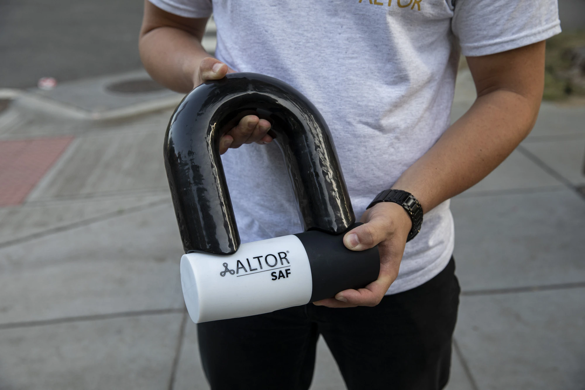

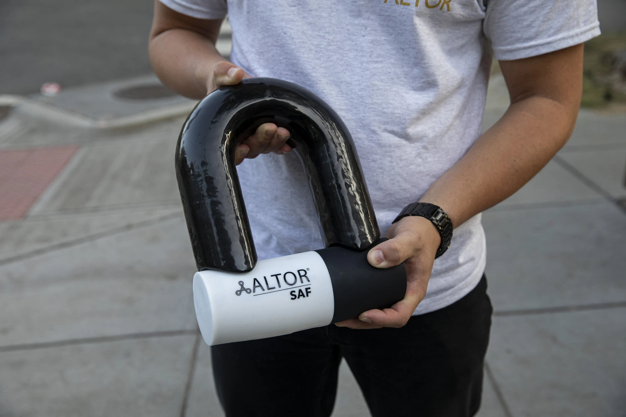

Wants a lock made of this stuff:
I always check this guys channel after seeing a lock that looks cool. This video is a good start, it's his own setup.
And he does some very good destructive testing videos as well that show the inherent weaknesses of pretty much every common design. I don't stress about the picking on complex keyways, as few thieves go that route when the destructive option is so damn fast and easy.
And he did discus that gigantic Altor. I would need a dedicated pannier just to carry it! lol
