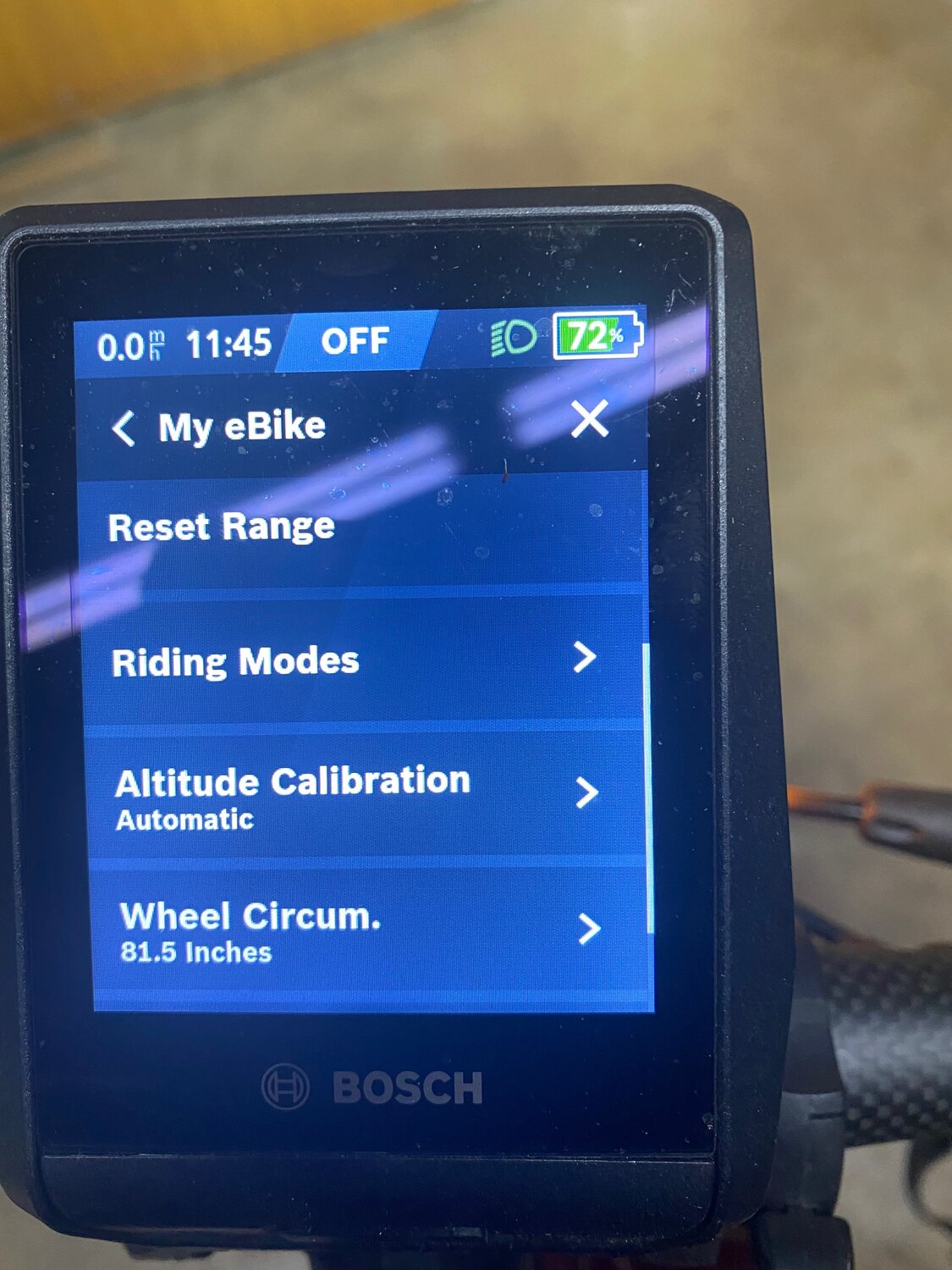

you can fix it easily
interesting - this doesn't require a reset/reflash at the bike servicing level?
no but it is limited how much you can change it. but I hve done it several tiems. my trek seems pretty close as is according to a roadside speed sensor.
what screen / onboard controller and motor interface does your trek have? wondering what screen i could find this in on my nyon if at all?
its the same for gen 2 and 4
I tried changing the circumference setting on my Gazelle. It seemed to me that it didn't fully correct the displayed speed (still showed 1 or more MPH faster than was showing on my Garmin Oregon), but it did change the odometer reading for trip milage compared to what the Oregon recorded. I put the circumference back to the setting that came from the factory which seems to track pretty consistently with the Oregon's odometer, and just decided to live with the inflated speed display.
