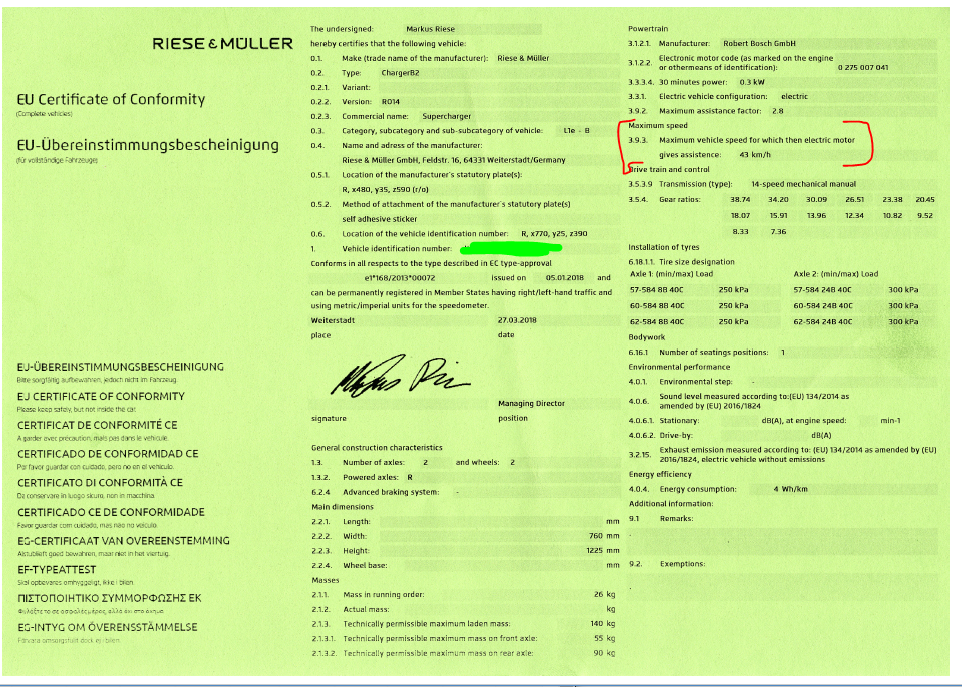

Short answer: Yes, the Bosch speedo is showing faster than actual speed.
There is a long thread over at the German pedelec forum of this same subject.
Many are disappointed that their speed pedelecs that are supposed to assist up to 45 kmph cuts out already at 43 kmph while the display is showing 45 kmph. This is consistent with my experience of my Bosch Speed motor.
Real speed measurement can be done by any GPS device.
Funny thing is that the European type approval certificate (Certificate of Conformity) clearly states that the motor assists up to 43 kmph.
The odometer and average speed seems to be accurate by all measurements I've made.
So the Bosch system clearly measures speed accurately but is programmed to show it incorrectly on the display.
@tompat - you folks are AMAZING at your ability to dig up the good stuff. This post in and of itself, says it all. Does anyone think this creates false advertising? What is the financial benefit or legal benefits to fudging the numbers?
Guess that Bosch is doing this to keep things on the safe side of the limit. Let's say the bike was on or slightly above the 45 kmph limit they'd have a hard time in court if a bike was in an accident and the reason had anything to do with speeding.
A small number of users are disappointed with this.
Personally, I don't care, 43 or 45 kmph is almost the same. Pushing near the top speed requires a lot of effort anyways so I'm very seldom at those speeds. Normal cruising speed for me on flat terrain with no wind is about 35-40 kmph (on Bosch speedo.. ;) )
My average speed over an hour is 32 kmph which is satisfactory for me and in line with what I expected. I make my 32 km commute in less than one hour which was my objective when I bought the bike.
Enjoy your bike and don't worry too much.
