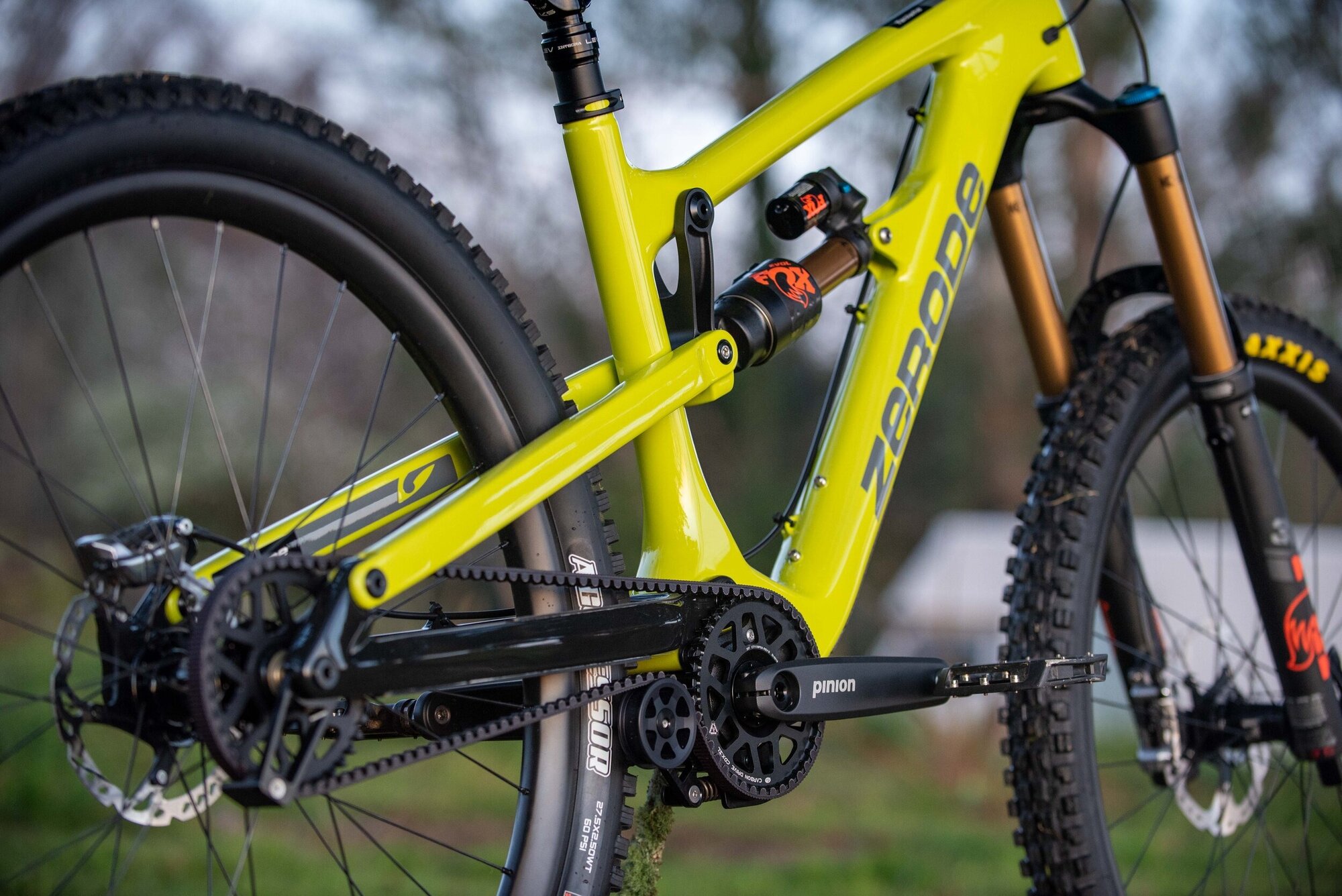

The pinion bike is definitely on our radar and our manufacturer has great experience producing Pinion frames for companies like Zerode, which produces some of the finest full-suspension + Gates belt + Pinion bikes in the world.
