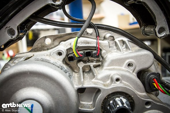

Most detailed instruction with pictures are given here: https://www.emtb-news.de/news/en/workshop-install-lights-bosch-e-bike/
The two empty ports you see in this picture are designated for front and rear lights.
