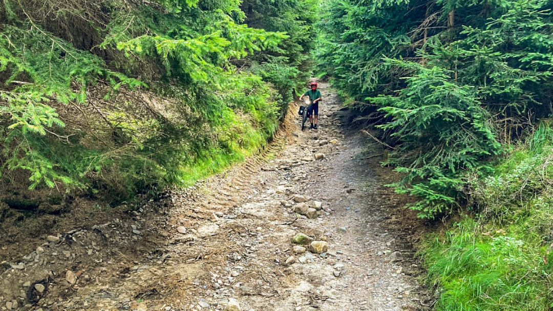

I didn't. Instead, I use 1.75" tyres instead of the 2.0" specified for my Vado. Best pictures:
A fast descent. That was the moment I discovered the handlebars turned a little...
A 17% grade max, ascent on pebbles. That was a hard one.
Never, I said "never" try riding on rocks like those. Unless that is an MTB, frames tend to snap there. @Dallant: That was above my pay grade... :D
