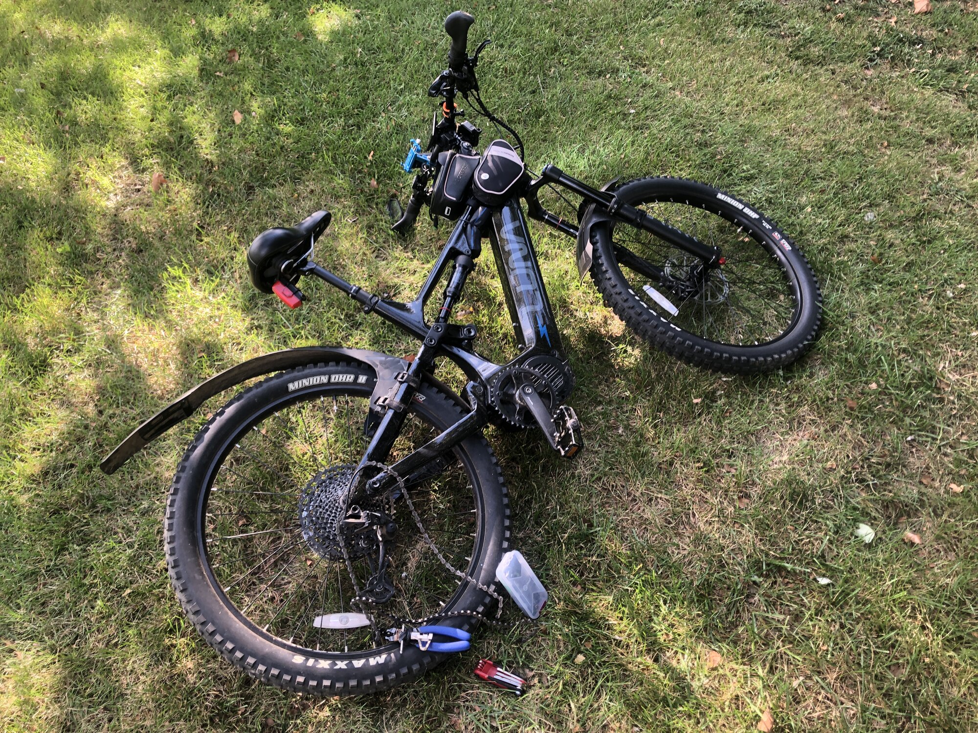

Running hard up a 45 degree hill, shifting on the fly, found my weakest link. I've got 1,400 hard miles on my Z1 since mid June. Glad I had the tools with me and it only took 10 minutes to pop the link and add a new one. Needless to say, I rode home a bit slower and more gentle. Maintenance time!

Very nice bike! This reminds me I need to double check and make sure i still have a chainbreaker and spare links in my trunk bag!
I’m glad that you shared the details and a picture or the carnage.
I have had to use a chain breaker 3 times on rides, (the first was because I broke off a rear derailleur with a mistimed downhill log hop, and twice because of broken chains). I regularly clean, lubricate my chains and inspect my them with a Park “stretch” gage, but sometimes a mechanical part will fail anyway.
A worn chain will also be less efficient and prematurely wear your chainrings and cassette, so it can be economical to change the chain before it gets too worn and always back off the power during shifting.
Yeah, just before I left for my ride, I thought "I should check my chain stretch, and it's probably time for a new chain".
Yeah, it's time.
