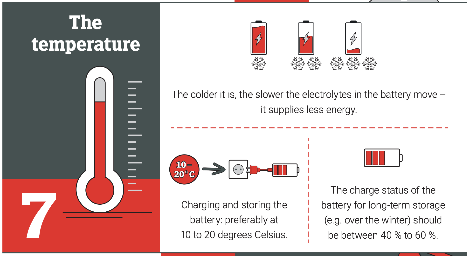

By UN3480 shipping regulations, lithium batteries must be shipped at 30%. They may sit in warehouses for months like that, Your bike battery should be fine if you put it away anywhere between 30%-60%, or even higher, but storage at 100% in hot climates is known to degrade capacity.
They're allowed to go down to around -13F too, so mine stay in my unheated garage,
From Stromer range efficiency guide
