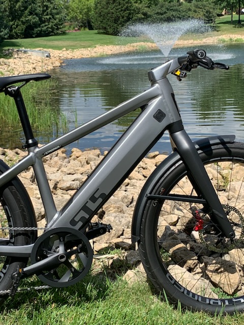

I would suggest that the R & M owners at least check out Stromer when they are looking at buying.
The Stromer ST5 and new (revolutionary? ) ST7 have some great designs and ultra premium components.
If you want a speed commuter with superb battery range, you should at least check out Stromer.
