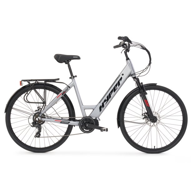

walmart now sells a Hyper ebike with mid drive for $1398. The walmart description is lacking important specifics, I'm curious if/when it gets reviewed. Personally I'd convert a bike with a tongsheng tsdz2 instead but someone looking for an inexpensive mid drive might be interested.
nice, what motor is that??
The display has Ananda markings. No performance specs on the Walmart site nor the manufacturer's site.
But, Ananda is used on gotcha bikeshare bikes so maybe durable?
I like the concept. It might be a good option for a budget conscious person who isn't going to kit a bike and doesn't need massive range or power (assuming the usual Hyper 36v 7.8ah battery and undisclosed motor power ratings). Looks like a functional bike with advantages of a mid drive at just a few hundred above the price of a hub motor bike. Having fenders and a rear rack right out of the box means no fussing around adding those accessories.

80nm same as tsdz2, could be impressive. Needs a review.

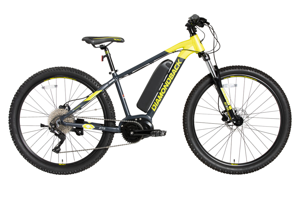

With that battery capacity, I am not sure if it's a good deal.
Not bad, but not sure if it's THAT good.
For example, Diamondback Powerline can be bought for $1949 Canadian ($1565 US @ today's rate) but looks like you could get one as low as $1619 Canadian ($1286 US @ today's rate).
The Diamondback comes with 36V 10.4Ah battery.
That Diamondback looks like a deal if you can actually get it at <$1300 including shipping. One thing that is often overlooked with Walmart bikes is that they have a very generous return policy. I think 30 days for any reason, additionally an additional 4 year warranty is only $77. Where else could you get a mid drive, torque sensing bike at anything near this price that you can return to your local Walmart if you find you don't like it for any reason.
As for the battery, I've ridden over 50 miles on a tongsheng equipped bike on a single charge of a 36v 10ah battery and I ride in a very hilly/mountainous area so it all depends. I think I read in this thread that a replacement battery is only $200.
To me the biggest drawback of that bike is the suspension fork, I had a similar fork on another Walmart bike that I replaced with a suspension corrected steel fork for a better riding experience and shaved a few pounds off of that bike. I'd take a flier on this bike if I had a use for it, unlikely but I might as a bike to leave at my son's place in Texas so I can keep up with him on rides.
