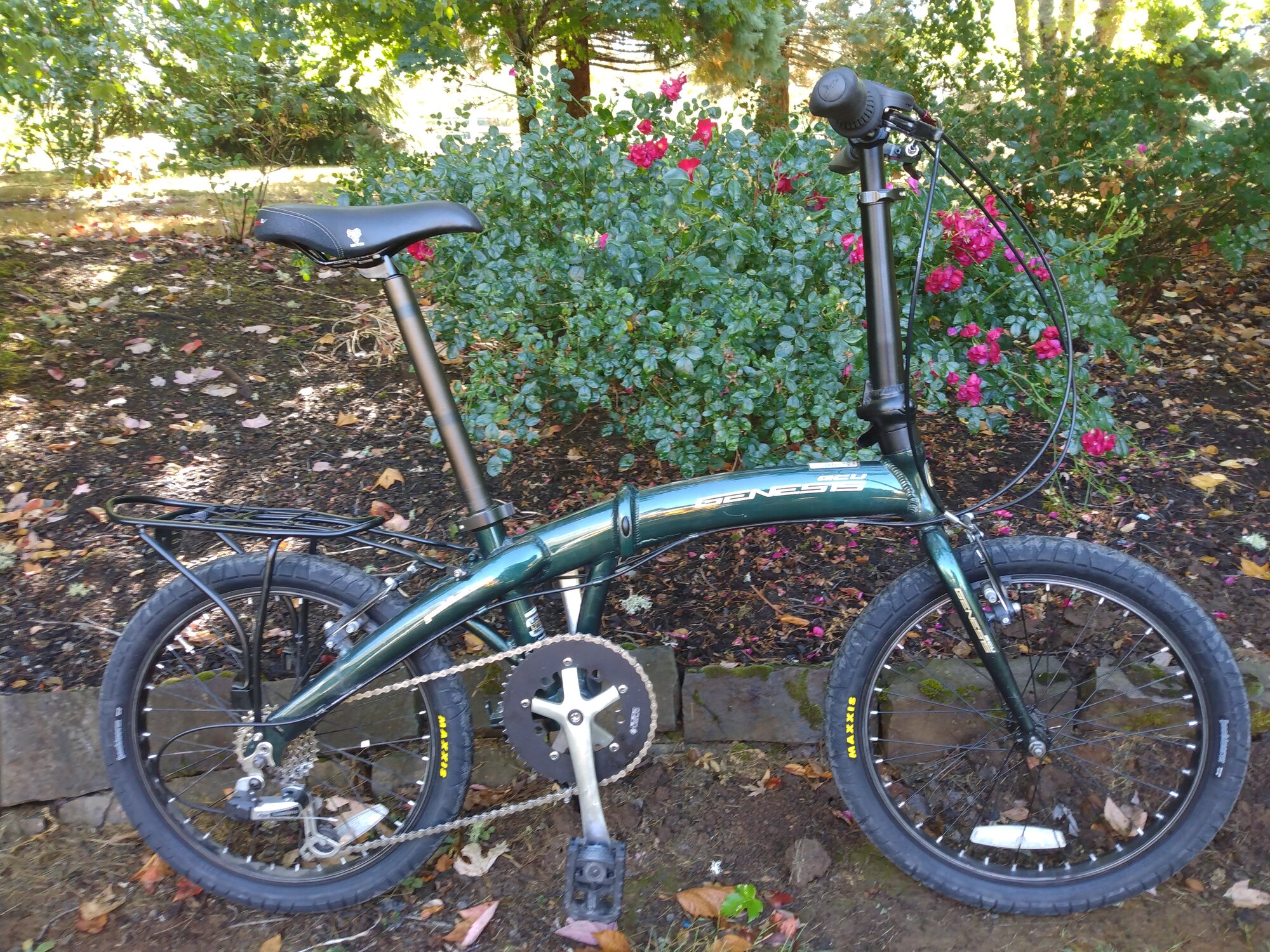

I'm hoping to ride around Crater Lake again in 1-2 weeks during the "ride the rim" east road closures. Last year I rode around it 3x on closure and non-closure days with a TSDZ2 equipped Walmart Schwinn Avenue hybrid. This year I'm planning on bringing my BH (Yamaha) gravel bike and this Walmart Genesis 20" folder with my 48v 750w TSDZ2 which is currently sitting on a shelf.
Current weight is 28.2# (was 26# without the rack and with lighter tires than the Maxxis hookworm 20x1.95 on it now).
I have had a this as well as a couple dahon bikes for several years and feel that the Walmart bike is comparable quality at a much lower price.
