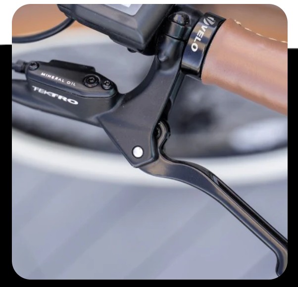

Friends,
I have 3,000 miles on my 85-pound ebike with Tekro Hydraulic Disc Brakes.
I'm on the third set of disc brakes, installed professionally at a LBS, but have never drained/refilled the 'mineral oil'.
The LBS bike mechanic (not focused on ebikes) said they don't generally get involved with draining/refilling the mineral oil.
How would we know if it's necessary to do this?
BTW, according to the web, ‘Mineral Oil’ is a vague and unregulated term that doesn’t refer to one specific fluid.
Does anyone actually have their 'Mineral Oil' actually changed when getting new brake pads?
Thanks!

no and even then you don't change it out. you bleed them pushing the old oil out but usually not all of it. but you only do it when you start getting mushy brakes usually you can go years between having to bleed them unless you screw something up.
My LBS bled and replenished my Magura hydraulic disc brakes. Strange that your LBS won't get involved with this aspect of bike service. Maybe find a better LBS. You know it's time to bleed and replinish when your brakes feel mushy and there is excessive travel of your brake levers.
