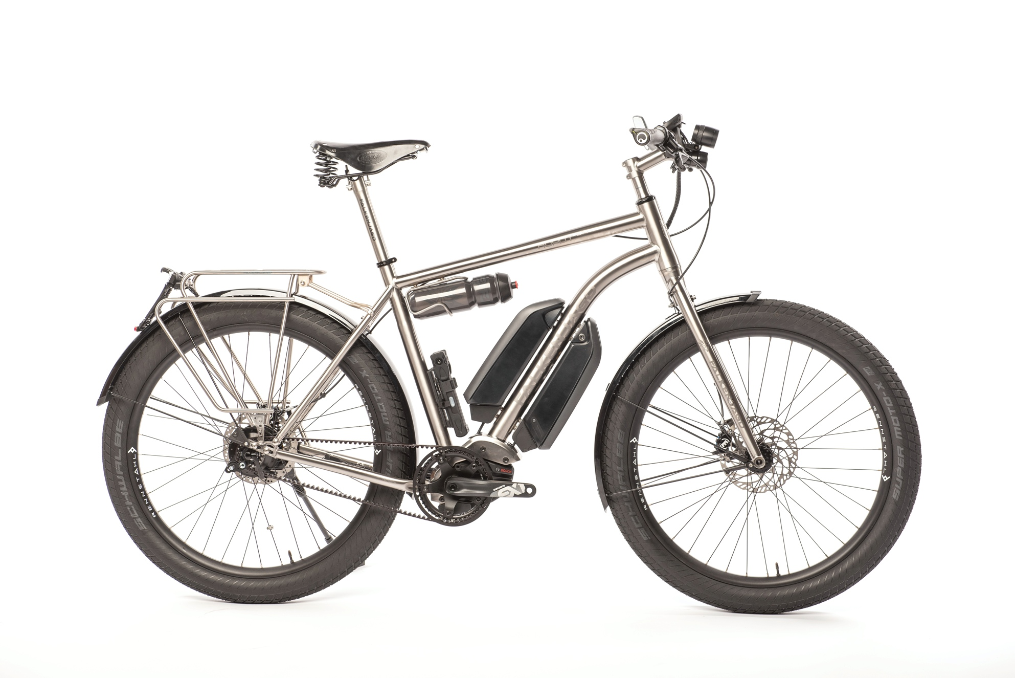

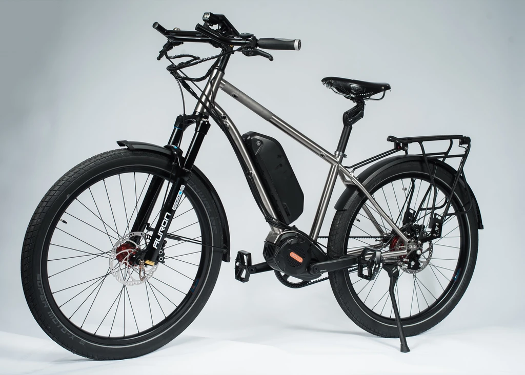

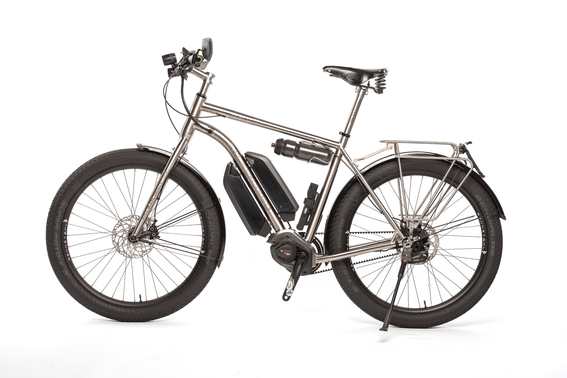

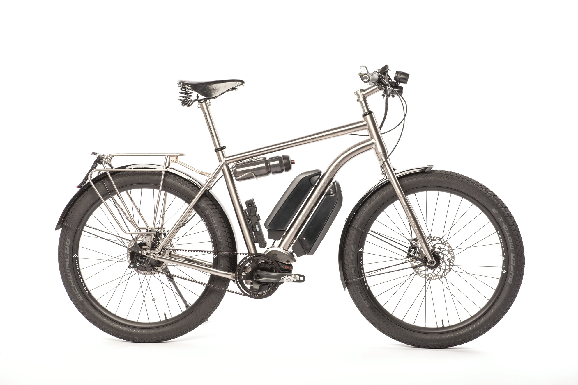

Questions? Yeah, like how much for starters? I´ll wager it´s at least 5 times what I paid for my bike. The spokes look kinda wimpyFront fork mounts? Manual Rohloff option? Tire width, looks tight with the fenders/mudguards?
Questions, questions!![]()
Over the years I have had several Ti bicycles including a tandem. One of the first Ti components I had was an IRD Ti fork and while cool it was pretty flexy and didn't live too long on the steel hard tail I had it mounted on at the time. Visible flex while braking, using V brakes that provide braking force much higher up than disc, was more than I could handle. It did help provide a supple ride quality though.
To that end to me using Ti for a bike like this, while cool, would not be my first choice especially the front fork which seems severely under spec to me. Disc brake forces on that skinny a Ti tube on such a heavy bike, I would suspect that bike is over 60lbs. before strapping on any touring gear, would scare me away based on my past experience.
The Ti tandem we had even with oversize tubing was very "whippy" and some that rode it even went so far as to say "noodly". It had a stout sus fork on it so that wasn't the issue Ti just inherently has more flex than Alu/Carbon as a frame material which is why it can be popular for ride quality but not what I would recommend for potentially heavy bikes like the above. YMMV of course but I for one will pass on bikes like this.

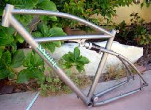

I agree that getting Titanium done right is a bit of science and art combined... when it is dialed in, the magic carpet ride begins.Over the years I have had the good fortune to observe a few frame builders that work with Ti at a very high level. The most time spent with this guy in CB, CO that had a company name of Willits. View attachment 70241

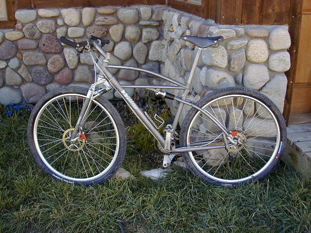

I rode alot of his bikes bitd, primarily the FS version which was built for me, View attachment 70247
and listened to his speal on the benefits of Ti construction many times over the years but the general idea that I got from him was that Ti as a bicycle frame material was most beneficial for strong, light and compliant frames and if anyone came by looking for something beefy, for say loaded touring, he'd talk them into steel. Unfortunately Wes was his own worst enemy and drifted off into obscurity to battle his demons.
I 'm not trying to say that it can't be done as the one you list and in fact many will buy into it and have a great time and I wish them well.
A Beautifully designed Ebike... for a moment I thought you had posted a WattWagon Ultimate.
Okay, better with a suspension fork & thud-buster, but not any cheaper![]()
Ultimate Commuter Pro - Titanium (Out of Stock)
Ultimate Commuter Pro is the best in class, precision engineered, titanium ebike based on the Bafang Ultra . The Ultimate Commuter Pro is a virtually maintenance free ebike. Now with the Archon X1 controller to give you power up to 3000W ! Ultimate Commuter Pro is revolutionizing ebiking for...wattwagons.com
