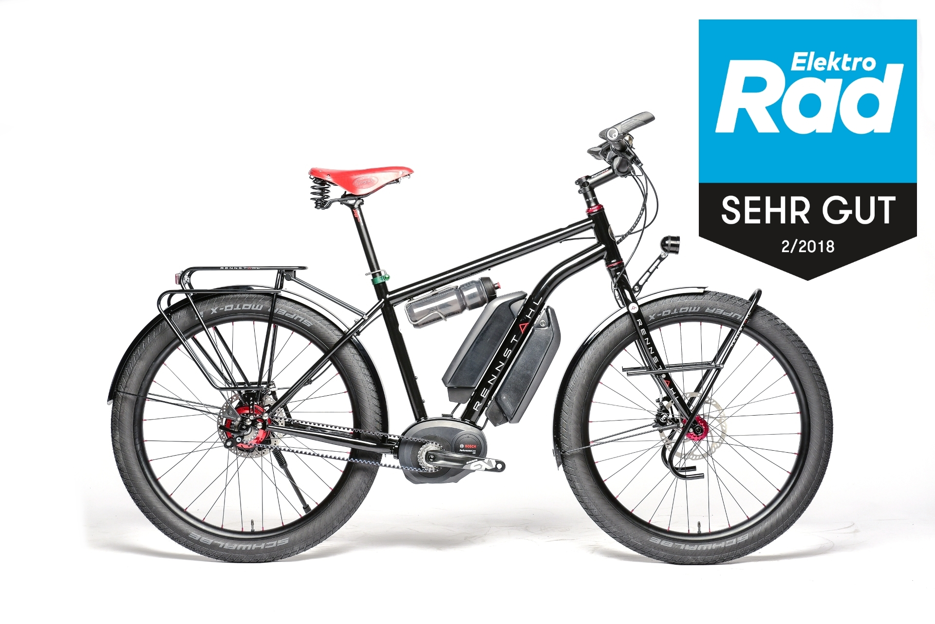

I agree this would be the ideal touring ebike. Unfortunately there is no North American dealers. What do you think of the Rohloff R&M Supercharger?
This is specifically built for touring application, with extra sturdy steel frame and burly dropouts for heavy load carrying capability. Everything on that bike is low maintenance. When it comes heavy loads and touring, steel or titanium has a slight edge over carbon or aluminum.
BTW, they ship worldwide.
R&M supercharger is a great bike and would come second to this bike. The front/rear racks on the Supercharger are not touring grade and it could use slightly brighter lights like the M99 but overall it is a fine machine.

The Rennstahl looks really promising and I might consider that bike if I were purchasing a touring rig today. Although I'd really like the option of a Utility Fork (perhaps the Surly Troll or Endpoint Hunter Gatherer) over the admittedly nice fork on that bike.
