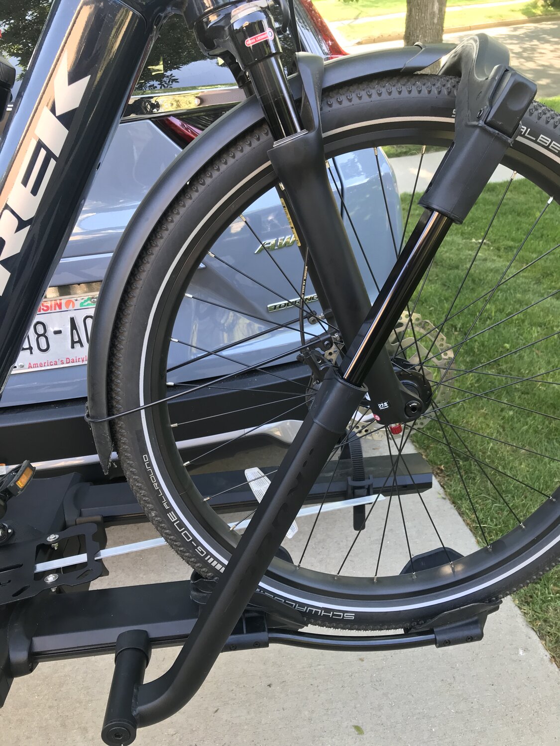

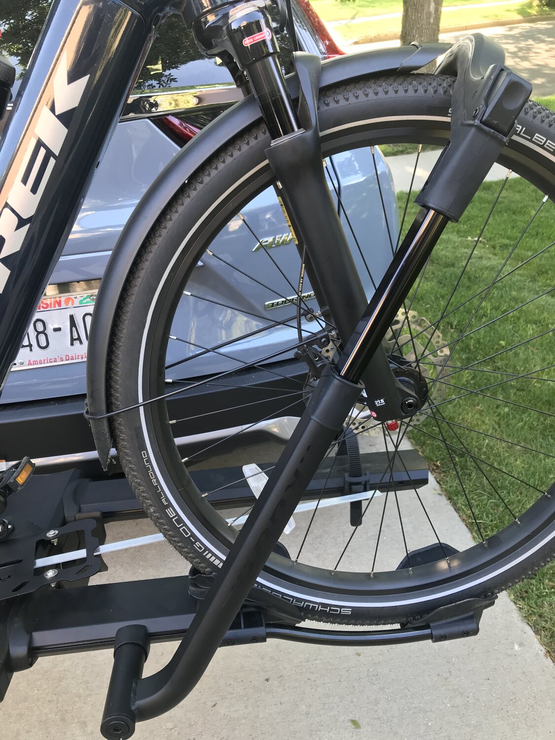

I use the Thule Easyfold on my Nevo 3, which has fenders and is heavy. It works very well and Thule stood behind their product when I had a problem. The clamp fastens to the seat tube and holds it securely.

We sell the Easyfolds too, personally I transport carbon bikes too and there ain't no way I'm clamping down on a carbon bike. Also I prefer to have the rack fold flush with the vehicle, IMO.

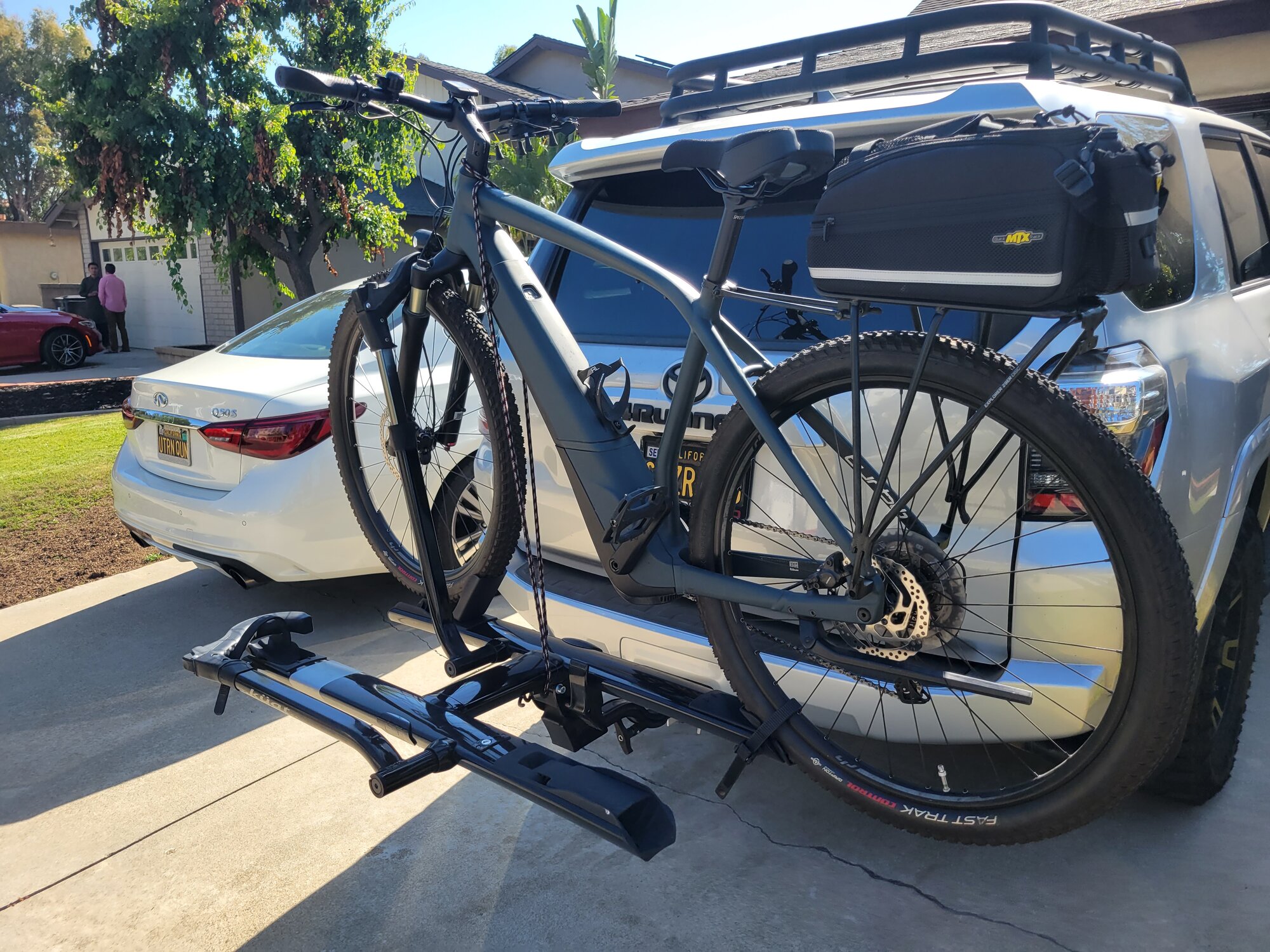

i use a Kuate Sherpa 2.0 and works great for me but i ride a Specialized Turbo Vado & vado Sl. The rack weight limit is 90 t0 100lb

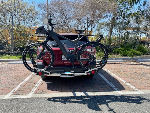

I use a Quikrstuff Mach 2 for my Delite. It works fine with the rear fender. The cross bit thingy can be adjusted to tuck up a bit underneath it and it's totally secure. For extra-safe backup, get one or two of the locks they sell with it (they go through the wheels and the bars).
Looks like they have a 6-week backlog on orders, but it's less than I waited for mine. The thing is so easy to put on and take off, no tools needed, and it folds up easy to store in the box it came in. I love it and it was worth the wait (and the price).

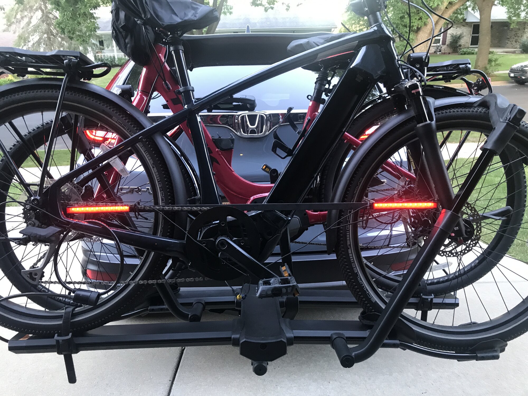

My Kuat NV 2.0 works great with fenders. Have traveled cross-country 4 times. Easy on — easy off. Very stable.
.View attachment 154933
That's exactly how I travel with my fendered bikes but it's worth mentioning that you'll want to run a strap around the "hook" and rim as well as the wheel and wheel tray to prevent the wheel from "walking" in the tray and potentially letting the bike fall off.
All that said the Piston Pro is better in every way.
No argument from me. Kuat’s Piston Pro was not available when I bought my NV. I suggested to Kuat for 2 yrs to add lights but they said no. But now they do. I added my own light bar.

Looks very similar to my 1up hitch. Simple, strong and made in the USA!! I think the Quickstuff racks are a little more $$ than 1 UP if I recall.
Yes, Quikr one was invented by the same guy who did the 1Up - and yeah, I think it's a bit pricier too! But there are some nice tweaks he made to his design that could be worth it.
