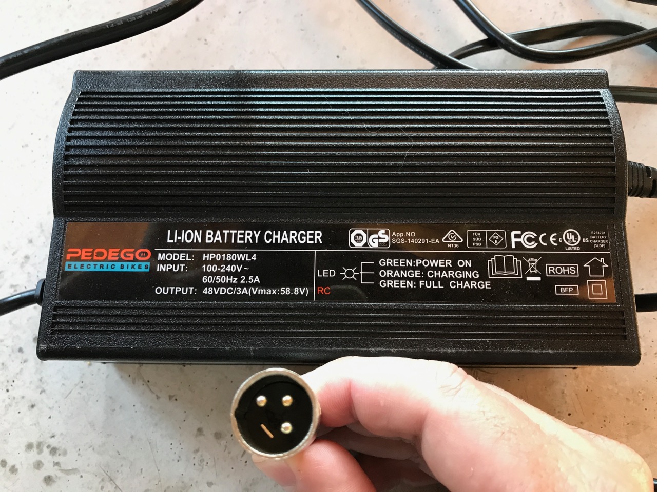

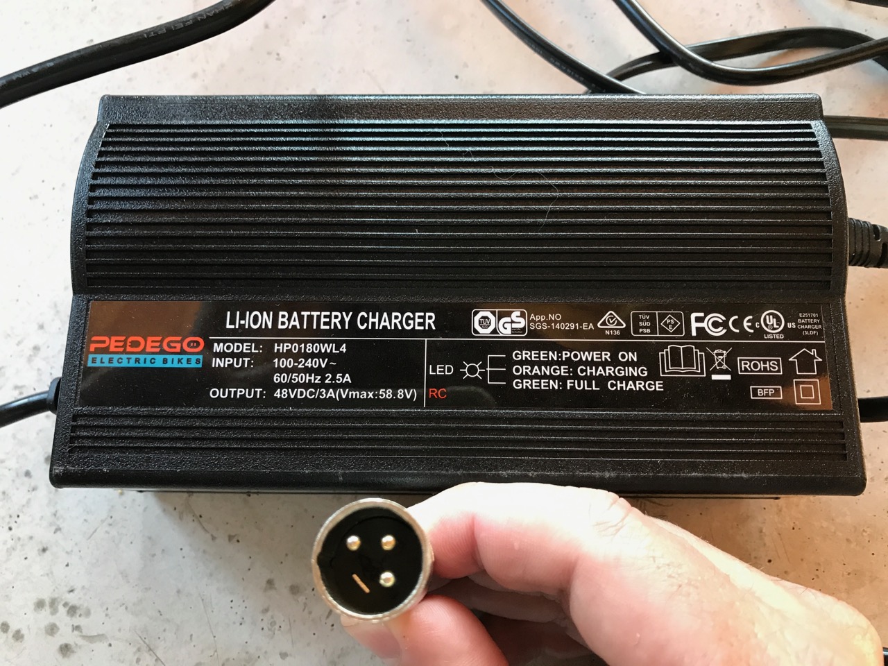

So, has anyone here used a Satiator with Pedego batteries? Will it work without creating a fire hazard or damaging the battery?

From the pictures of the Satiator I think that is a standard connector.
If you google the model number you'll find that charger is used by other vendors. Golden Motor is one. You are goo to go! Just send the photo to [email protected] and they'll take great care! I'm certain you're good to go but they will be your warranty. By the way, I just added my second charger from them. I can't be more pleased.
