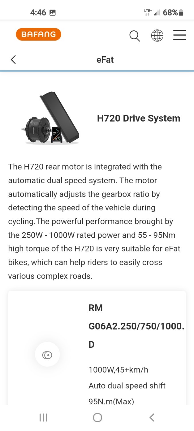

@PCeBiker , I think the Bafang H720 rear hub motor with IGH has only an automatic 2 speeds. Not that that’s bad. But, I don’t see any rear hub motor with 5 speeds. The documentation that you pointed at earlier (for Bafang’s G500A) showed a 5 speed gear hub, but it’s not a motor. That appears to be only usable with a mid-drive motor through the chain/belt.
Again, I could be reading this wrong, but maybe Bafang is working on something like that. It’s not part of their HR series of motors (yet).

This one is definitely a geared hub 2-speed motor,..

Bafang IGHs do not have input for electricity. There is no wire. They are meant for mid-drives. Something got lost in translation. The position is rear but it is not a motor.
@PedalUma , I think that the H720 is a rear motor with (automatic) two speed IGH, a.k.a. a two-speed “GVT” (gear variable transmission). Although you certainly might be right that the translation is cocked up here. But, it sure looks like a motor to me, and clearly there is no cassette attachment like there is on mine.
@PCeBiker I think your first picture and last picture in that post are of the same (H720) motor/IGH.

There is at least a Bafang 2-speed geared hub motor,..
I got all mixed up looking at the two pictures from AliExpress.
The bigger version looks like a fat motor.
I guess it's just a fat gearbox? 😂

The H720 is a 2-speed IGH hub motor that only accepts a single sprocket (or a pully for a belt.)
It's got the same G06 series fat bike spacing where that single sprocket won't be any further out than my high gear on my current cassette,..
