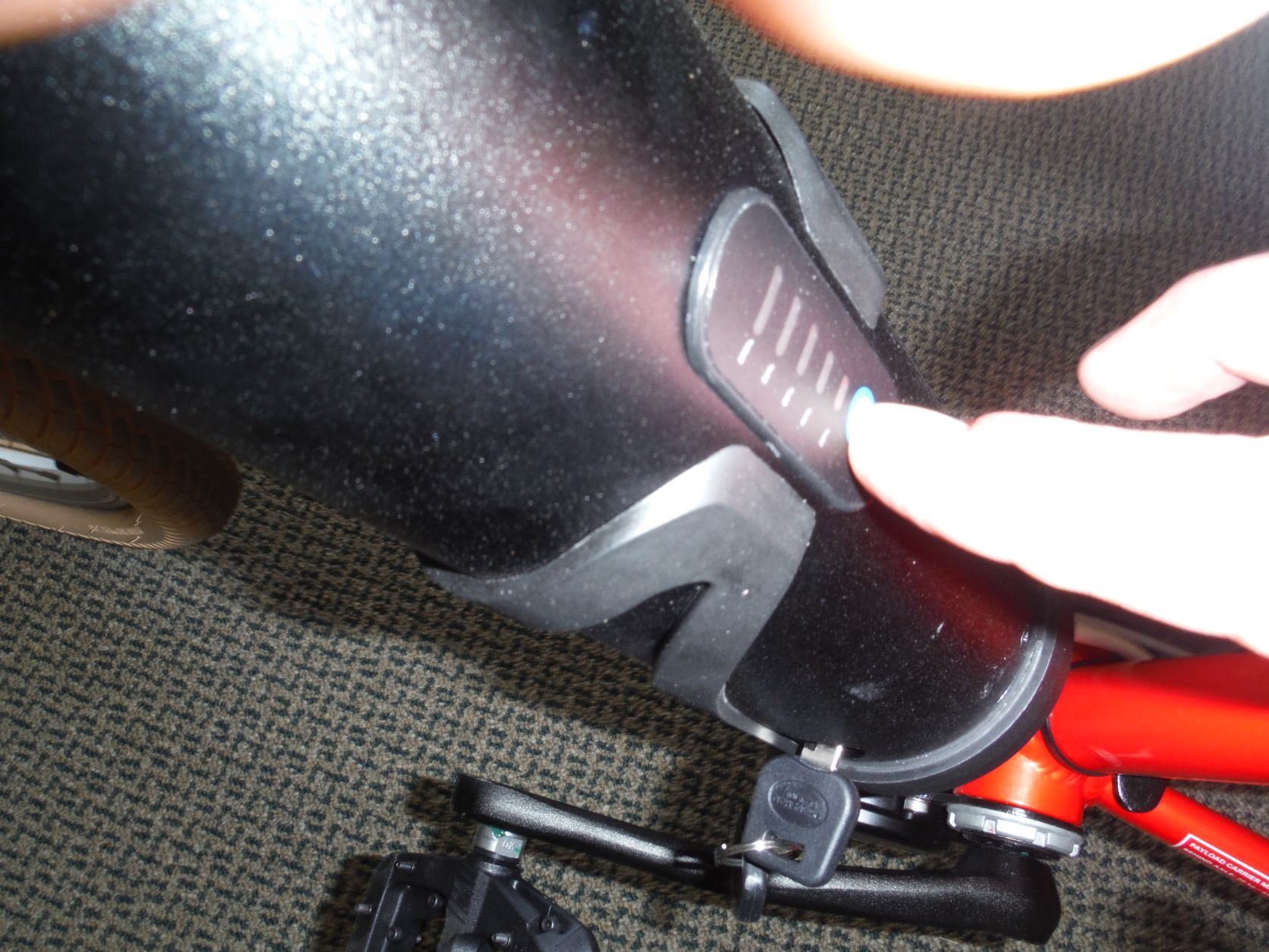

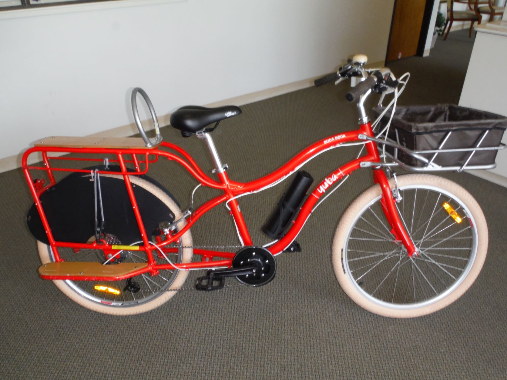

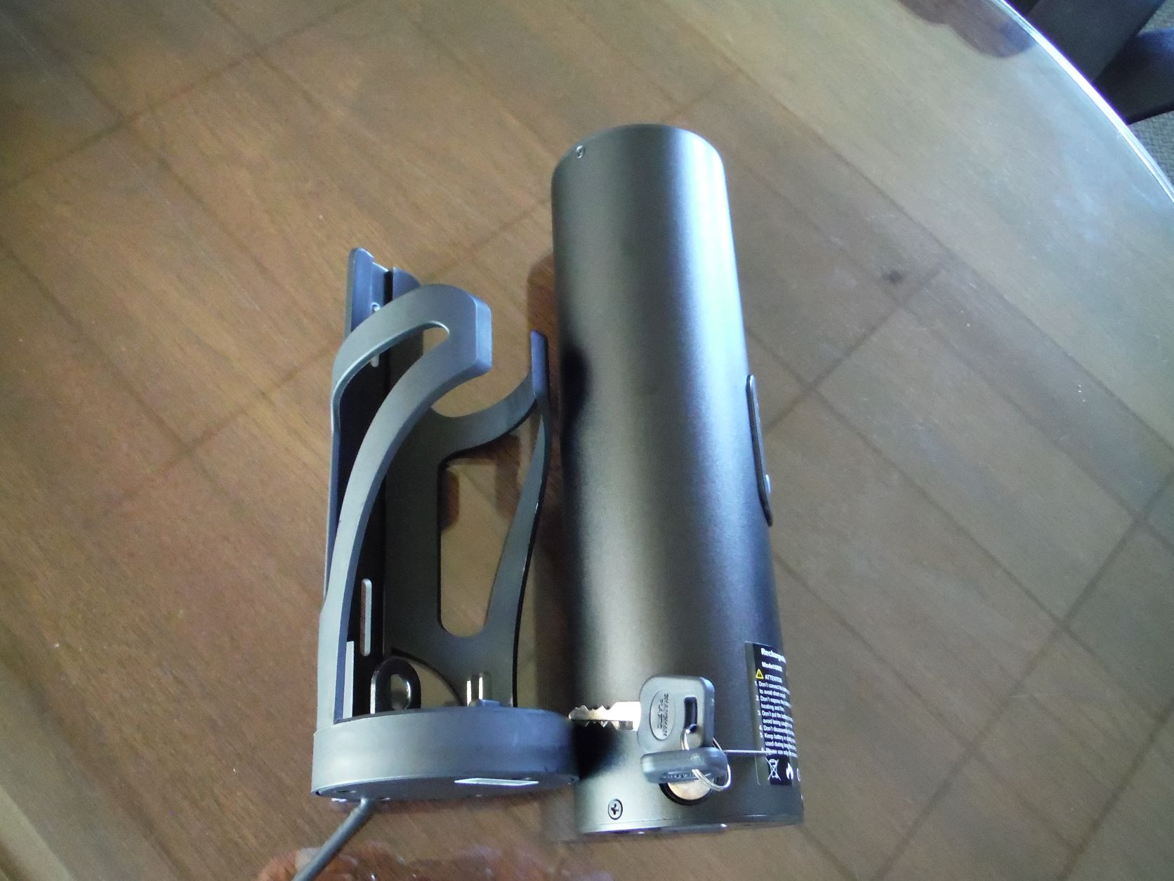

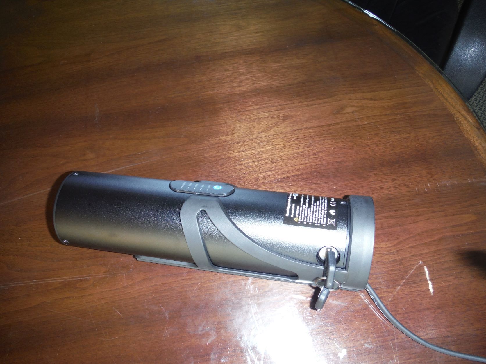

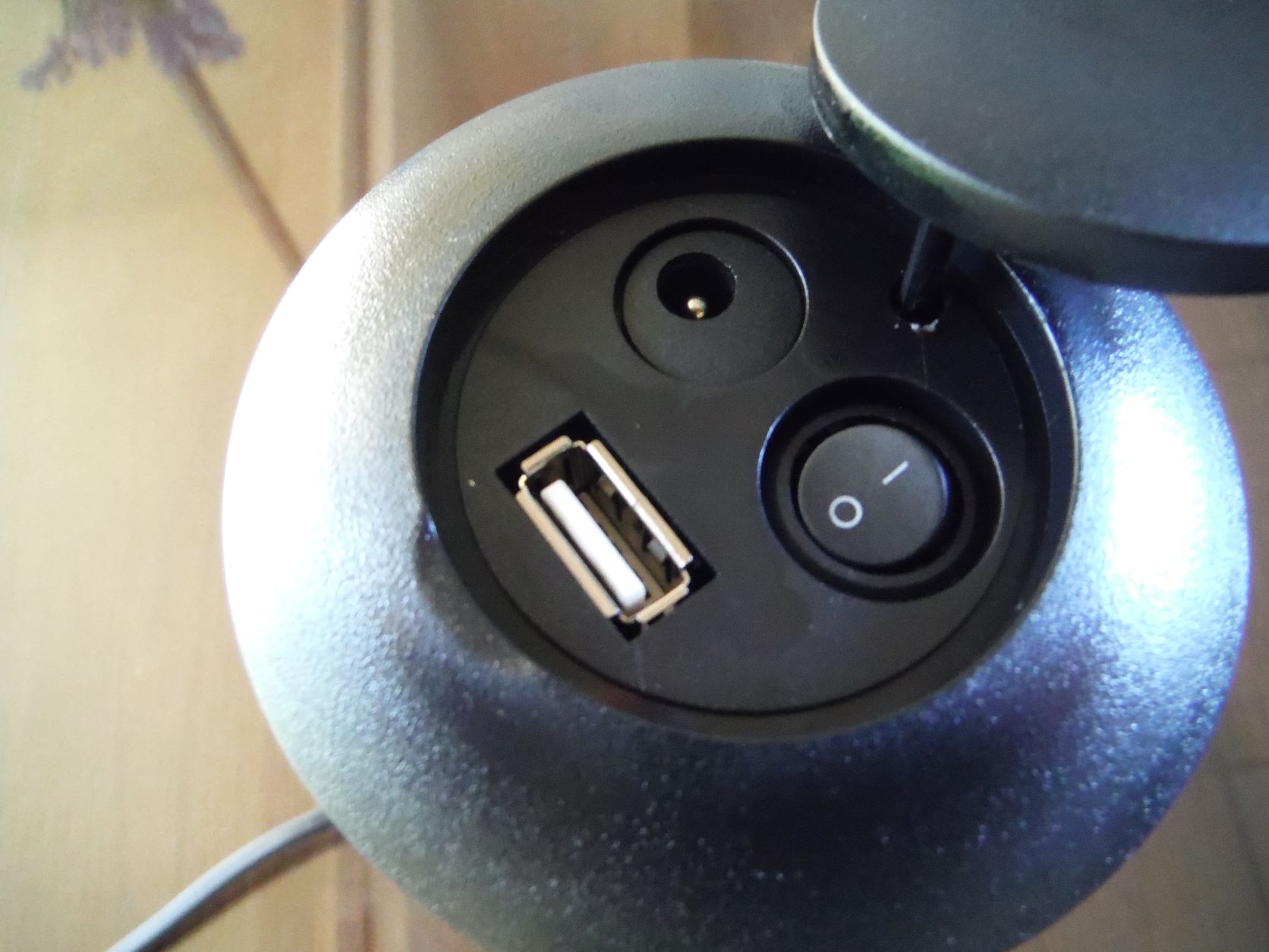

This is what a 48V battery looks like. You just bring it upstairs to charge it.
