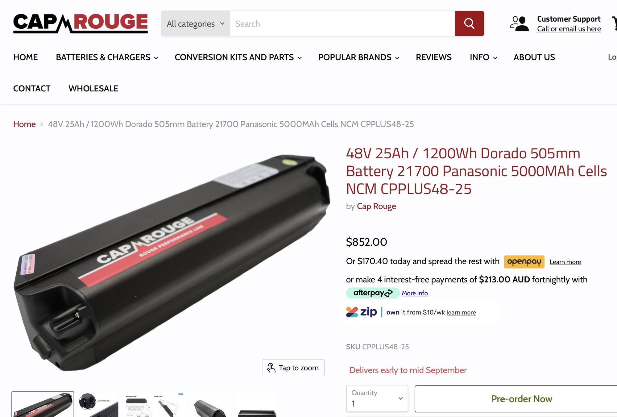

Thanks for the great idea I’ve just purchased the Ortlieb Toptube frame pack to hopefully do the same thing. It’s a little more expensive than your beer bag but looks the job. I’ll need to invert this bag as well to sit on top of the horizontal bar as i have the same problem it won’t fit hanging down because of the existing mounted tube battery. I need to carry another battery efficiently as my bafang ultra is hungry for power, with an extra battery ill be able to get much more full potential out of my bike, using full power more often. Caprouge in Australia are releasing a 25amp dorado battery that fits my bike, that’s an awesome size battery, I’ll be pre ordering this for sure. Will keep you posted how it all works out. See my bike review as well https://electricbikereview.com/forums/threads/volition-bikes-in-sydney.40497/#post-383143

Thanks and you…..yes I’m hoping this will work and the bag won’t want to flip, as you can see the battery I propose carrying is quite large, I think it will work, it’s an elegant solution, the other option for me is to place it in my rear bags, but I’ve found that adds a lot of weight to the rear of your bike or in a bike trailer, which riding with a trailer can have its challenges and limitations, then there’s actually mounting a second battery running concurrently or on a switch, this also has its challenges finding a suitable position and looks messy with extra wiring etc hopefully battery technology will keep increasing with more battery power in less space, as of course it will, but we’re not there yet. This 25amp battery is a big step in that direction.

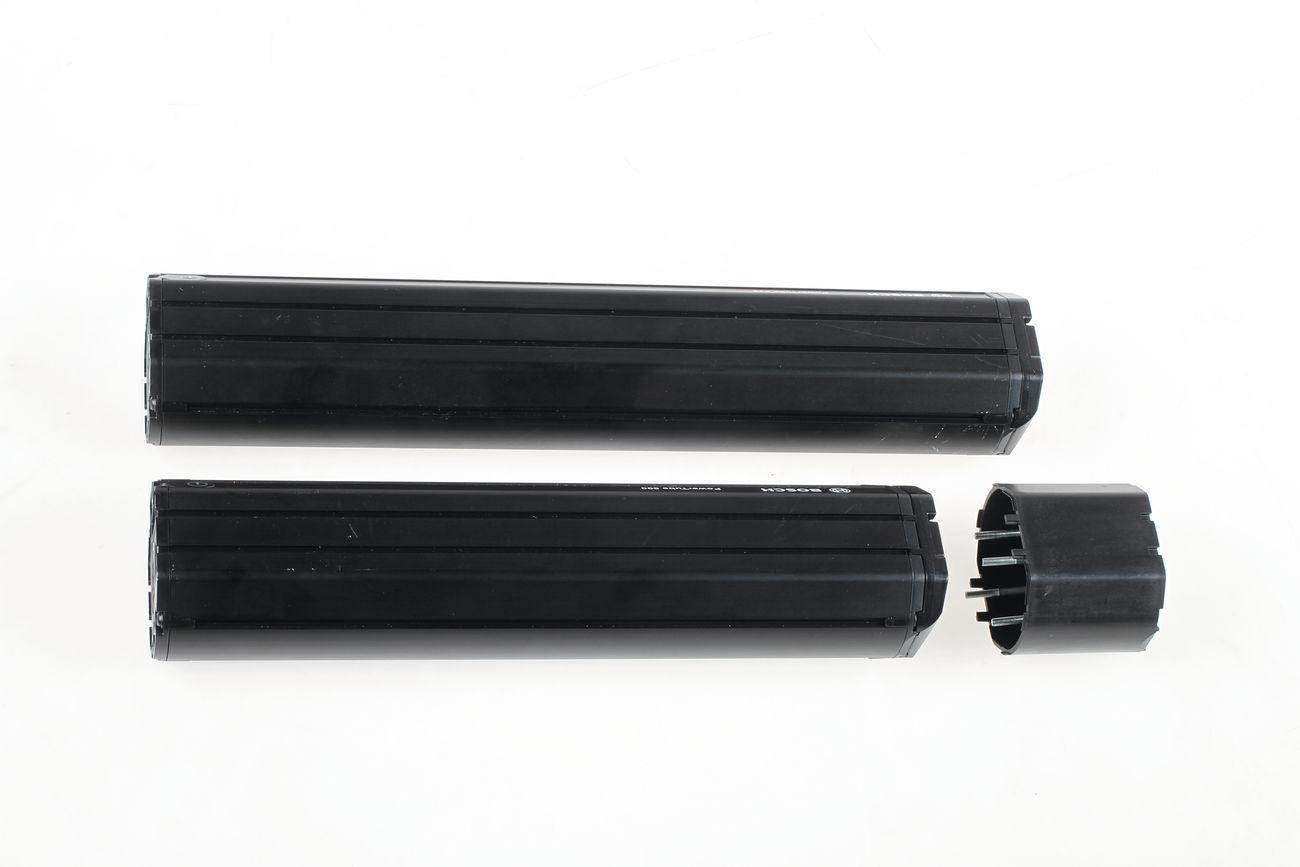

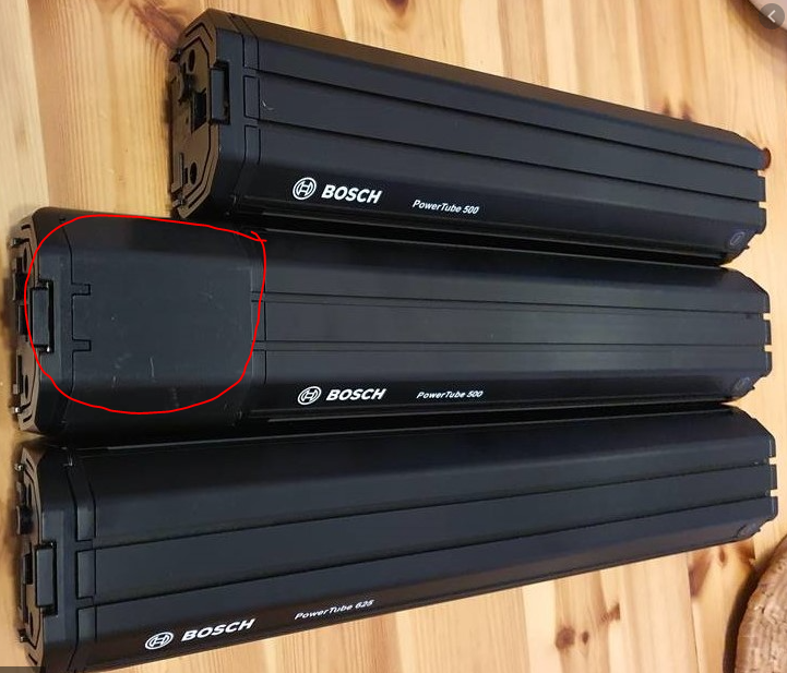

I don't think so. PT625 needs 16.5" of space and looks like the medium size bag is 15" in length.
PT400 and PT500 are same size in length but the PT625 is longer. Looks like the bag also comes in 20" size and that should hold PT625 easily.
It does indeed fit the 625 as it is exactly the same length as the 500 with the spacer, both of which fit the Allant+7 RIB battery compartment. The Stasher bag is the largest size which does hold that battery once the inner foam insulation is carefully (and surgically) removed.
