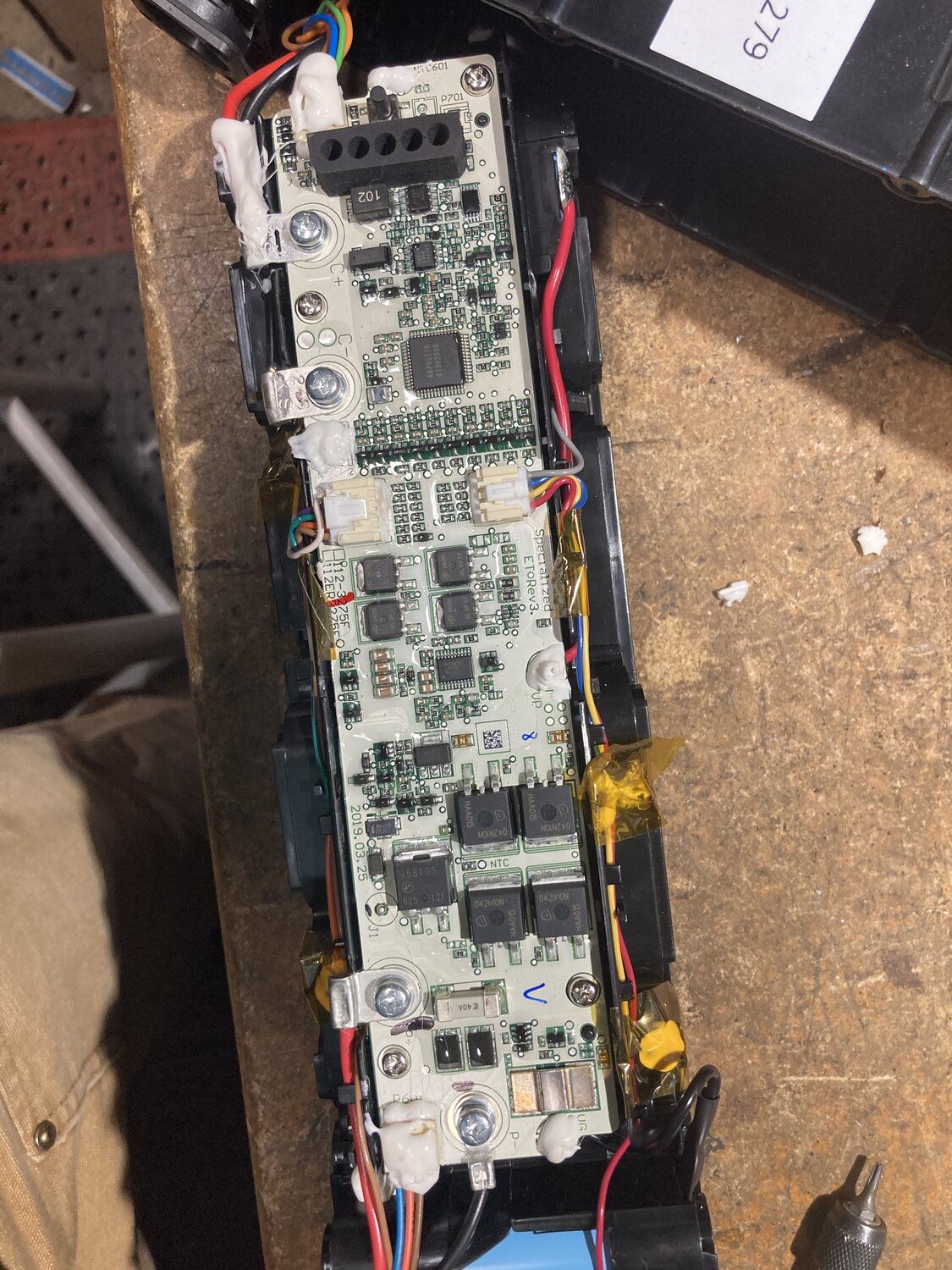

Hi guys and girls. It happened, a short circuit. And my battery stopped conducting electricity for the bike. The motherboard is in a coma. Can someone tell me where to look. A programmer for exciting the supply of electricity.
