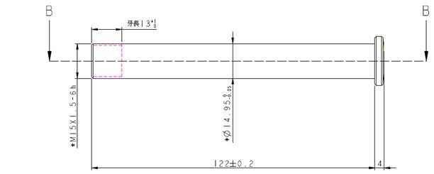

Oooooookay, Giant Australia has been absolutely useless at ordering me a spare thru axle. However I got somewhere via email with RST in Taiwan. I now have dimensions for my Vivair E thru bolt - see image below. I hope I'm interpreting that correctly as: M15 x 1.5 x 122. I'm not sure of the thread pitch but guessing 1.5.
Robert Axle has a M15 x 1.5 x 125 (https://www.abbotsfordcycles.com.au/lightning-bolt-on-axle-front-15mm-m15-x-15-125mm_p4467). Will that fit?
The Robert Axle Project has great customer service, esp when you have a drawing of what you need! I suggest you send that to them and ask them to match it.

You're right, their customer service is exceptional! I have the nearest size on order. It's a few mm longer than my current bolt but we'll see how we go.
