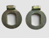

You should have a torque washer on both sides of the axle between the frame like these:

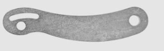

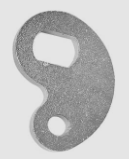

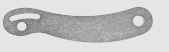

If your ebike is similar to the Ariel X you will also have some form of torque arm or torque clip that goes over the axle post and has a nub or bolt hole that fits in to a hole on the frame. That goes on under the axle bolt.
That torque arm will look like one of these:
Those are what keeps your rear axle from coming off the frame when you apply power to the motor because that torque is very powerful.

Look at the pictures in the post above. Do you have a torque washer on both sides and do you have them facing the same direction with that raised piece at the top?
They have to face the same direction. The raised piece goes to the outside and that slides in to the fork slot.
If tour ebike is similar to the Ariel X you will also have some form of torque arm or torque clip that goes over the axle post and has a nub or bolt holethat fits in to a hole on the frame. That goes on under the axle bolt.
View attachment 133394 View attachment 133395

Those torque washers go next to the hub inside the frame.

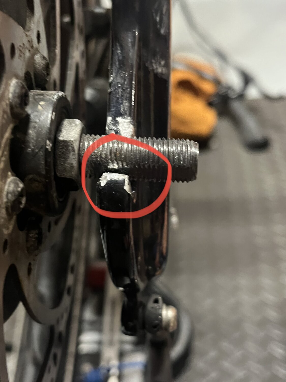

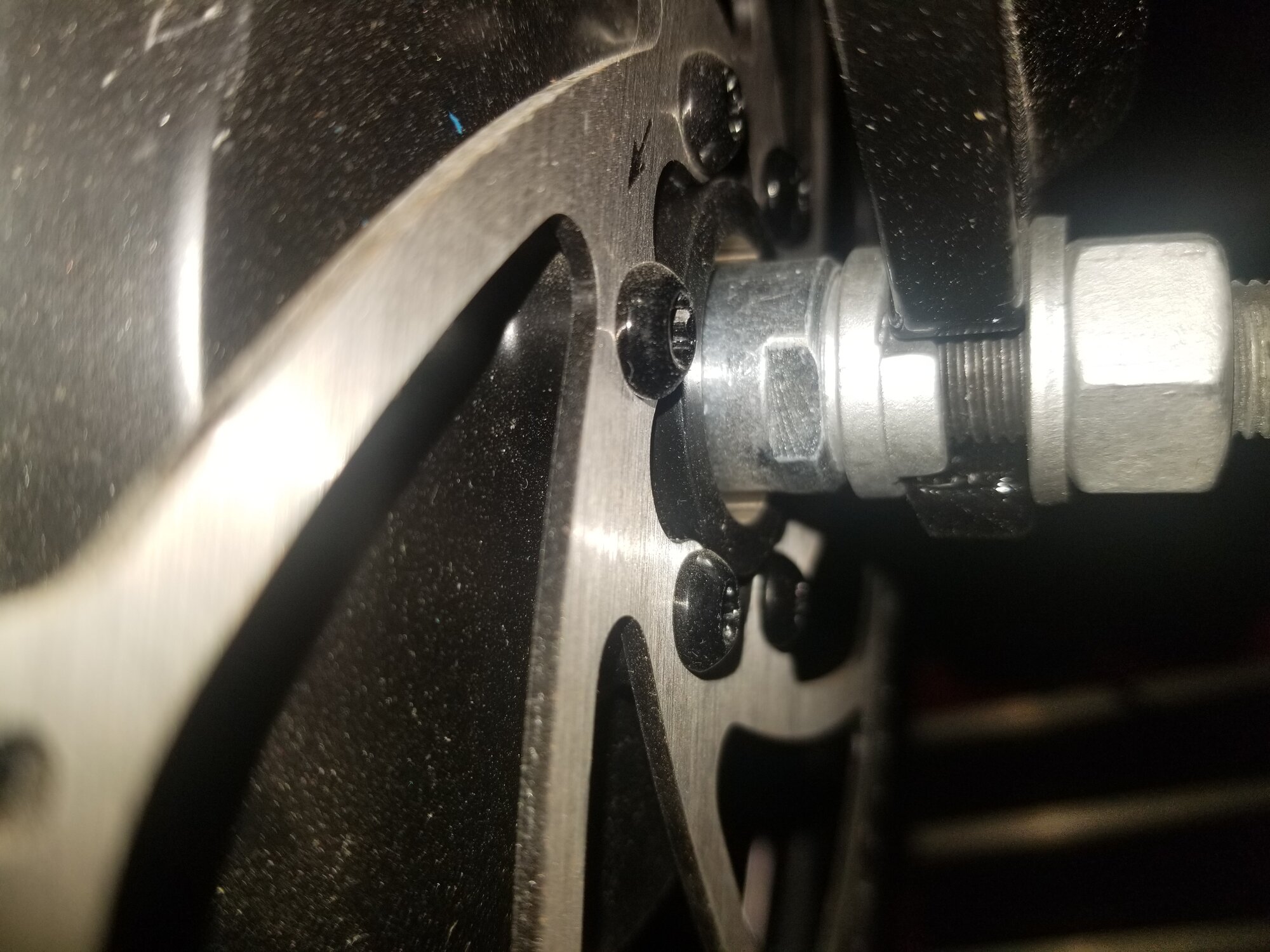

Thank you for everyones help. Last question. Is this broken ? Can this be the issue?
I have seen others over the years damage dropouts by riding without a torque washer. If you lost yours when you repaired a flat, it wouldn't be the first time I've seen that here either. From that angle, it's tough to determine. If the axle is completely seated in the dropout, then yes its damaged. Find a welder that does TIG welding. They can add material. I own a MIG welder and a MIG is not good enough.

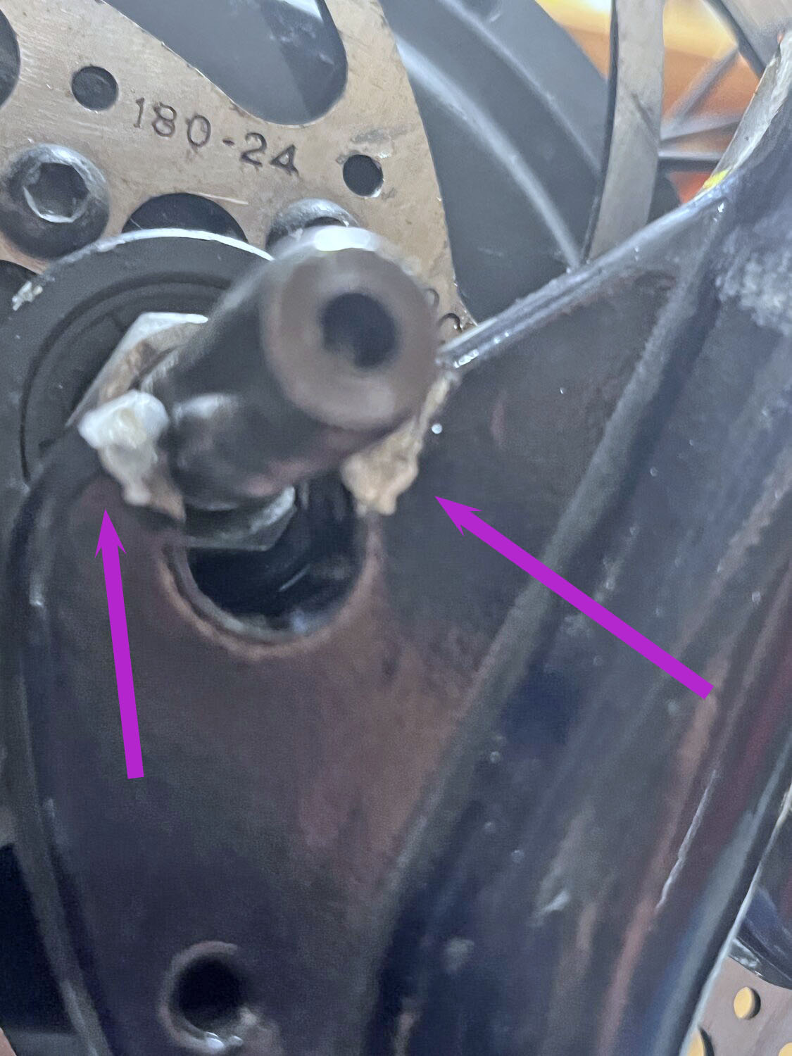

Your own picture shows it. The axle on the brake side isn't sitting in the bottom of the notch. You're also missing a prrtty thick washer. The torque washer is about 3/16" so that forces you to really squeeze the frame to get the axle but tight.
OK. Let's look at your picture. Yikes. If you tightened the nut like that, of course it's going to roll out. Yeah, you're about 8mm off the bottom. What are the arrows pointing at? Is that paper? Probably gouges in the frame.
I do not think it's too badly damaged. I have plenty of bikes which will look like yours when the axle is resting at the bottom. I'd like to see a picture of your frame without the wheel in it to really assess whether it's damaged. It's common in many ebikes to have some slop in the notch. Most aren't that powerful that they can overcome a 12mm nut torqued down to 25 ft-lbs.
Take the wheel out. If there are any burrs in the notch, smooth them down. Axle should slide in. People like me will spin a nut onto the axle and tap on it with a hammer to seat the axle.
If you have to get to work on Monday, you'll never get a torque washer in time from amazon. Is there one on the other side?
If you got some 12mm washers from the hardware store and placed them between the wheel and frame so there's no slack. , when you tighten the axle nut, most of the force will be holding the axle tight instead of trying to squeeze the frame. I think It would hold for a while, but the safe thing is to order a torque washer, and perhaps even go the the extreme of a secondary torque arm.

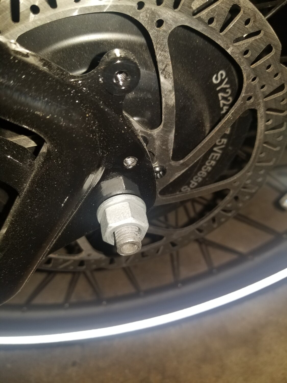

Any luck? If you can't get the axle to seat all the way check if there are any burs in the axle slot blocking it. If there are, use a file to smooth them out. Once you can get the axle seated all the way in the dropout, put the tabbed washers on with the tabs facing away from the hub, then the flat washer, then the nut. The tabbed washers should look like the pic below when in proper position. I'm surprised noone has made a torque arm that picks up the M5 fender mount hole on the dropout(hole just above the axle nut in the second pic).
