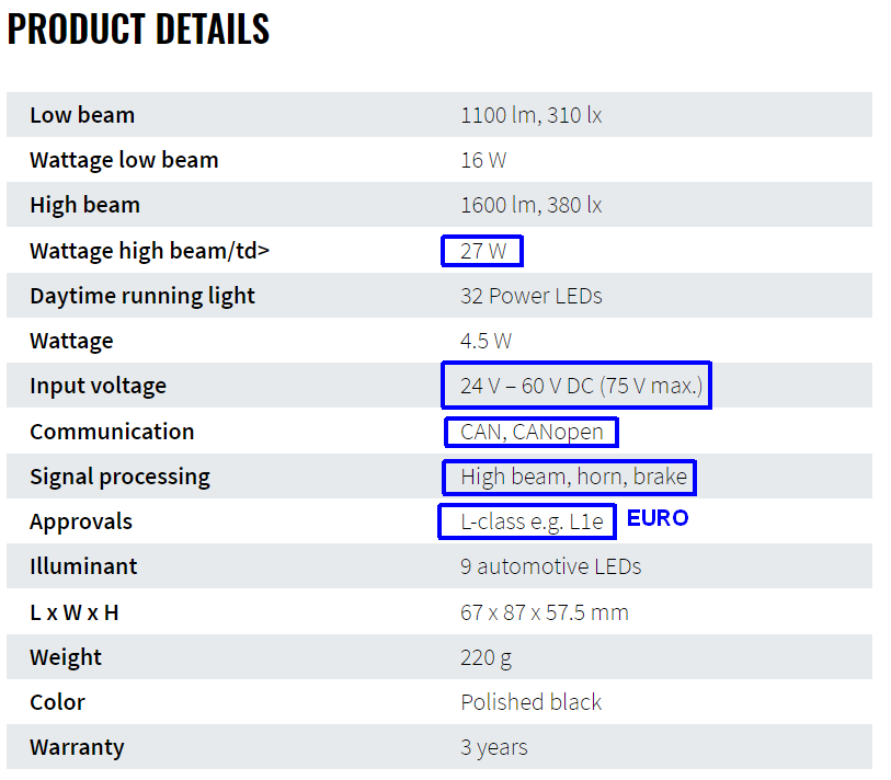

@Camasonian: Ask your LBS about applicability of installing the Supernova M99 Pro for your new Vado 5.0. The matter is not simple, as that light uses a remote for high-beam. Your 5.0 might be not electronically/electrically prepared to deliver 27 W of power at 24 V for the high-beam. (Supernova is indeed a CAN Bus device, so it needs to communicate with the e-bike for high-beam, horn, and brakes). If you do it wrong, you might damage electronics in your Vado, leading to voiding your warranty.
My Vado (which is a special EU issue known as 6.0) has been specifically designed for Supernova M99 Pro. That light is the standard issue on the 6.0, and the high-beam switch is integrated with the Vado remote (the bottom thumb button serves this purpose). The new Vado 5.0 handles traditional 12 V headlights.

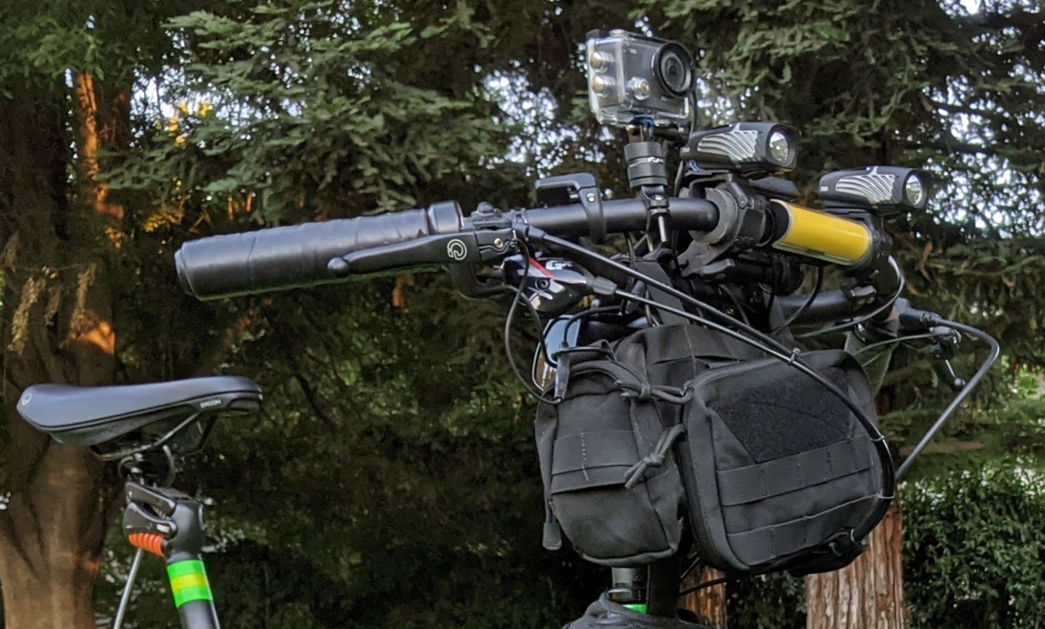

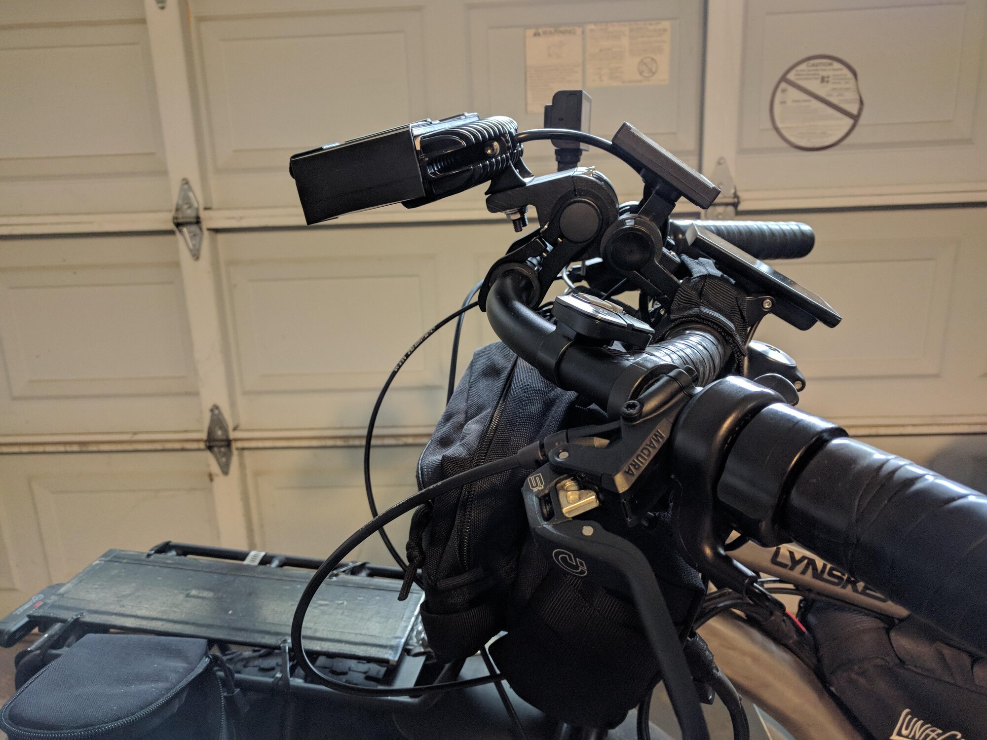

Recently I graduated up to Knog lights, which are the brightest I can find - but they cost. Two Knog square-type Blinders are my solids. A Big Cobber set to eco mode is my blinker. Its a sharp, intense regular blink. Note the Knog Blinder checkerboard version has a mode that is a form of an irregular blink that studies have shown are more noticeable than a regular blink. The excellent Bontrager Flare RT has an irregular blink built into it as well and I have one of those on a different bike. At US$65 it too is pricey but a hospital visit costs more.

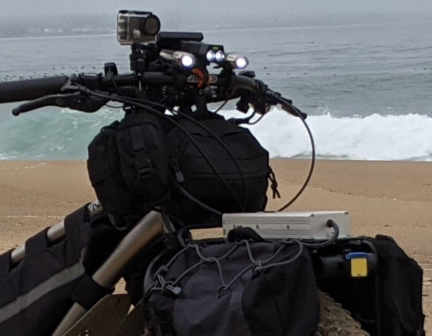

On the front of the same bike, I use two Niterider Luminas, set far enough apart and with their mounts 1 click outboard to spread their beams just a tad (without separating them). Thats a good wide beam for the street. In between them is a white flashing Big Cobber set to eyesaver mode (shuts off the top 1/3 of the beam so it doesn't blink in your face). The Big Cobber is the only brand of blinkie that is powerful enough not to get drowned out by two steady lights set just beside it.
On a different bike that sees more use in rural areas, I do the same thing in back, but in the front I use my sort of new favorite economy beam. Branded by Victagen but sold under multiple names. Like the Niteriders it is also detachable for use as a hand light and has so much capacity it can be used as a power bank for your cell phone (a USB plug is included on it). Niteriders are fantastic but expensive. It is flanked by two $15 Blitzu Gator 390's that are also set one click outboard. They're cheap, bright with good beam patterns and the battery is decently long lasting when set to its low value (which is plenty when used as a supplement like this). As such, I have one good bright beam forming the point of a spear, and two more beams widening out my field of vision - this kind of flexibility is why I no longer bother to try and solve a lighting need with just one unit. This is a $50 total solution.
also, look down in the lower right corner. Thats where the blinkie goes, separated from the main beams so it doesn't get drowned out. A Knog Blinder again. Set to eco mode which is a sharp, short flash.

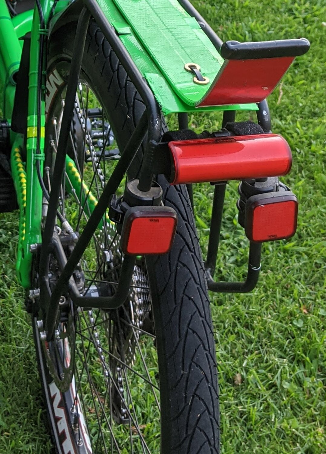

Lastly, on a bike with basket bars, I used two of the double beams, one on each side of the rack. You can see a centered white blinkie. This is a Night Provision front light that is set to blink. These lights are CHEAP and really bright. The battery lasts a full week of use so I used them regularly on a commuter. I have maybe a dozen sets and I relied on these for years before I recently decided to step up to the Knogs. the rears are sold in twos and I put one on each side of my rack, oriented up-and-down, just like you see the square Knogs in the pic above. Another one oriented side to side is the blinkie in the back, center. In a pinch, these are the best budget daybright running/tail lights I have ever come across.
Look closely and you can see two widely-spaced unused mounts I fashioned on the top bar of the rack. Also there are two of the Gator mounts in the center just above the blinkie. the outboard mounts are just there unused, but the two in the middle I can use if riding in the boondocks to give me a nice spread-out illumination pattern. For $30.

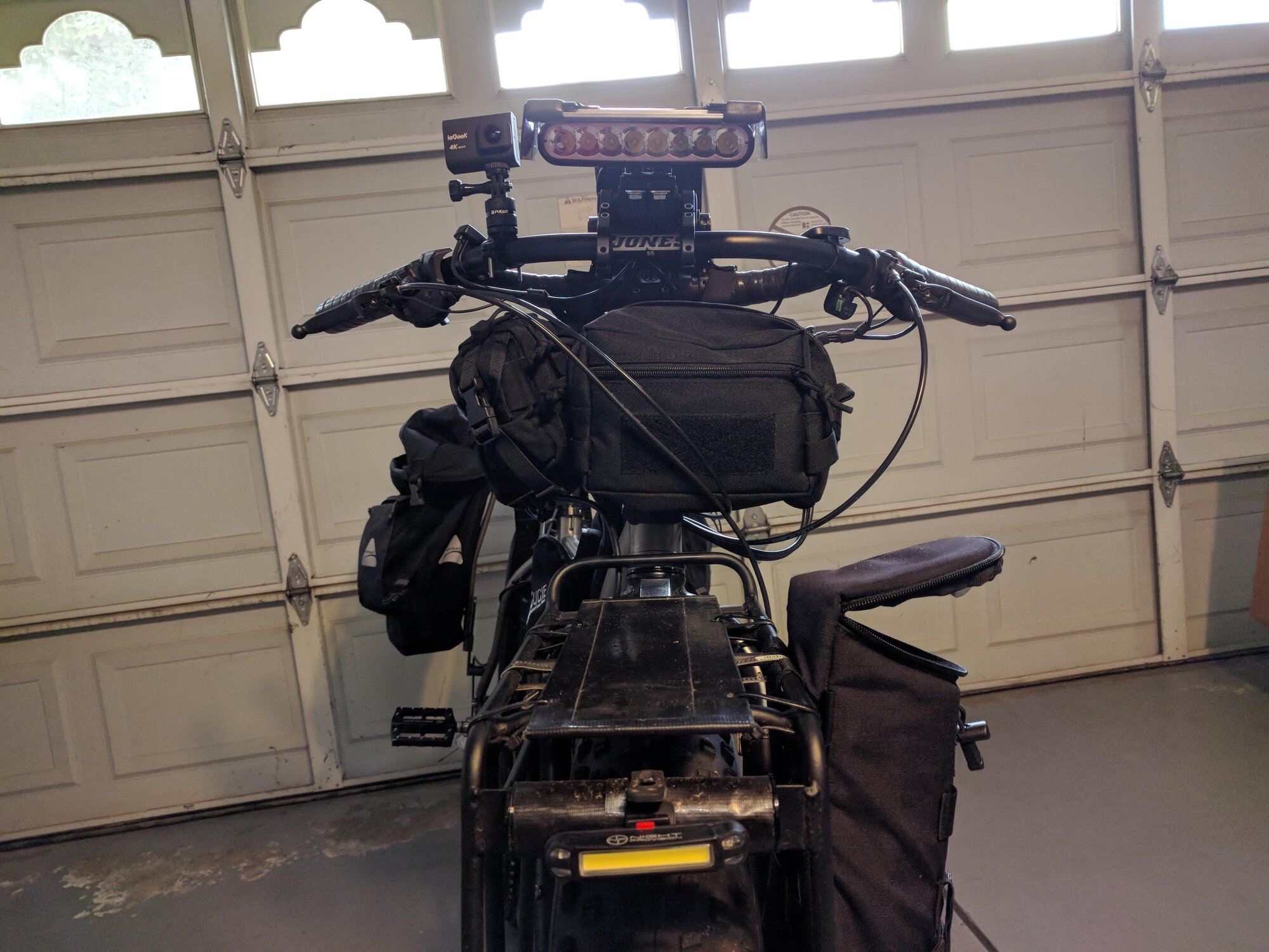

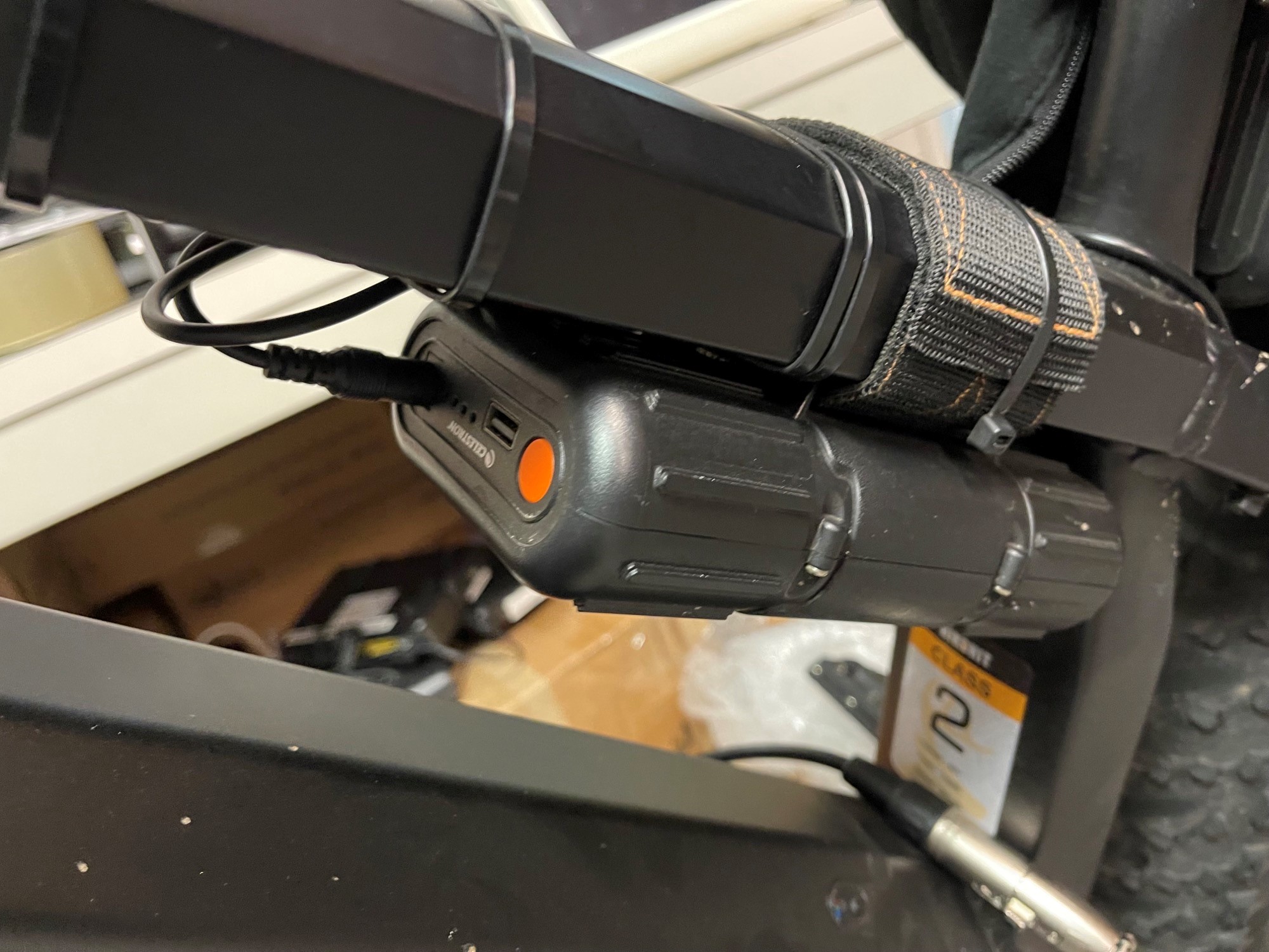

12v power supply and any 12v light you want. I use a Jeep 7" off-road LED light bar, have tried some motorcycle driving lights as well, like the output and aesthetics of the bar better.
12v power packs: this one lasts me 8-9 hours with the below light.
mine: https://www.amazon.com/gp/product/B07VX3S4M2/ref=ppx_yo_dt_b_search_asin_title?ie=UTF8&psc=1
light bar:

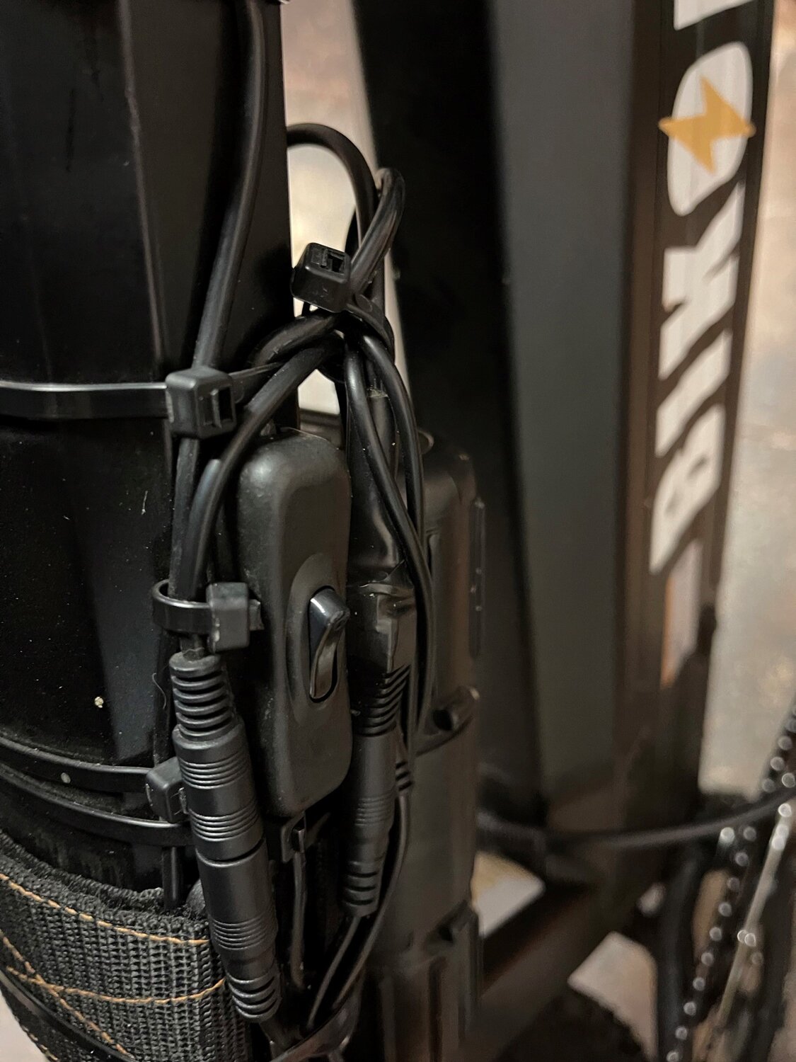

switches:
DC port and wiring: from led bar to power pack

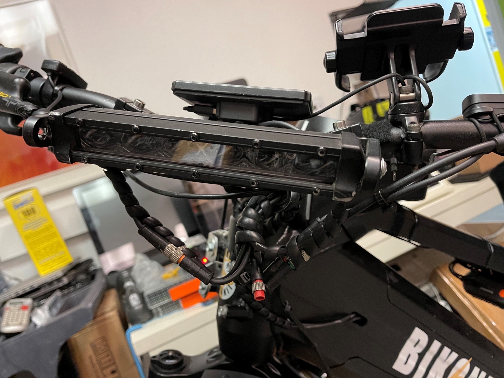

Speaking of light bars, here's one that will work directly off of your ebike battery with no messing around with any separate batteries. Input voltage range is 9-60v DC so I had it plugged directly into my 52v main battery via a simple Y plug terminating to an XT60, with a basic inline switch. This is the light I was talking about above when I said I worked out using small 52v batteries for an external lighting setup. I ended up just feeding off the main battery and dropping the use of an external since there was no need and the light didn't eat much.
The problem with those light bars is they have no cutoff. So they're illegal on the street for good reason as they blast light forward smack into oncoming drivers' eyeballs. Local cops will be more than happy to pull your ass over for using one without a cutoff of some kind. They sure weren't shy with me. You need a cutoff just like a legal headlight. Which I created with some L brackets, a bit of aluminum flat bar stock and some tape, followed by focusing the light down enough so the 'cutoff' did its job. The bulb - even though its an LED - gave off too much heat to just tape over the top half of the lens. Tried that. Note the cooling fins on the casing they are there because they are needed.

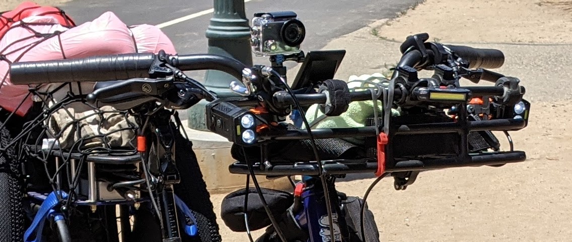

This kind of light is meant to be mounted on roll cages and such. I fashioned a mount out of a couple of them along with a handlebar extension, angled back so the weight of the whole assembly didn't cause it to tip forward. You can't over-emphasize how much a 40w LED light is overkill. Its fun for awhile but really I found I can get a better result with smaller lights suited to the intended purpose. Those 2-beam self-contained lights in particular are perhaps even more useful than this thing was.
I'm sure I could do a better job on the cutoff but I reached a point where the effort wasn't worth the potential gain and I moved on.

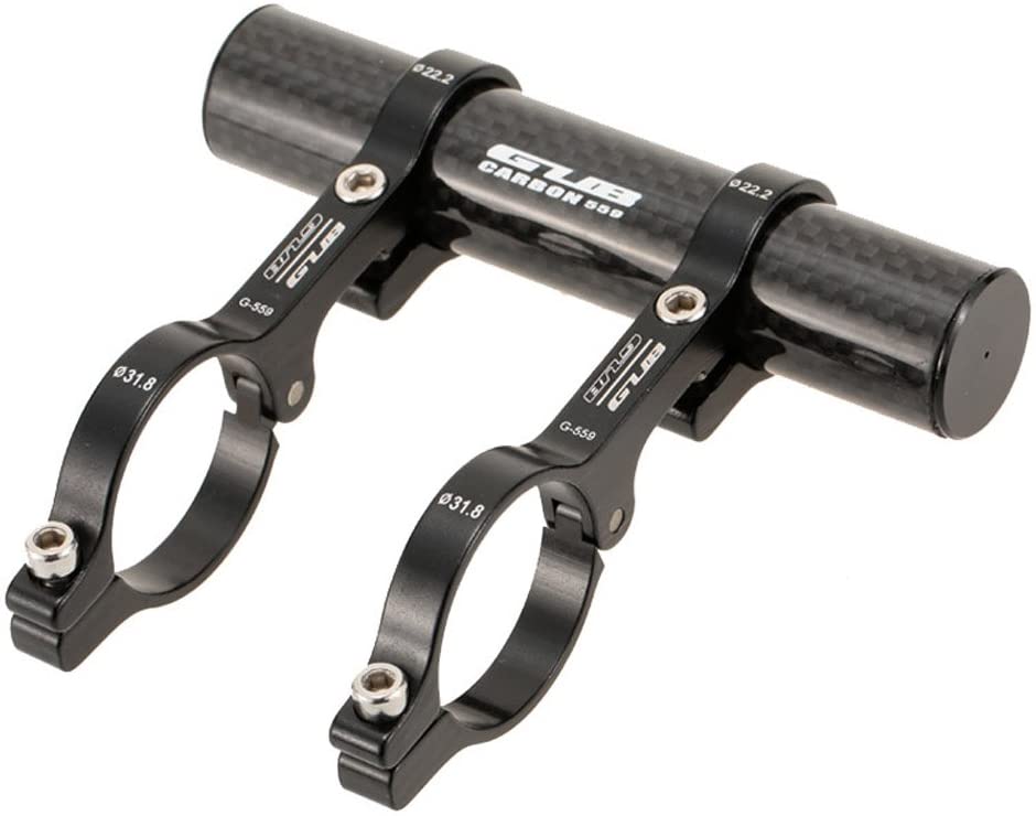

I used a short handlebar extension that looked like this, angled back. From the side it was maybe at 2 o'clock ... 1:30 ish? The rightmost pic, zoom in on it.
Then I took a pair of these bar mounts
Jammed them together side by side, the mount on the light is a big wide slot. Just barely wide enough so I could take those two mounts, jammed side by side, and slide two bolts thru, clamping the light to them both so I had a very wide base of contact both on the light and the bar. n Zoom in on the leftmost pic and you can see the two bolts just above the Jones label on the handlebars. I did need to use the rubber spacers to fill in for the handlebars being smaller but they were included with the bar mounts.
The assembly also braced itself against the separate handlebar extension that I used to mount my second display (2wd bike so dual displays, one per motor). If I had wanted to (and it needed it) I could have connected the two via zip ties as the light assembly was heavy so a good solid bump would move it forward some. Thats why I angled it back, which only solved about 90% of the problem.
It is also elevated like that above the bars on purpose as the higher up I could get it, the larger swath of pavement I could light up.
ok,, I tried those mounts, didn't work with my light.
I had the bar extender, didn't care for it. I found the brackets I posted above, they are ok. my OCD has me wanting something a little cleaner.

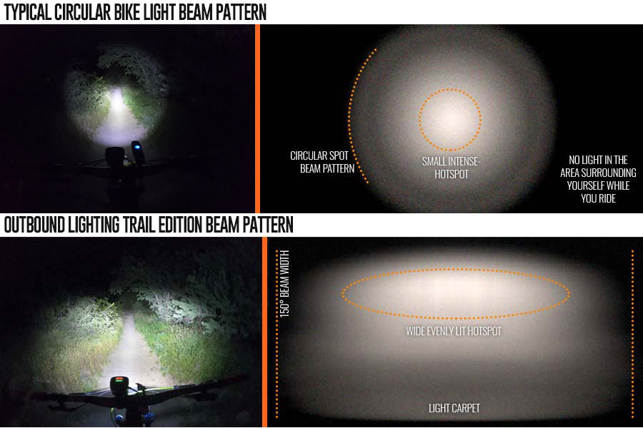

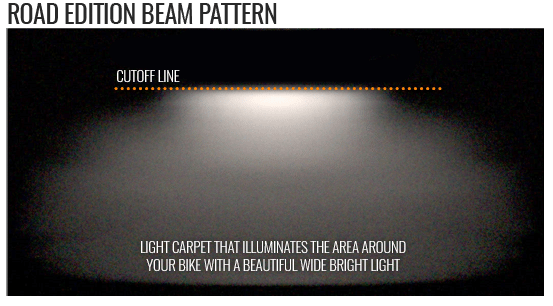

I have an Outbound Lighting Headlight for $175 which produces 1800 lumens and has a cutoff for the light like a car headlight, it also comes with a 3 year warranty and is a USA made product...it is easily mounted on handlebars.
The headlight is super bright and I can see debris on the road even without streetlights in rural areas, I've had the headlight for about a year now and its still going as bright as the day I got it. The Outbound Lighting headlight has an external battery pack that is easily mounted on bike frames...also its a decent sized capacity battery pack that can be used on high mode for around 3-4 hours.
Cutoff points for our headlights are necessary to not blind people. It seems its all in the lens technology they put into the lights themselves.
The company Outbound Lighting I got my headlights from made a great point of this...
