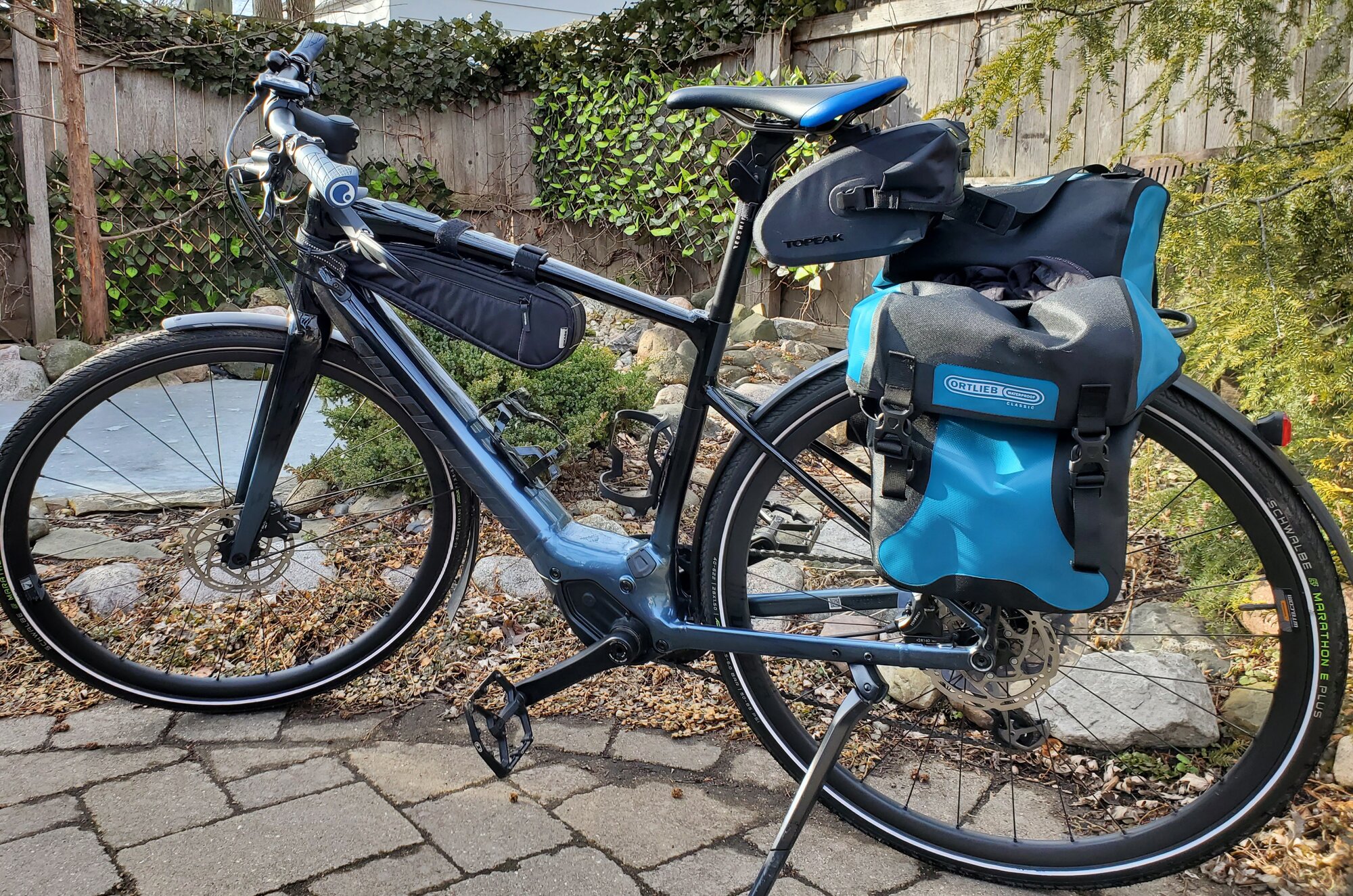

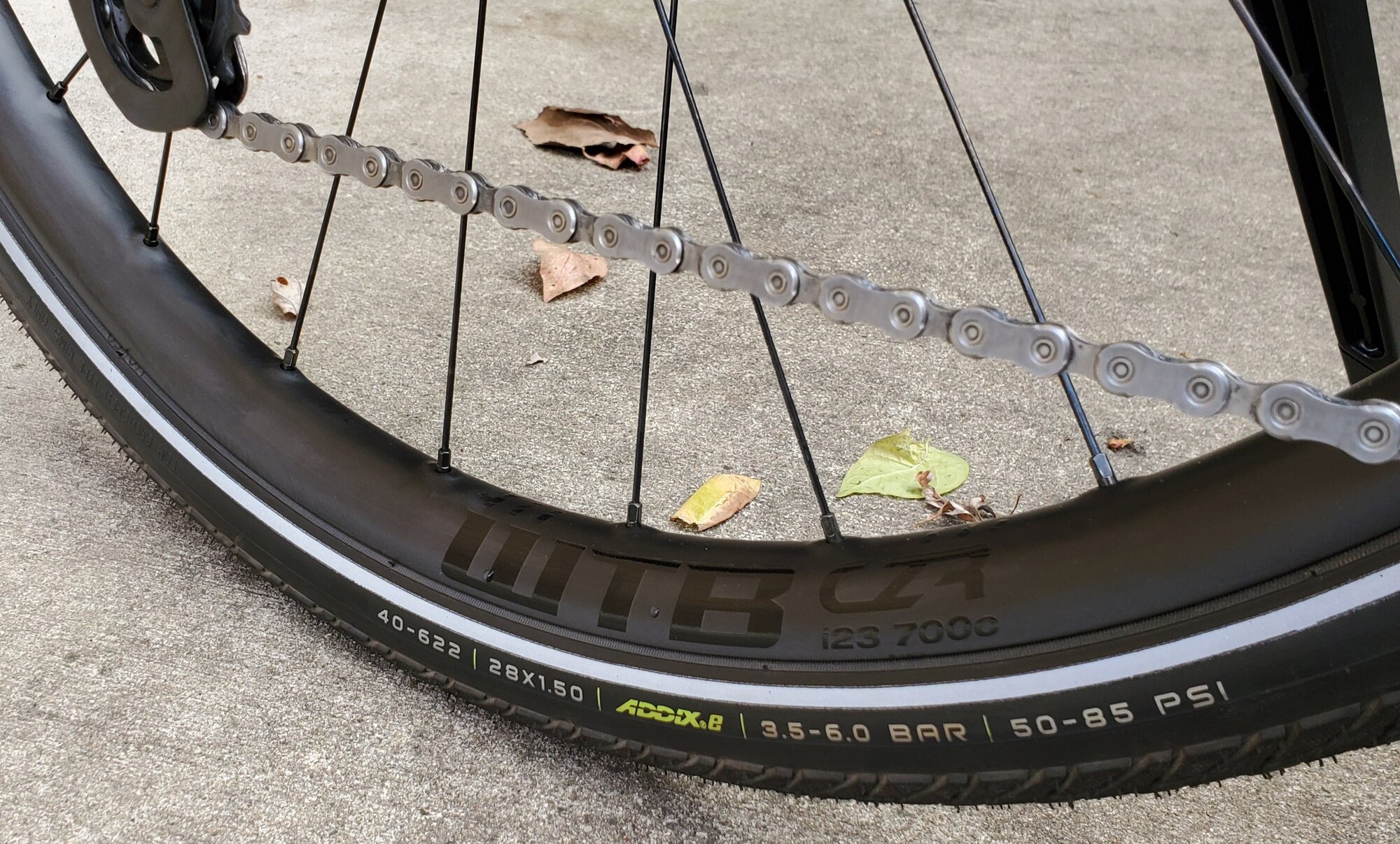

I don't have the step through but I did put carbon rims on my 5.0 EQ. And I'd do it again. That, combined with all the other mods I made, have made it one awesome commuter bike.

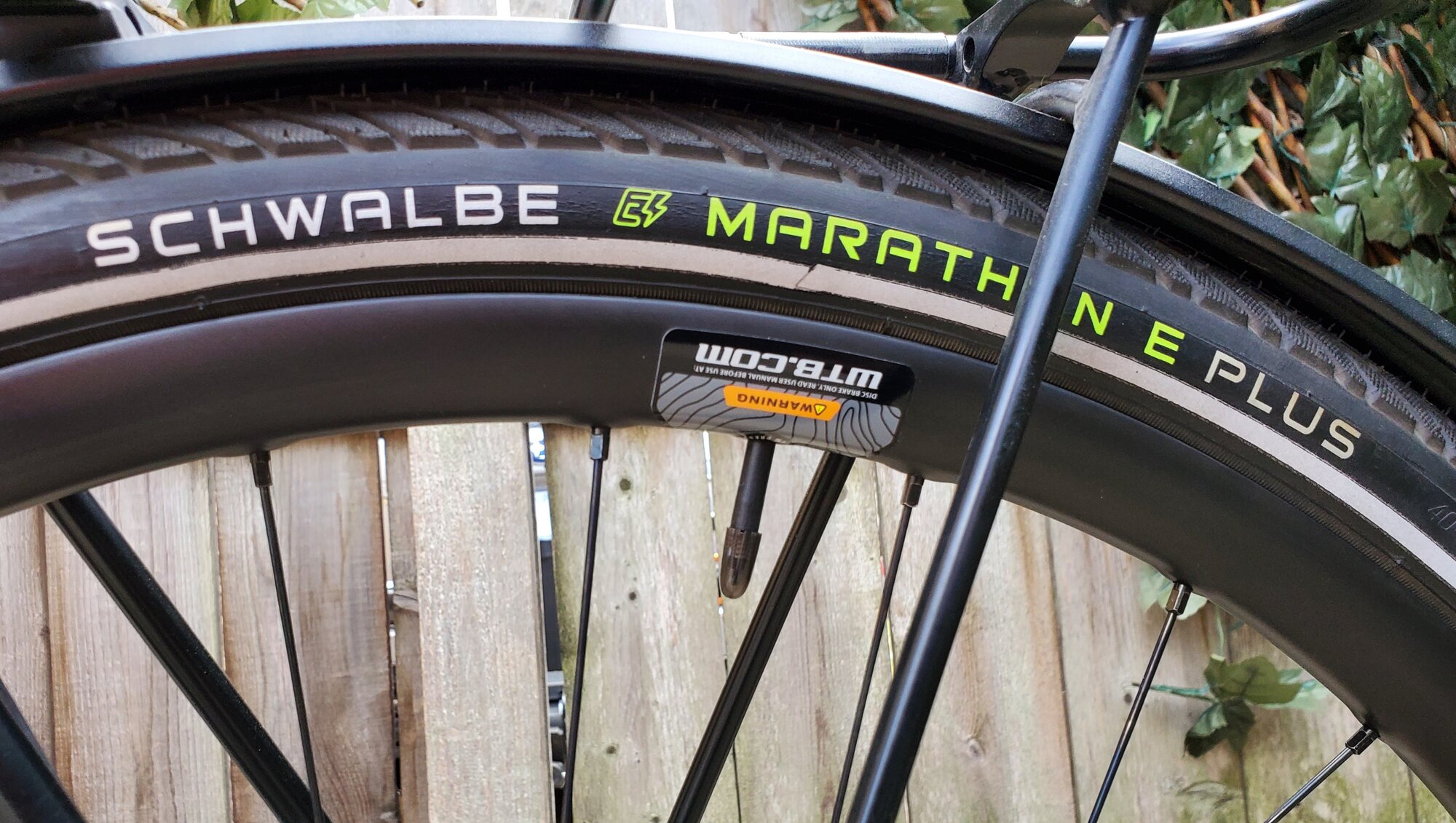

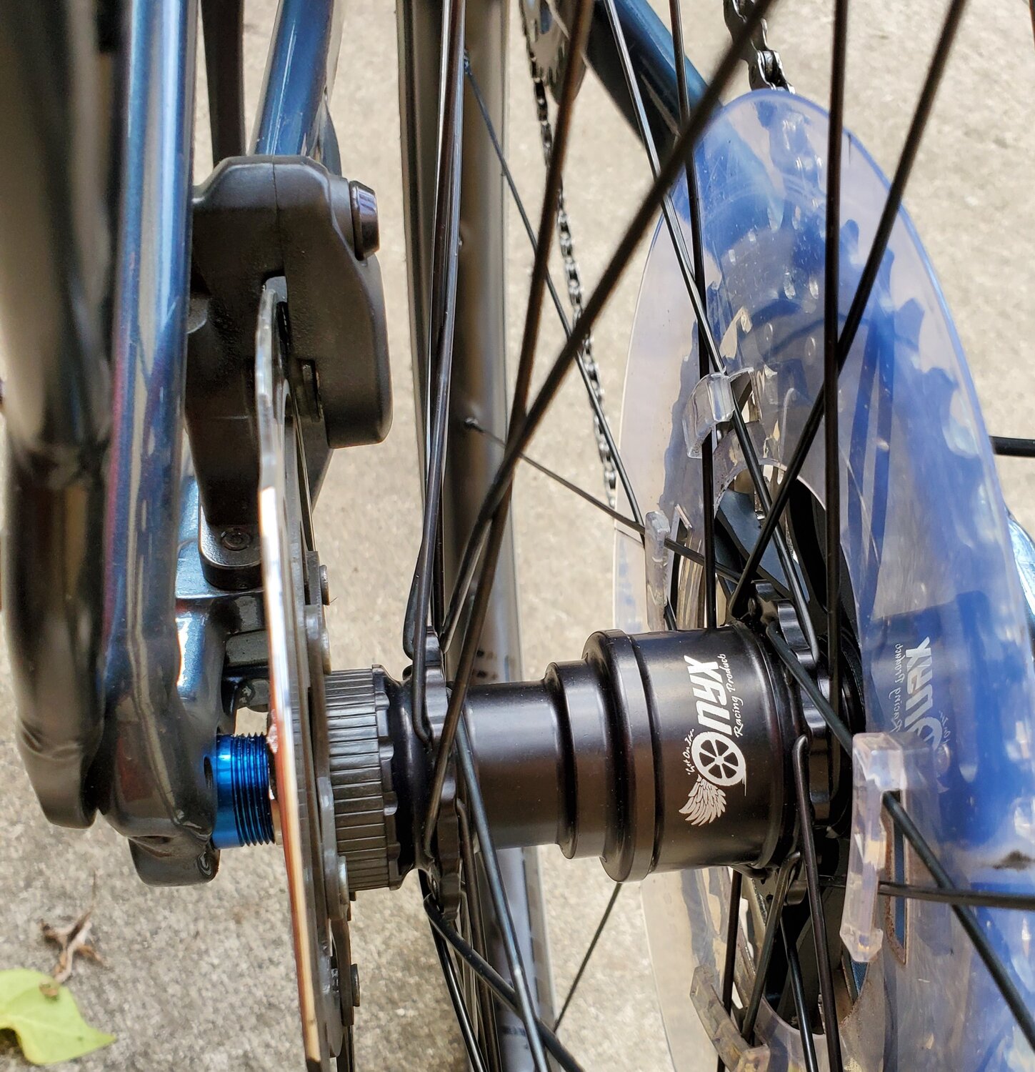

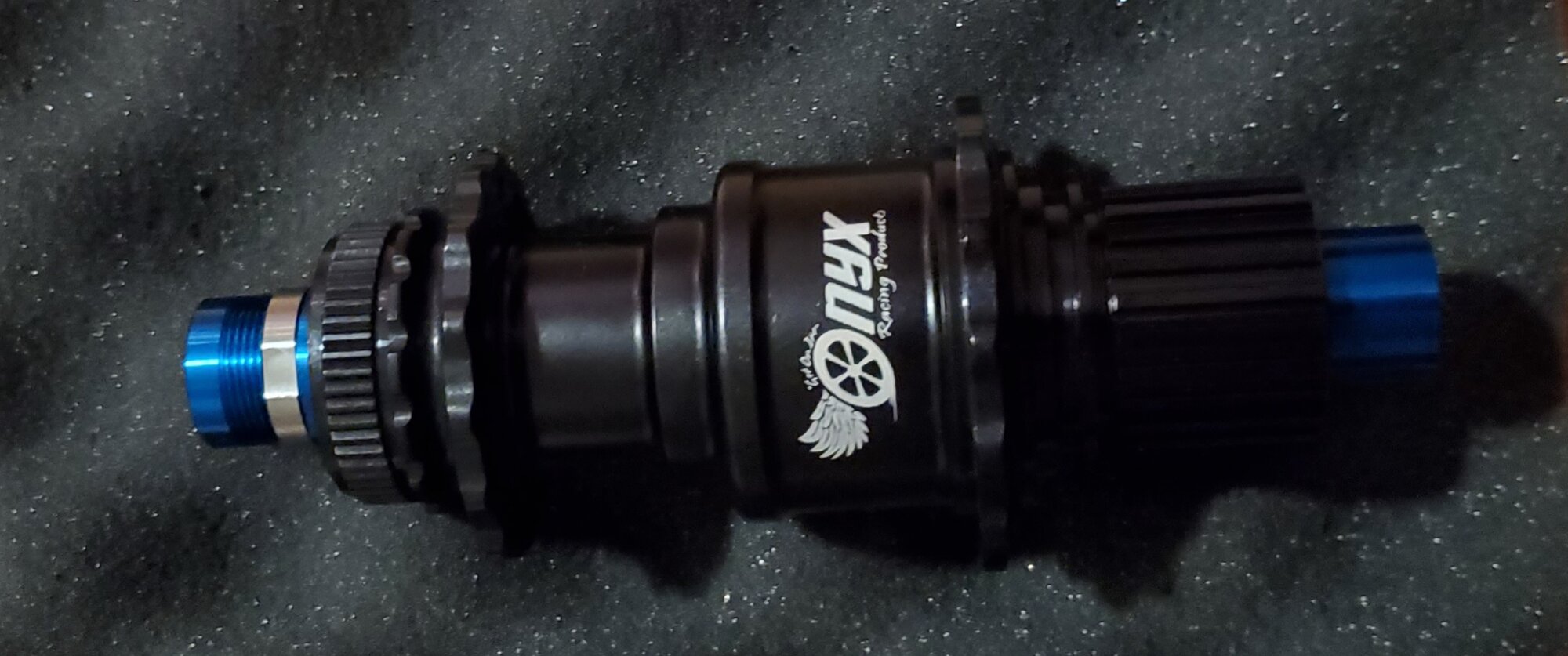

Here's what I went with:
Rims: WTB CZR i23 28 hole, WTB CZR i23 24-hole (total cost about $1150)
Rear Hub: Onyx Vesper MTB Boost CL MS 148/12 Thru-bolt rear hub (#102702), Vesper hub shell (#102702-099848-S-28-ano-bkm-101799), spoke count 28 black matte, hub widgets anodized blue (blue/black hub matched bike paint scheme) - total cost about $500
Tires: Schwalbe Marathon E-Plus; these are great on gravel and mixed surface; heavier than stock Specialized tires weight partially offset with lighter tubes
Tubes: Schwalbe Aerothan
Note: Onyx does not advertise the Vesper as e-bike rated but given the light-assist and low-torque nature of the Vado SL, we thought it a good choice. Been wonderful so far.
Front hub we re-used the stock hub
Also swapped out drivetrain to SRAM AXS.
Also added Salsa Rustler handlebar, Ergon grips/saddle, Redshift seatpost.
My bike shop mechanic is a bike-genius. He did a great job of building the wheelset.
My goals with all upgrades were 1) ride quality/comfort, 2) performance, 3) reliability (ie quality components such as flatless Schwalbe tires, Onyx hub ...)

I'm also considering the Vesper hub. Using a sprag clutch instead of pawls or ratchets makes it totally silent. I'm not sure why I'm so focused on a silent freewheel, but there it is. Of course, they don't come cheap and I'll probably go with a different front hub. Compared to the rear, it seems like these are almost a commodity component unless you're a real weight weenie (and a weight weenie would not be on an e-bike in the first place).
As for @mfgrep ' post above, I had an experienced rider berate me the other day for taking mine off, telling me stories about disastrous chain jams, etc. Considering that I'm now 76 and have never dropped a chain off the inside of a cassette, I'm not going to put it back on, but did think about it for a while.
